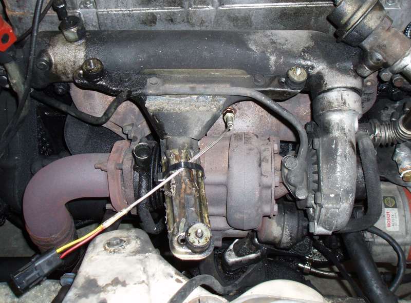

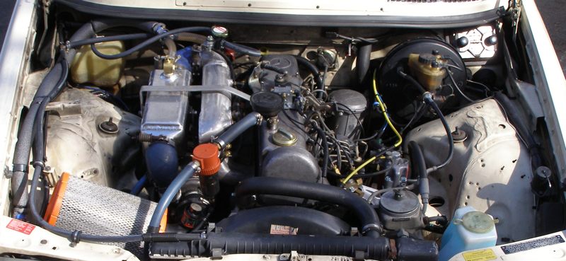

Turbocharger- Garrett GT2256V VNT from a 2003 Dodge Sprinter with a 3-stage mechanical boost controller (7-28-09), 16psi
Intake- Modified W115 300D manifold with Air to Water intercooler (9-16-09)
Air filtration- Fram 8037
Exhaust- Stock downpipe with a shorty mid-exit pipe
Injection- M-Pump (5.5mm elements, 6-30-09), 265 nozzles set to 140bar (3-18-09)
Engine Oil- Mobil1 15W-50 synthetic

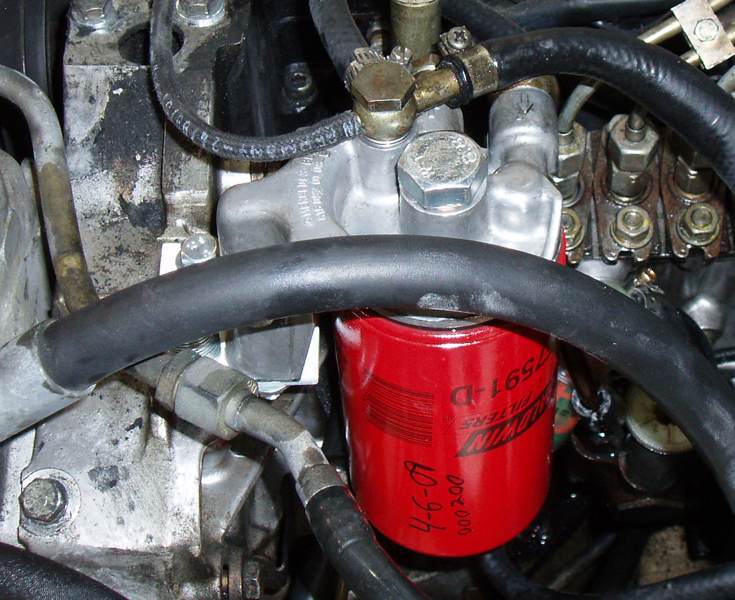

Filtration- Stock oil filter, Baldwin BF7591-D (2-micron) secondary fuel filter (4-5-09)
Cooling- Stock radiator, 6" water pump pulley and 9-blade 1985 style fan (7-13-09), 1.1bar mini cap, expansion tank eliminated and two cooling systems merged with remote expansion volume (03-15-2011)
3.46 differential (5-18-09)
Brakes- W126 Gen-II 300mm vented front brakes (1-11-10)
Water/Methanol injection, 2-stage with port injection, 6x70cc/min nozzles (07-17-2010)

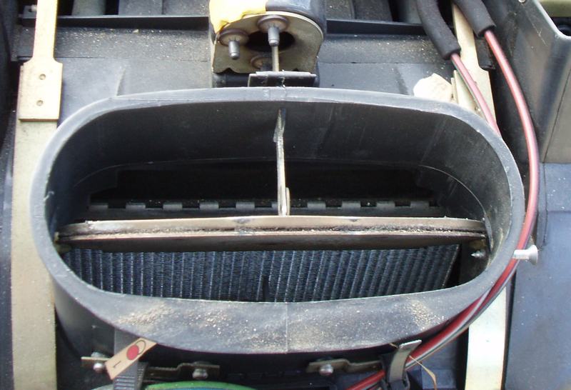

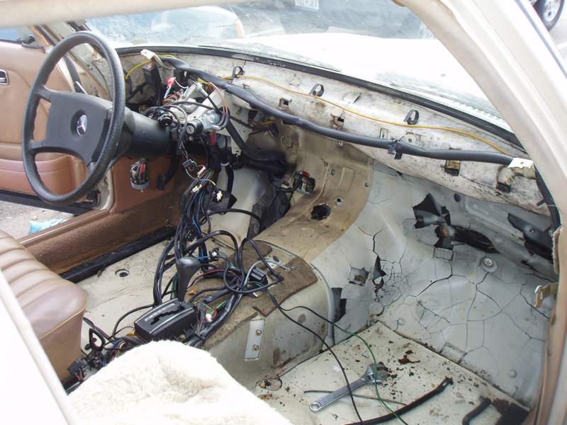

HVAC systems and heater box removed (4-7-09)

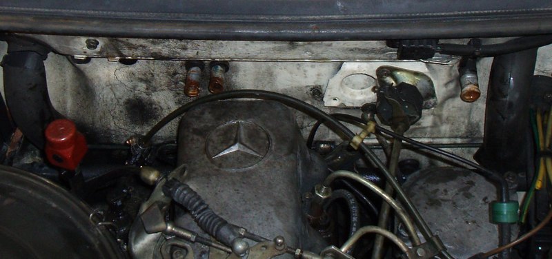

Engine bay 2011/03/16

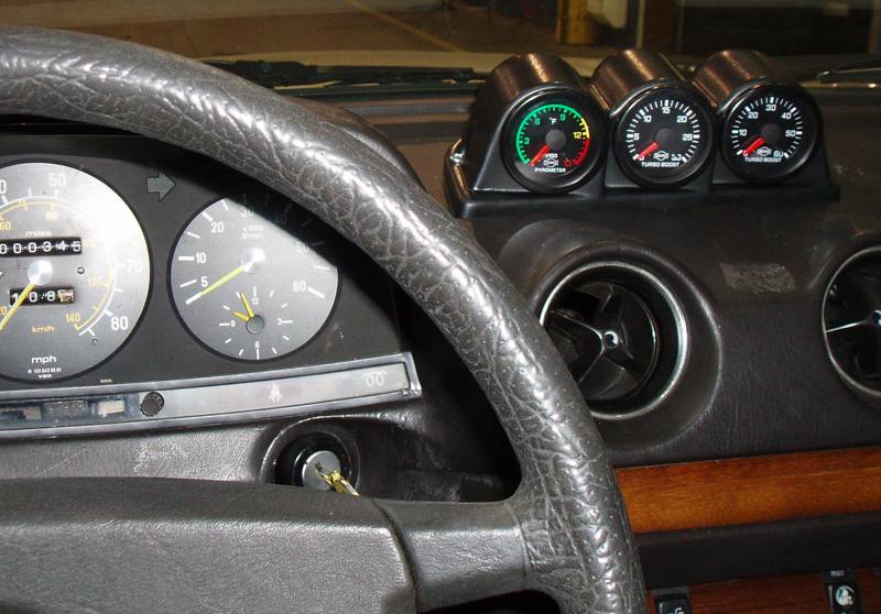

03-15-2009, 07:31 PM #6
(03-13-2009, 01:15 PM)Kozuka I was curious does the 82 300D use a mechanical oil pressure gauge?
Yes. W115, W116 and W123 use mechanical. W126, W201 and later use electric.
Quote:I'm curious as too why your idle is so rough
It runs a hell of a lot better after replacing the glowplugs and doing a valve adjustment. Injectors should cure the nailing and rough idle.
Progress today
Resealed the valvecover, for the third time. I finally got it to stop leaking (Lost a gallon of oil the first round). Rolleyes
Replaced the disintegrated shifter bushing. The other one is in so-so shape but it stills works. No more sloppy shifter. Big Grin
Found I have a coolant leak from the bypass hose. (For future reference: 42mm ID, 54mm OD, 40mm length)

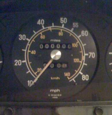

Tonight I'm going to repair the odometer and paint the needles (If my old bottle of paint hasn't hardened). Since the actual mileage is unknown and the currently displayed "146K" miles has been proven falsified, I'm going to reset the odometer to 000,000 for a fresh start. Smile
EDIT: Wow, this tri-gauge cluster is even more charred than my 240D's! Looks like I need two good ones now. The speedo's tamper resistant screw coating is broken and the numbers have been cleaned, confirming that its been altered.
EDIT2: The odometer repair is done. I'll paint the needles at a later date since I must replace the gauge cluster anyways.

The odometer works beautifully (I've put 50 miles on it already) and the speedo matched the school zone radar trap at 30mph.

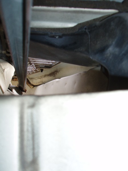

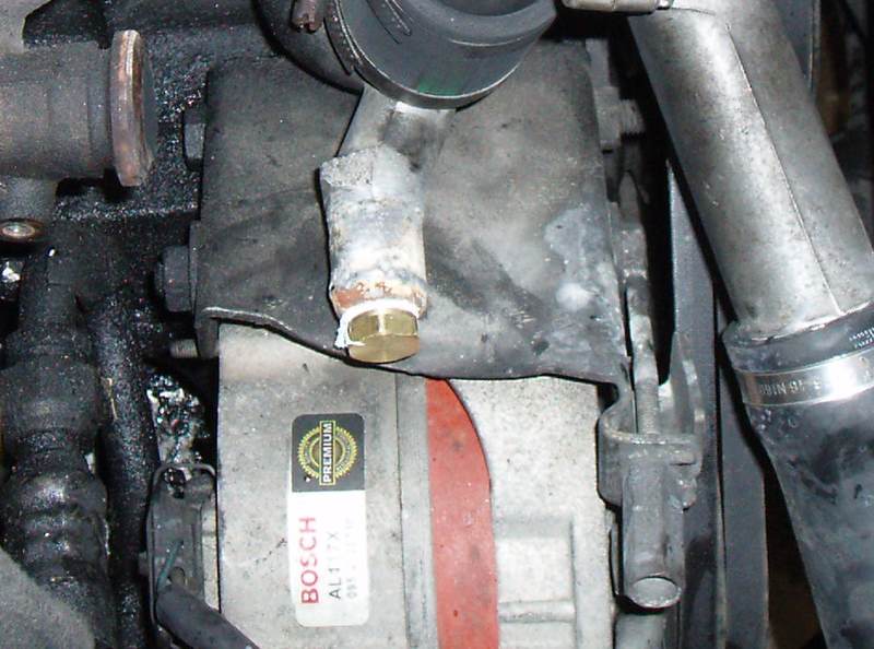

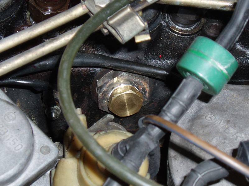

04-06-2009, 06:23 AM #14
Today I flushed the cooling system, replaced the 40mm bypass hose, blocked off the two heater ports, removed the external heater piping and installed the Baldwin BF7591-D fuel filter system.
NASTY brown coolant came out. It took 20 gallons of clean water flushing before it all came out clear.
The plugs will make it very easy to install 1/4" coolant hoses for the Holset. There will be no HVAC system, everything under the dash will be removed tomorrow.
This post was last modified: 04-06-2009, 06:28 AM by ForcedInduction.

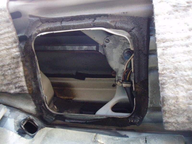

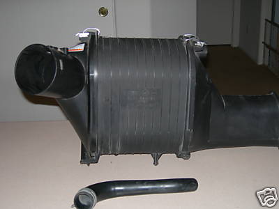

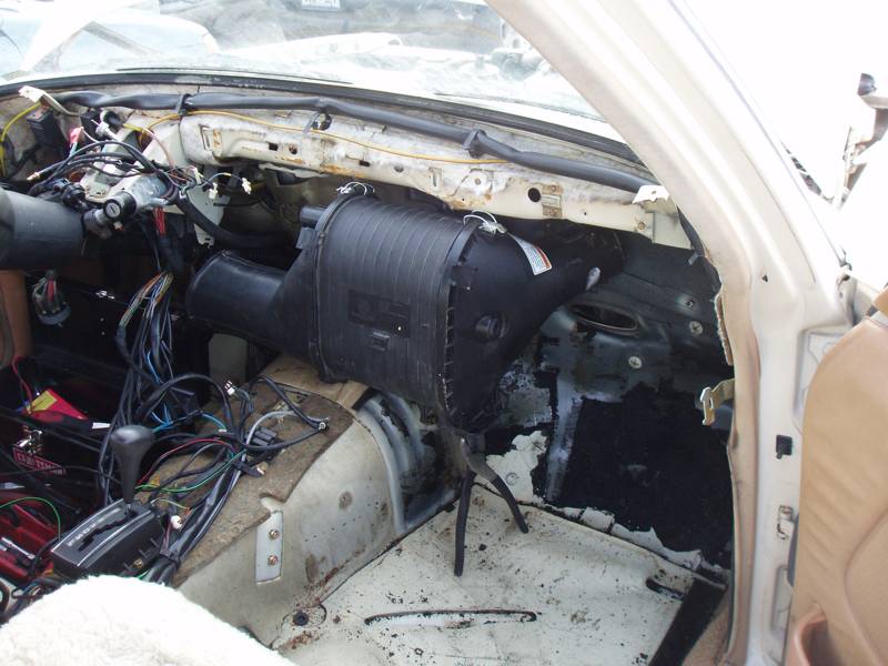

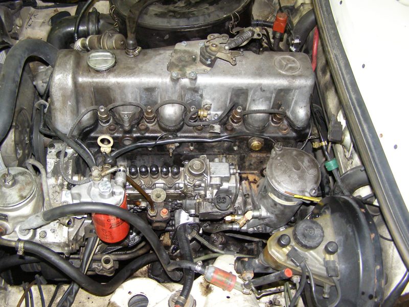

04-08-2009, 04:50 AM #19
Now you see it...
Now you don't!
Here is the basic placement of the filter. The battery will be relocated to the trunk, filtered air will go through the firewall to the turbo and cold air will come from the factory HVAC cowl ducts at the top center of the firewall.
Coincidentally, I have lots of good vacuum pods and ACC parts for sale.
This post was last modified: 04-08-2009, 04:53 AM by ForcedInduction.

04-08-2009, 11:19 AM #20
How was the heater element?
04-08-2009, 03:26 PM #21
The core didn't leak but I couldn't get the heat to work.

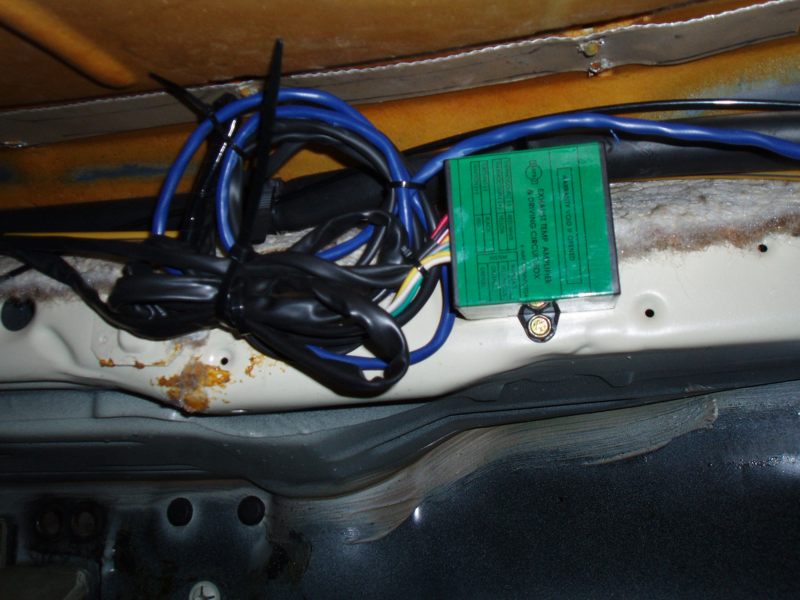

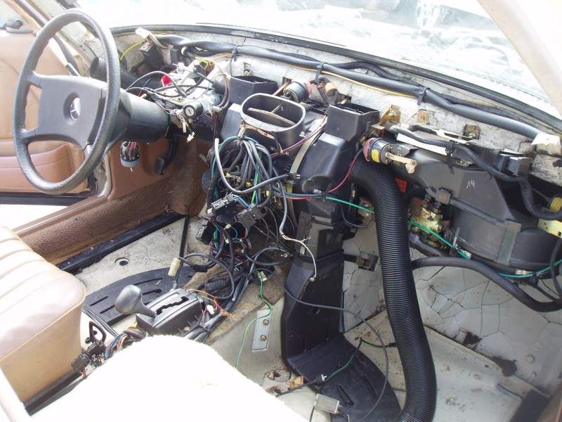

04-21-2009, 06:09 PM #31
I noticed that you removed wire harness that's located right beneath the windshield. Is this strictly for HVAC controls?
kamel

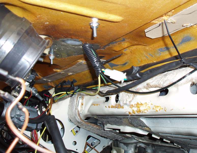

04-21-2009, 06:14 PM #32
Yes. It goes to the two control computers you see on the right and the blower resistor block in the engine bay. Mercedes designed it very well, they kept the different systems in their own individual harness instead of throwing it all in one wire bundle.

04-22-2009, 12:51 AM #33
Very smart indeed. I've pulled at least 20lbs of wire and vaccuum lines from mine, these will join the pile.

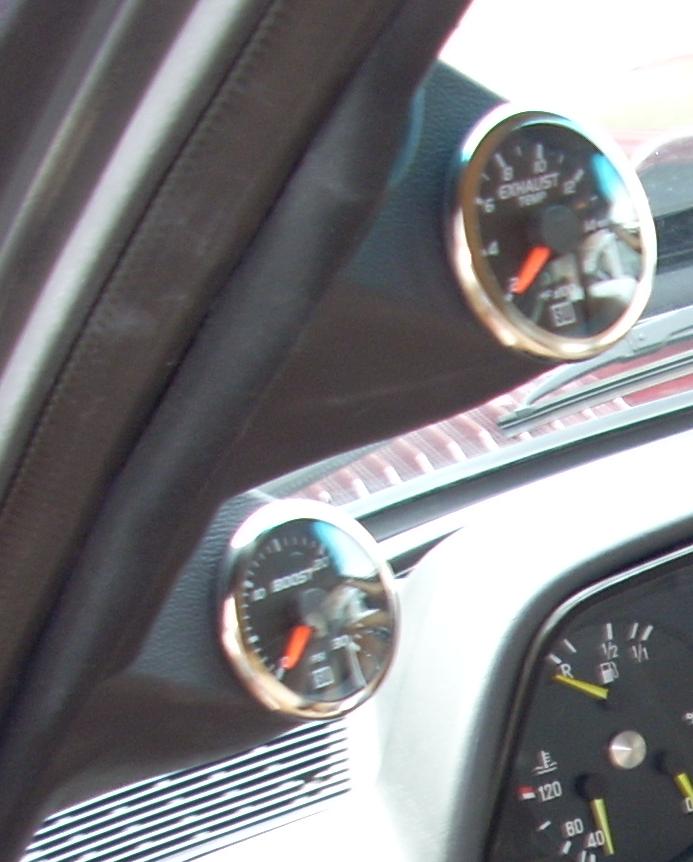

04-29-2009, 04:26 AM #37
More progress today. I finally got my gauges in the mail so I couldn't wait to install them. Big Grin
Boost turns out to be 9psi (as I expected). I must be spoiled to my VNT, boost builds painfully s-l-o-w. Rolleyes
EGTs get up to 1250*f by the end of a 0-60 run. EGT and boost are 700*f and 5psi cruising at 70mph, same as my 240.
The gauges are 30psi for boost and 60psi for EMP.
This post was last modified: 04-29-2009, 04:28 AM by ForcedInduction.

04-29-2009, 05:43 AM #38
(04-29-2009, 04:26 AM)ForcedInduction More progress today. I finally got my gauges in the mail so I couldn't wait to install them. Big Grin
Here is how I set up my gauges to give you another perspective on possible ways to mount them. Not sure if you could squeeze three on the pillar though.

04-29-2009, 11:04 AM #39
[Image: attachment.php?aid=589]
I take it you don't give a hoot on drilling into that manifold with that T3 turbo still attached to it! Big Grin
(04-29-2009, 05:43 AM)MB TECH ......
[Image: attachment.php?aid=594]
Where did you get the pillar pods? I've been looking for pods with the correct mounting angle and those look like they are the correct.
This post was last modified: 04-29-2009, 11:12 AM by DeliveryValve.

04-29-2009, 03:08 PM #40
(04-29-2009, 11:04 AM)DeliveryValve I take it you don't give a hoot on drilling into that manifold with that T3 turbo still attached to it! Big Grin
Yep. Both the EGR manifold and T3 are gone as soon as physically possible.

04-29-2009, 04:13 PM #41
The pillar mount is from summitracing.com (it is the universal 2 pod)
Also on the subject of drilling into the manifold for EGT, when I drilled mine I did it while the engine was running, that way the exhaust pressure will push the metal filings out instead of them entering the turbo

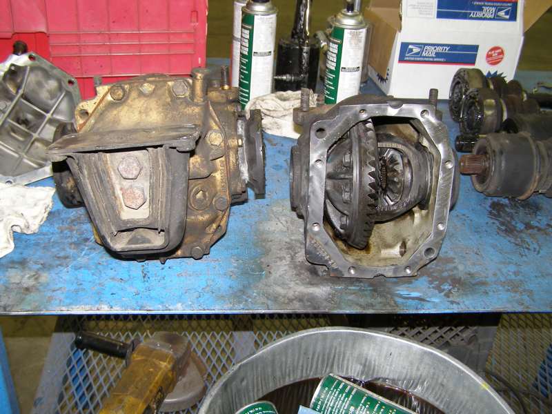

Got the diffs swapped tonight. The 300D now has the 240's 3.46. The 3.46 stayed sealed since it has oil less than a few months old but the 3.07 got Mobil 1 75w-90 synthetic. I didn't have time to swap the speedo so I didn't bother taking it out for a run.
The right axle turned out to be a CVJ reman. Smile

(05-25-2009, 12:10 AM)ForcedInduction filtered air will go through the firewall to the turbo and cold air will come from the factory HVAC cowl ducts at the top center of the firewall.
what a great idea... if my wife didnt need any kind of ventillation, i'd prolly end up doing something similar... I just roll down the windows when I need air, but shee doesnt like the wind noise or something...

06-22-2009, 04:48 AM #47
Some progress and a major setback today.
The driveshaft support and shifter bushings went in without the slightest hitch. Big Grin
The M-pump project stalled due to an oil cooler hose fitting that stripped coming off. Angry I should have put the tierod in the 240 instead. Rolleyes
This post was last modified: 06-22-2009, 04:49 AM by ForcedInduction.

Did a quick Italian Tuneup tonight. Top speed is 96mph@4500rpm, though it took a little while to get there with only 88hp. EGT topped out right at 1250*f with 9psi boost (but its raining so that lowered it a bit). The nailing is noticeably better which leads me to believe it may just be from carbon buildup.
That also shows that a manual (or lockup TC) would be good for about 11mph on the top end at the same RPM, my 240 could do 107mph at the same RPM with the 3.46.
07-04-2009, 02:57 AM #48
