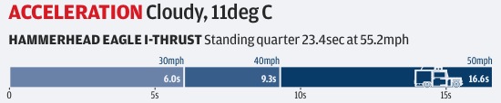

11-24-2009, 02:53 PM #17
(08-02-2009, 06:35 PM)ForcedInduction Will (willbhere4u) is in the 240D ahead.
24.316@56.57mph
Will, you've got competition! Big Grin Tongue
http://www.autocar.co.uk/News/NewsArticl...rs/245199/
[Image: 1911993147771590x1060.jpg]

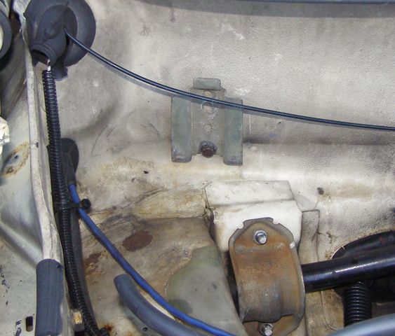

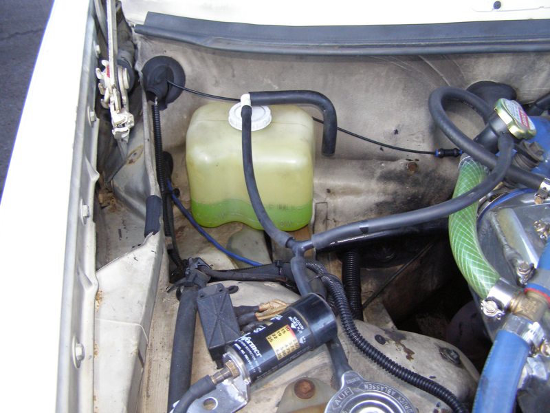

02-01-2010, 07:57 PM #18
The 300D is finally track-legal. Last August I had to use an old washer bottle as a catchcan because the track requires a 16+oz coolant container, even if the system is an expansion tank type.
The bracket is from an early-80's Mazda RX-7 and the tank is from a 90's Mitsubishi Montero. Its bolted to one of the old battery tray mount holes.
Note: Don't worry, green is only for the intercooler circuit. The engine uses the correct yellow.

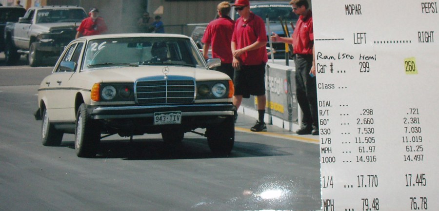

08-08-2010, 09:02 PM #23
I ran 17.445@76.8 this year, vs 18.847@71.20 last year.
My first run was against a Ram 1500 Hemi and I actually had him all the way up to the last few feet. Big Grin Second run was against a 14second Dodge....
Video: My reaction times and launches were not as good as I'd like, every time the second stage water/methanol would kick in I lost traction on the line. I really need LSD.
The video quality is poor because I had to use my backup camera due to dead batteries in my primary.
http://www.youtube.com/watch?v=njk1YhMcL_w
Unfortunately, they said this is the last year they will let me get away with entering. Maybe next year I'll bend the rules a little by removing the trunk lid and calling it a Benzomino. Big Grin
