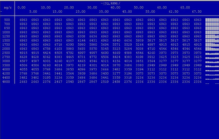

03-08-2010, 02:38 PM #13
Here pilot map from 2260 vnt turbo.

03-08-2010, 02:40 PM #14
Can you get a bigger pic? What is this exactly from?

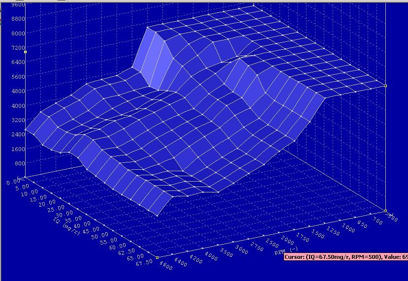

03-08-2010, 03:14 PM #15
Its from BMW E60 3.0 diesel ECU code Smile
Here better resolution with table.
If you need from some other european car just ask Cool

03-10-2010, 01:41 AM #16
Is that ECU a bosch EDC16?
What software do you tune with?

03-10-2010, 12:53 PM #17
Yes its EDC16.
WinOLS

07-16-2012, 06:49 AM #18
(03-08-2010, 03:14 PM)INC Its from BMW E60 3.0 diesel ECU code Smile
That's very interesting information there. I'm having a hard time figuring out the table axis and data though.. concerning the table in the 2nd pic: rows are engine rpm i suppose, but what are the columns (mg/r??) and what's the data in the cells referring to?

07-17-2012, 02:26 PM #19
MG/R could be milligram per revs which would be a fuel delivery rate. The y axis could be decimal values, possibly translating to a PWM value. Just a guess. I've spent many hours trying to translate maps in this program. It's difficult without the .ols file.
INC, are you not worried about posting winols screenshots on a public forum?
