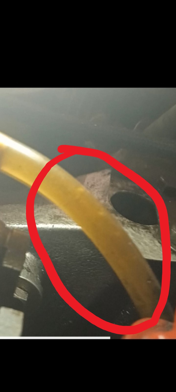

You were right there is a lot of bubbles coming from the pump return line. Air bubbles are entering from the injection pump fuel pump on the side. Not sure if from fuel pump being broken or fuel line issue before pump.
I'm surprised it runs because there is a constant stream of small bubbles and a few larger ones now and then and from my previous experience, any air causes the engine to shut off.

I added a picture where you can see the air bubbles coming from the injection pump return line.
There don't seem to be many if any air bubbles at idle but giving it a slight rev to 2500 rpm and letting it return to idle results in air bubbles such as in the picture coming from the injection pump back to the filter where the fuel returns to the fuel tank. There is a sudden stream of these bubbles and they stop coming after returning to idle.
I'm quite certain no air bubbles come from the fuel tank. These air bubbles are quite large and I have seen even bigger bubbles come from the pump.
The shake is horrible still but increasing the rpms by 300 results in a silk smooth idle. If I increase the revs slowly I can feel that 1 cylinder picking up at around 850 rpm and at 1000 rpm it doesn't shake at all. If it matters I think cyl 4 is the issue because after cracking the fuel line and revving it I don't feel that 1 cylinder picking up at all anymore. It's also not like it doesn't run on cyl 4 at all because it does. Disconnecting the fuel line makes the engine run extremely bad. Reminder that this happens only after the engine has ran for some time and it stops doing it after sitting for a few hours.
