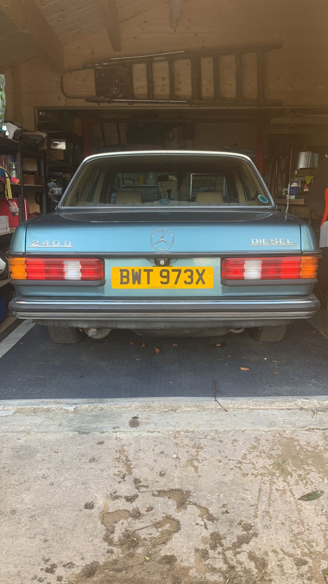

Mine's a 1982 240D w/ about 215k miles and the factory issue rust problems. But it passed MOT and is not so ugly.

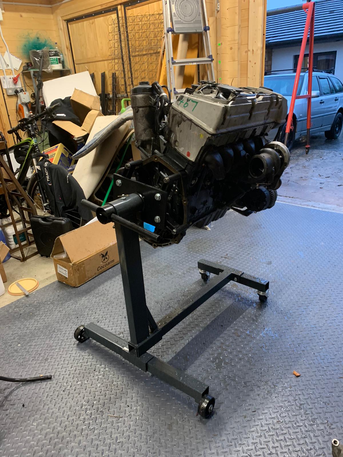

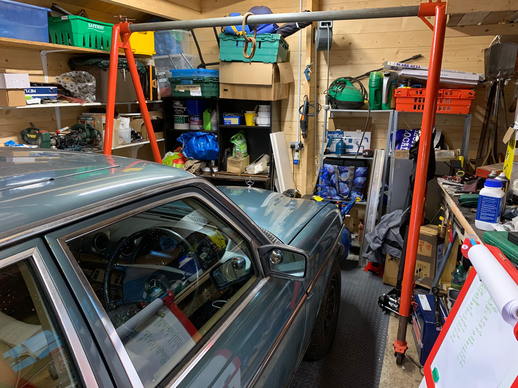

I've also got a 1998 C250 with the OM605, which I've removed and am prepping to install a DPUK mechanical pump (7.7mm elements? dunno).
I really am doing it so I can prove to myself that I'm capable. Not interested in burn outs (sorry) but really want a classic car with modern equipment.
I've chosen to go with a 5 speed out of a W124 and use the pedal box currently in the donor 123.
