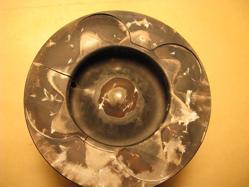

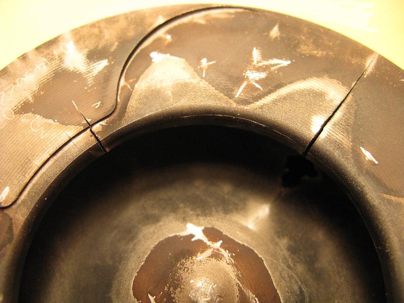

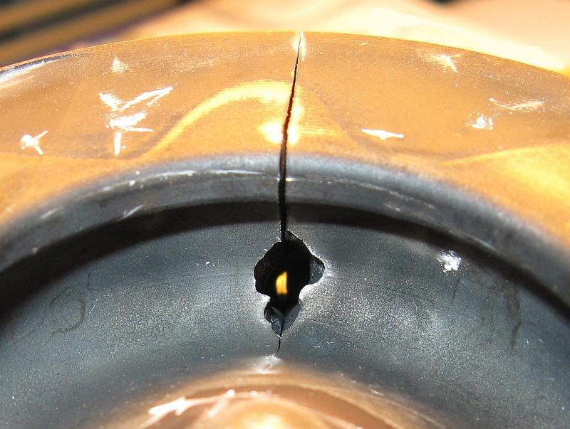

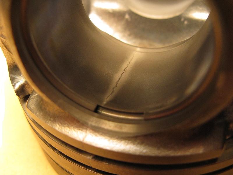

The fuel system will happily provide more fuel, but the engine may not be too happy with that.
The specific OM642 from the pictures ran "only" on ~300HP, but in a direct injected engine things are a little different compared to a IDI.
The engine died at ~160.000km which was approximately 20.000km after leaving stock power level at 140.000km.
On the first picture you can see there is a nice 8 sheet flower corona on the piston, every sheet  like the other one. So the nozzle was not broken, only the engine could not handle the increased stress.

Don´t worry, those are not my pistons, but I get this kind of info every now and then.
They came from a non LS version of the OM642.
