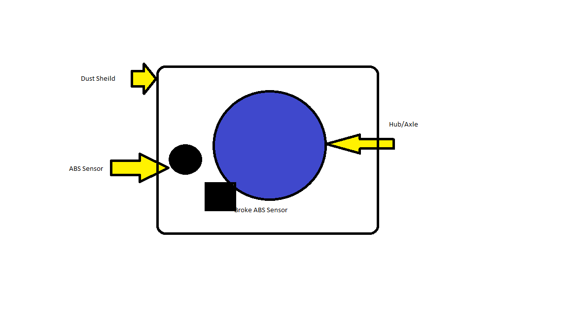

Hey,
So remember that BWM I asked about a while ago? I finialy picked it up and its been great
I replaced the ABS Sensors to get the speedometer working and that went pretty well, expect for one part.
The passenger side sensor when I was removing it, broke in half and when I attempted to extract, only managed to push it in.
The get it out, I would need to remove the wheel hub to expose the it.
I attempted to extract it with no luck. I dont have the proper tools to do this.
So..I left it in there and its making a whiring noise from rubbing with axle/hub.
Its mostly plastic and Im thinking it should just wear down over the next few days as Im driving.
Should I invest and take it to a mechanic and have them remove it, or leave it be?
If  I was planning on removing it, will removing the wheel hub force me to replace it with a new one?
heres a little diagram I made in paint to give an idea.

03-20-2016, 05:01 PM #2
Since the sensor is junk already can you heat it up and dig it out with a ice pick hook or simliar tool?

03-21-2016, 06:02 AM #3
I use to drill them out. Once you break the walls of the plastic casing of the sensor, the clamping force is gone and you can pull it out.
Maybe you can use a chisel to break the wall. Or like above, heat it up, let the plastic melt and pull it out. Clean afterwards with some kind of wire brush.

03-21-2016, 07:19 AM #4
(03-20-2016, 05:01 PM)MFSuper90 Since the sensor is junk already can you heat it up and dig it out with a ice pick hook or simliar tool?
There is very little room for me to dig it out.
The new ABS Sensor is already installed, I was hoping that the broken one would sit at the bottom of the dust shield and not cause any trouble but its making a noise.
the only option right now is to remove the wheel hub.
Will this cause me to replace it?
if not, I can pick up a 46mm socket and take it out, hopefully
