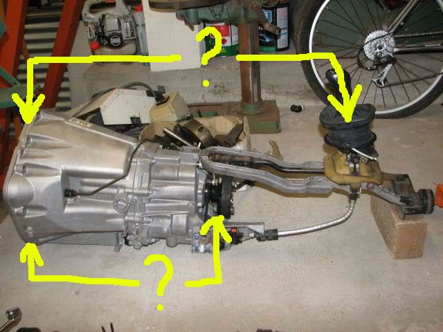

but does anyone know the the measurements between:
IN Metric Big Grin
1, from motor flange to gearshift ?
2, from motor flange to utput flange ? (without the rubber ring)
Hope u like my photoshop skills! Cool

(01-10-2015, 12:42 PM)MrHope 2, from motor flange to utput flange ? (without the rubber ring)
I measured 53 cm at my 716.641 from 270cdi,
Greets
Max
Greets
Max

(01-10-2015, 01:27 PM)Max
Greets
Max
so its about the same as a 5spd ? if im not totally wrong my 717.460 is about 50cm~

01-11-2015, 07:40 AM #5
Hi,
the "normal" 5-Speed (717.411 etc..) are shorter.
My 717.430 (190D 2,5 Turbo 5-Speed) ist about 48 cm
The 717.450 (Dogleg from m104 3.0 24V) ist about 53 cm
Tahts all i got Tongue
Greets
Max
