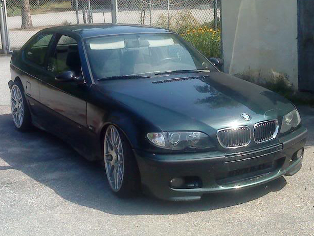

(02-05-2014, 03:04 AM)Eric78 How much bigger(outside dimensions) than an M103 is the OM606? because the M103 was a factory engine option in the W201

(02-05-2014, 03:35 AM)F.R.A.S Yea, that's right, the 2.6 is an inline six in the old w201.
Some AMG & Brabus specials had 3.0 & 3.6litre straight sixes in them.

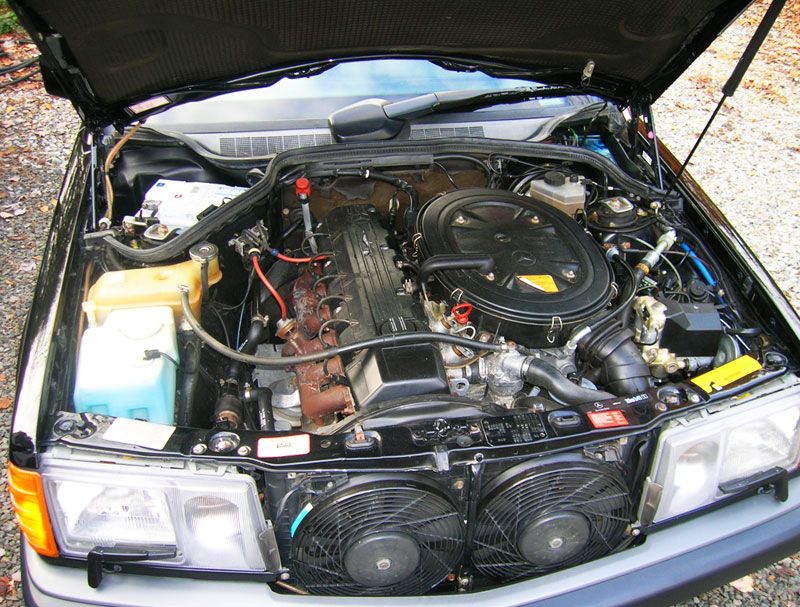

02-05-2014, 11:15 AM #35
Forgot about those bad boys Cool
Looks the same size as the om606.
Here is the m103 2.6-liter (190 2.6) Lots of room for a turbo build Smile
