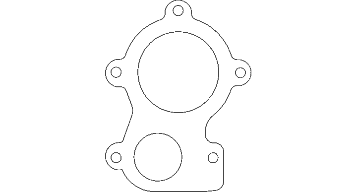

Who it be, what it do. I've printed it at 1:1 and eyeballing things the pattern is correct. I'll get a full fancy drawing with SBC and all that later, but if you're looking to home brew a 617 adapter plate this is what you're looking for.
[Image: gI6Th5q.jpg]
T3 to GT2056V. If I did it again I'd probably move all the GT bolts/inlet to the right and down 1/4"-3/8"

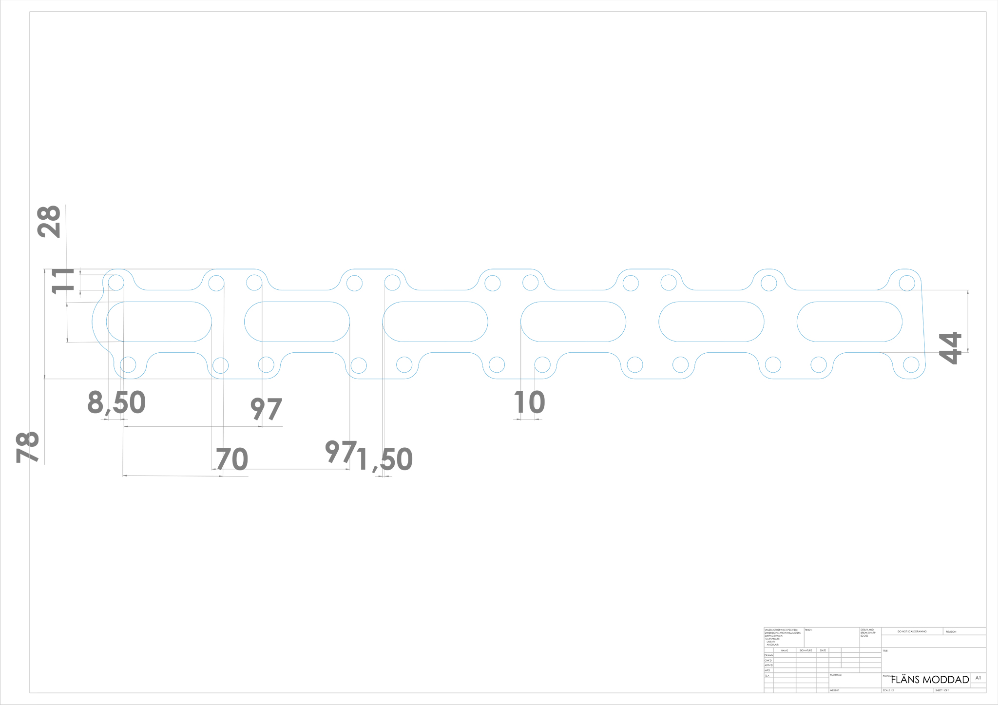

Here is the exhaust flange for om604/605/606 (cut to length).
I hope I've got all the important number on it.
Edit: Width of the ports are 74mm.

Great! Thank you!

No problem. Just let me know if I forgot something...
Think about the fact that I've not measured in the center of the bot holes. The program was a bit pissed on me (I modified our special flange to just show the standard flange pattern) so I had a hard time making this Tongue

Could be me but I can't find the width of the exhaust port? Tongue I anybody has a cad drawing would make me very happy. Wink Or i'll just copy the top drawing in solid works.

Tongue you see, hahaha... Thanks mate. 74mm is the width of the port.
50mm is the straight area, that means that the radius in the end of the port are 14mm witch also determents the port hight of 28mm Cool

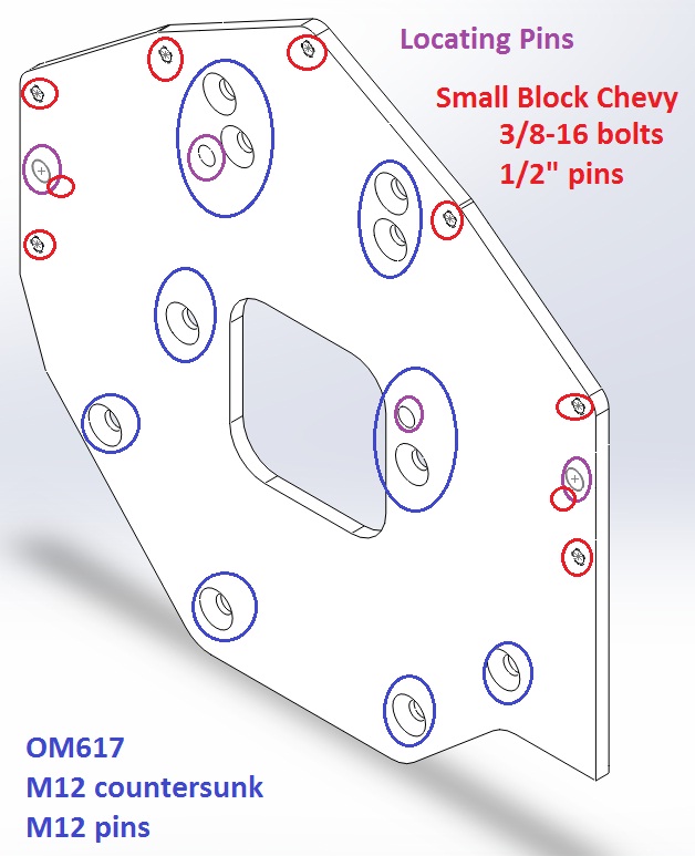

617 block, small block chevy bell. NV3500, Muncie, etc. should fit this. The holes have been printed out and eyeballed on a desk, everything looks pretty darn square. The starter location is TBD-I'm going to try and squeeze a 617 starter on there somewhere.
The center cutout is 4.5"x4.5", the om617 pins are 12mm, the SBC pins are 1/2"
You will need to drill the 617 crank pattern on an 86+ (single piece rear main seal SBC) flywheel. The om617 crank pattern is twelve 10mm holes evenly spaced on a 103mm diameter circle. This should fit inside the 86+ SBC flywheel pretty easily.
I'd still reccomend checking the bell housing's center with a dial indicator, and using offset pins to center it all once assembled.

OM606 in DXF, sorry for not posted it before.
.dxf
OM606 FLÄNS.DXF

Does anyone have a DXF of a Holset HX/HY35 outlet flange/ Otherwise I will have a go this week

This one?
With or without WG hole?
Or round flange with 6 holes?
With WG hole
https://www.upload.ee/files/6444071/hx35...g.dwg.html
WG hole blocked
https://www.upload.ee/files/6444074/hx35...d.DXF.html
