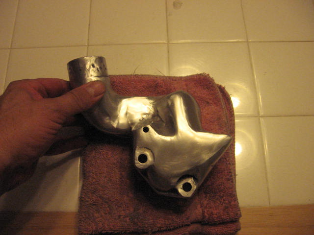

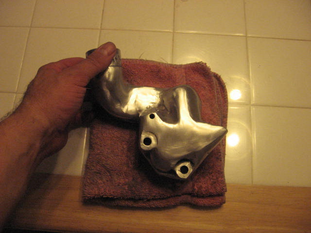

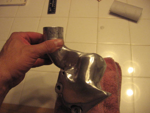

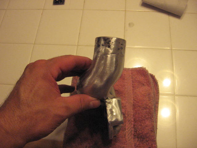

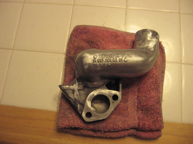

After about a year of tinkering with this concept and that design, I just realized that hacking the parts from the OEM set up will work. Here are some pictures of the last missing piece to installing an electric water pump. This gets rid of the water pump (mechanical) and this permits me to use this piece on my turbo engine which will be installed down the road. The NA engine gives a little more clearance with the crank and hub, but I am thinking I do not want to make another one of these. I have some more filling in to do, some more grinding, and then buffing. However, I am thinking maybe by the end of this weekend I can hook up my Davis-Craig electric water pump. Who would have thought that after wasting so much time, simply buzzing thru 2 to 3 water pump housings and I could wrap up this modification. LOL. I doubt when I am done I will have a total of 8 hours invested in this piece. However, I have made a bunch of plates, bent tubing, and you name it over the last year or so. None of it would ultimately clear the crank pulley on the turbo engine. Very tight spot in that neck of the woods.
