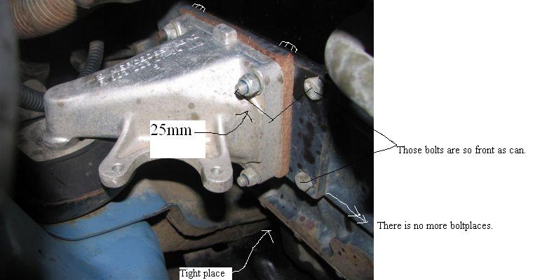

This is the mount modification for the 603, it should be the same for the 606.
The transmission would likely be the stock one used with the 603 upgraded with 722.6 clutch packs/bands unless you want to make a standalone computer for the 606's tranny.

Great photo, which is worth a 1000 words Wink So, the driver side needs to be 20mm in thickness, and the passenger side 10mm?
Is that the 603 mount in the photo? I will take a look at the 606 mount again, but I think it is different.
