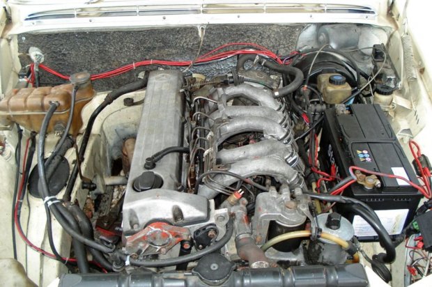

03-15-2013, 04:26 AM #8
(03-14-2013, 03:46 PM)sassparilla_kid I'm just wondering if anybody knows what it would take to swap a 616 from a w123 into a w115.
Thanks
It can be done but you will have to do some chassis interventions
cutting/welding.. I have not done it but I have asked guys that did.
one of them has adopted OM602. (pic)
as they told me 240D is slow dog so they preffer 300D.
cheers
Thanks
cheers

Okay reviving this thread, got a couple questions. First question, anybody know if a later 616 IP will bolt right on to an earlier 616 with the old style IP? Second question, if I turbo this thing the fast and easy way (no full rebuild yet) is a "T" in the oil pressure gauge line a viable way to supply oil to turbo?
If so I think I could turbo this thing in a weekend as long as I make the exhaust manifold first
Also, wouldn't plan on running more than 7-8 psi boost
06-12-2014, 03:04 PM #30
If you're running the topload filter like on a 617a then get a 617a backplate for the oil feed.
Can you tap the filter housing to get clean pressurized oil somewhere else? 1/8" like seems pretty small to oil a turbo from 24" away
06-12-2014, 03:09 PM #31
No room for that type of filter, it's got the retarded pain in the ass semi upside down canister
