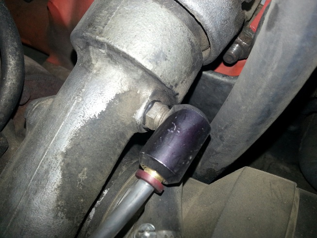

11-29-2012, 05:41 PM #6
I drilled and tapped a hole in the flat spot near the outlet of the compressor housing, I'll try to get a picture after work

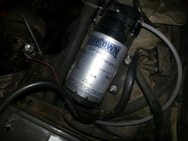

11-29-2012, 09:54 PM #11
I didn't even take the compressor housing off, just put the turbo on the driveway and drilled the hole, was just really careful to make sure it was oriented so all shavings would fall out.
So here is where the nozzle went in
And here is the pump
And to the left of the pump you can barely make out my ghetto solution to blocking off the oil drain left over from when I took the stock air cleaner out, it is some heavy duty aluminum foil folded up a bunch of times, squeezed around the drain and held on by a hose clamp.
