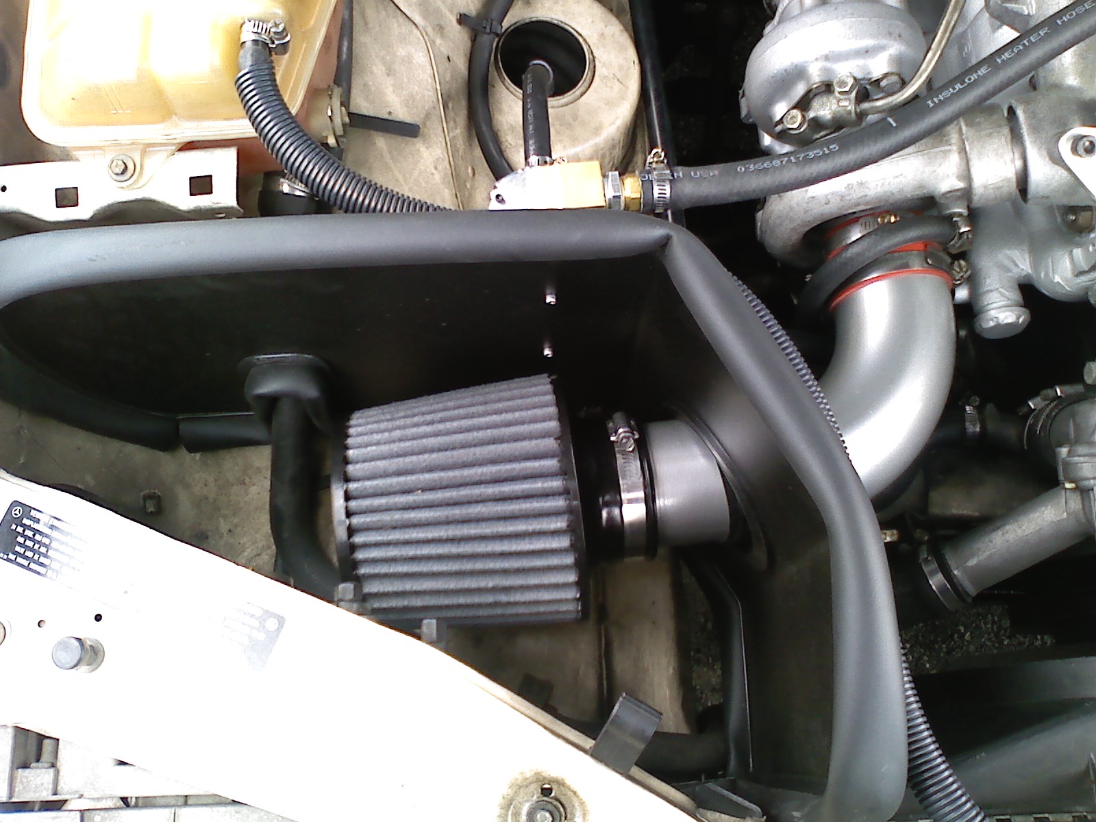

06-08-2009, 10:56 AM #2
I love that air dam around the filter. I am going to look into that for my car.

06-11-2009, 05:27 AM #3
I like that air dam, the filter is too small but that setup is still a far sight better than what most people "upgrade" to! Big Grin
A generic T4 "kit" won't work very well. There are many different types of T4 compressors and they each work very differently (some are made for high flow and some are for high pressure).

06-11-2009, 11:12 AM #4
Thanks for the info. The filter is an AEM Dryflow filter P/N 21-203DK and is rated at 819 CFM.

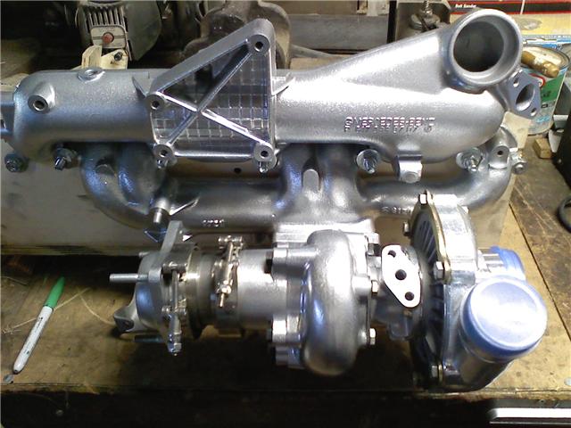

06-21-2009, 10:44 PM #5

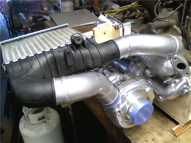

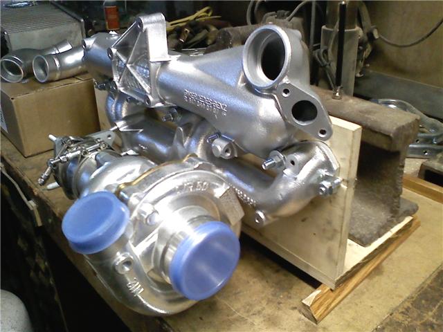

Here are some pics as to the progress of the project. After many hours of research and calculations I decided to go with a T3/T4 T40E turbo.
06-22-2009, 10:57 AM #6
Wow purty and SHINY. I like SHINY. Whats the deal with the bracket looking thing on the intake where the stock airfilter would be? Do you have a map for that turbo?

06-22-2009, 11:02 AM #7
(06-22-2009, 10:57 AM)winmutt Wow purty and SHINY. I like SHINY. Whats the deal with the bracket looking thing on the intake where the stock airfilter would be? Do you have a map for that turbo?
The bracket is where the trubo bolts to on a California model with a cat.
The map is available on the net, I don't have the reference right now. It is pretty much right in the center of the map, the stock turbo is way out of spec and it seems to fall on its face above 3000 rpm

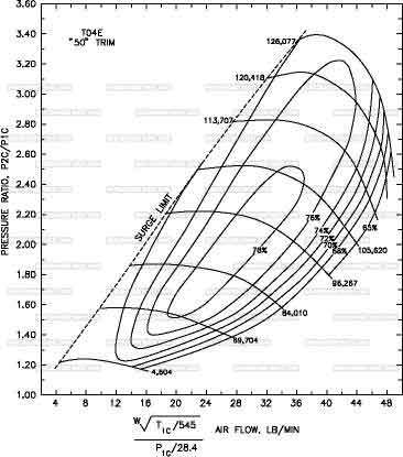

06-22-2009, 07:20 PM #8
Is the compressor a 40? If it is that would be pretty nice on the map.

06-23-2009, 12:46 AM #9
It is supposed to be a 50 trim,
According to calculations I need a 2.00 pressure ratio and 30 lbs./ min at 4350 rpm.

06-23-2009, 01:15 AM #10
At sea level.

06-23-2009, 09:03 AM #11
(06-23-2009, 01:15 AM)ForcedInduction At sea level.
I live in Southern California and pretty much just drive around town, 350' elevation.

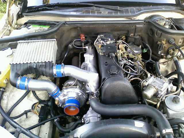

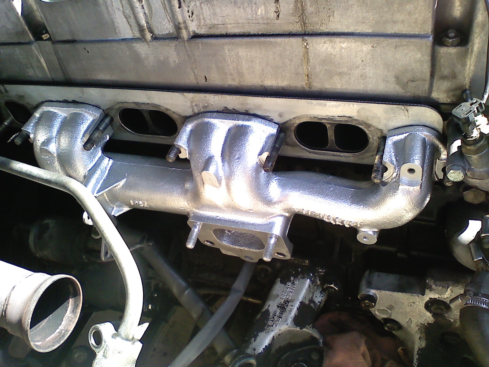

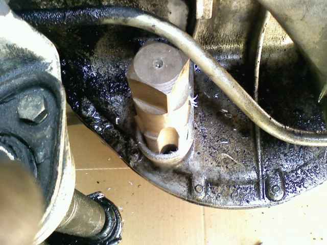

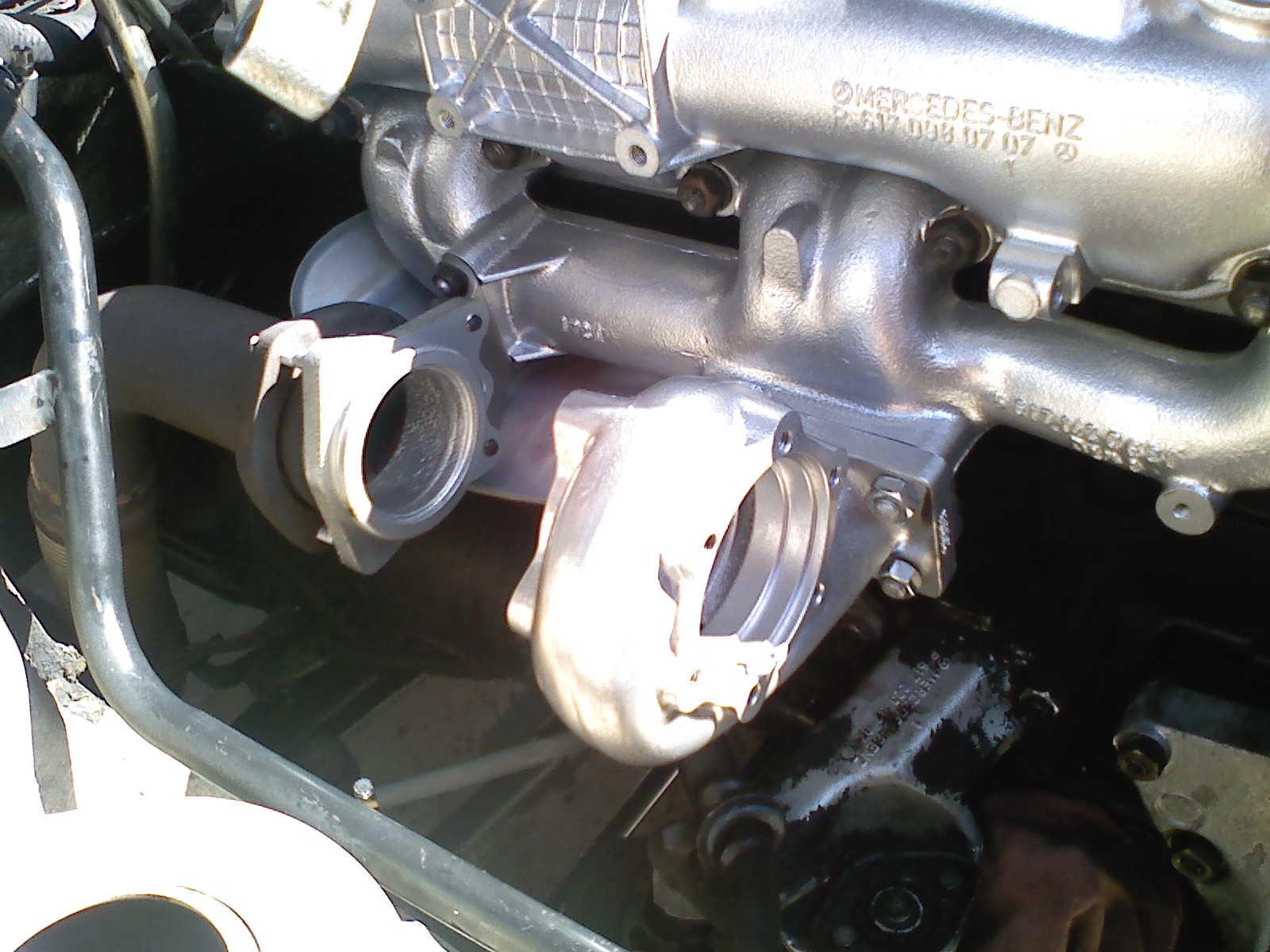

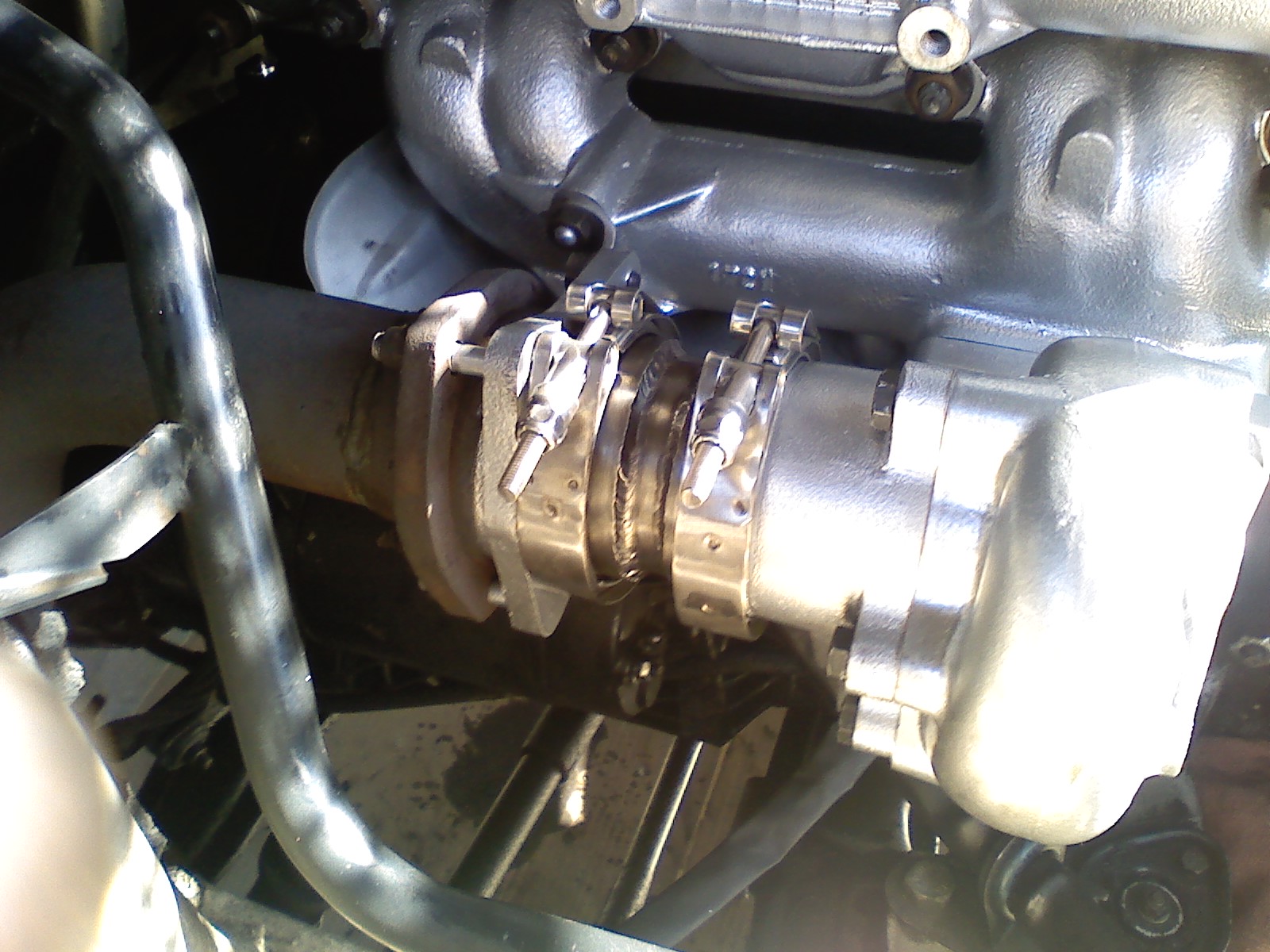

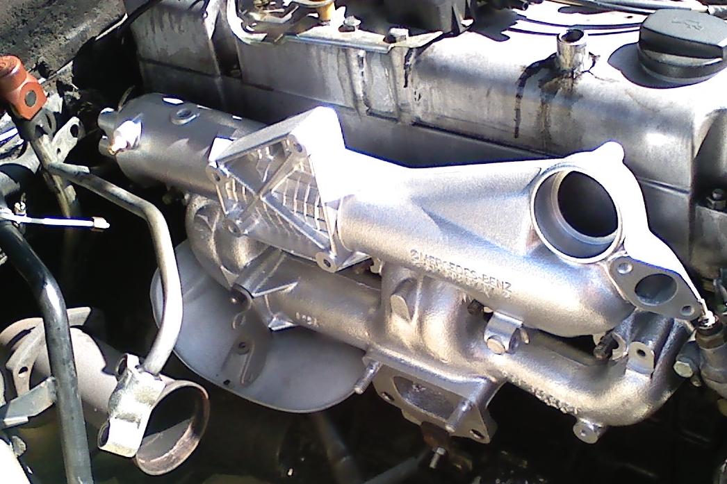

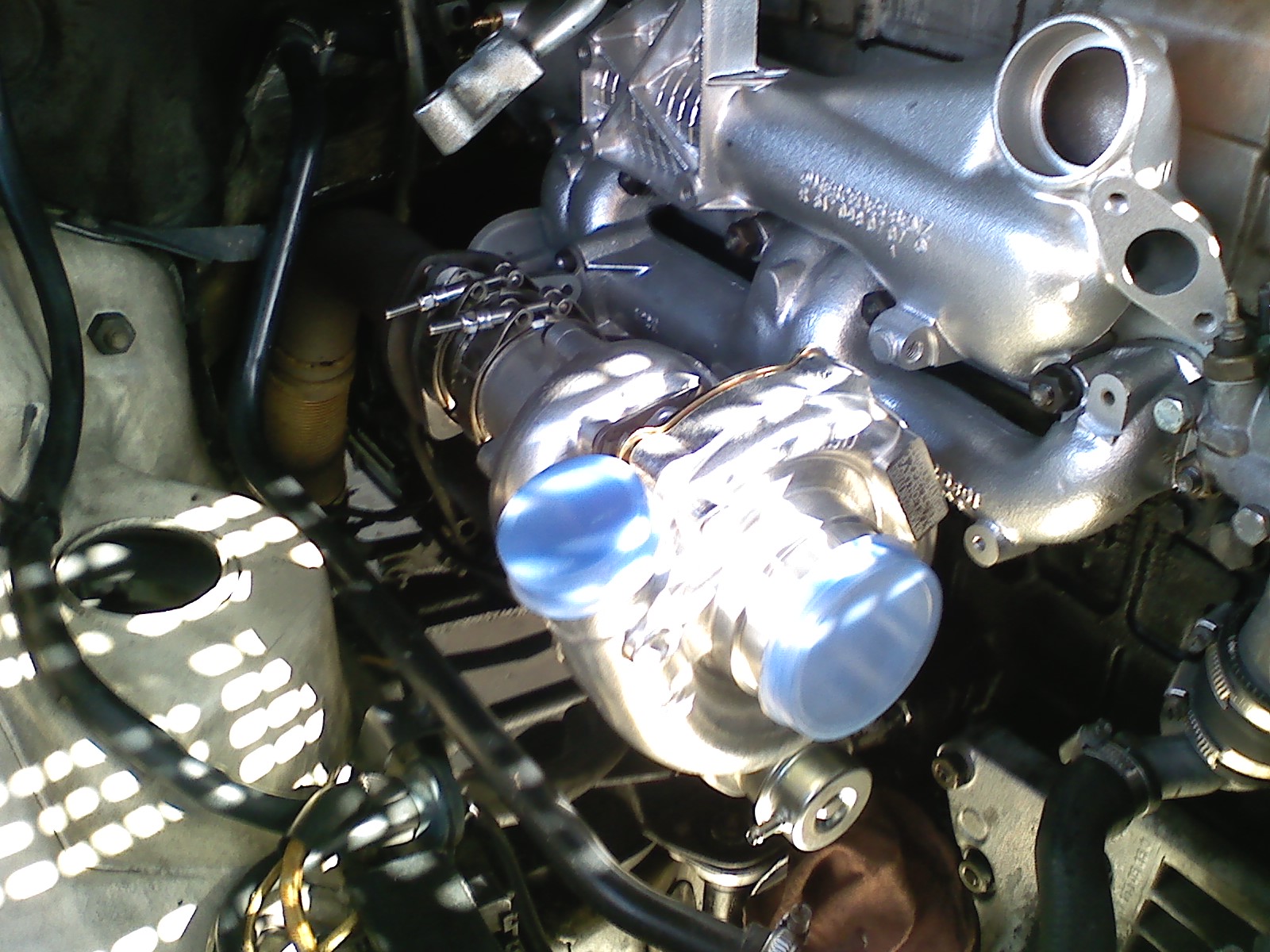

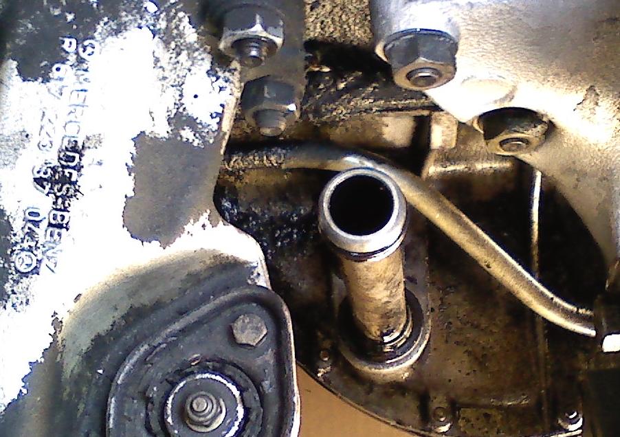

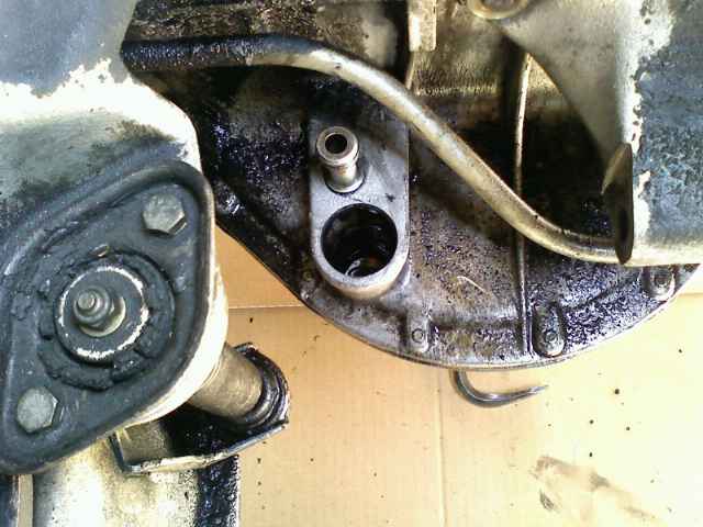

07-05-2009, 03:06 PM #15

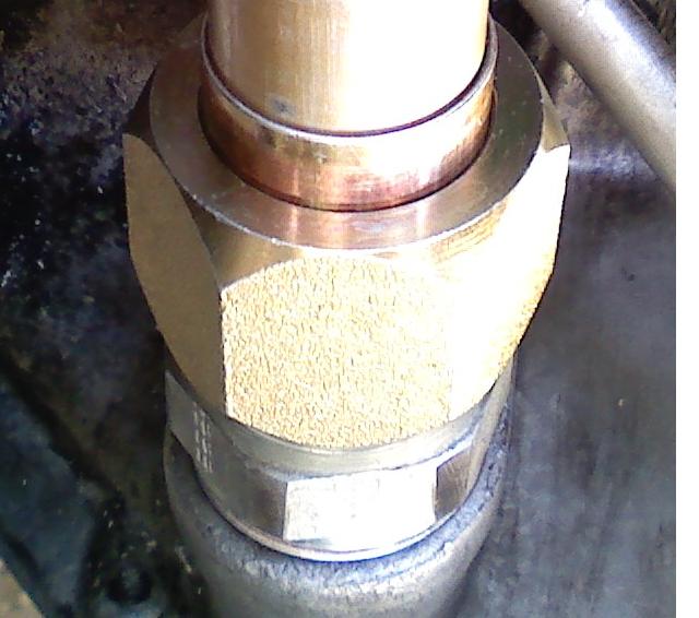

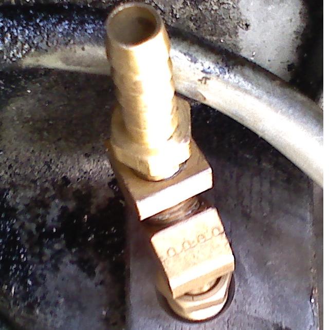

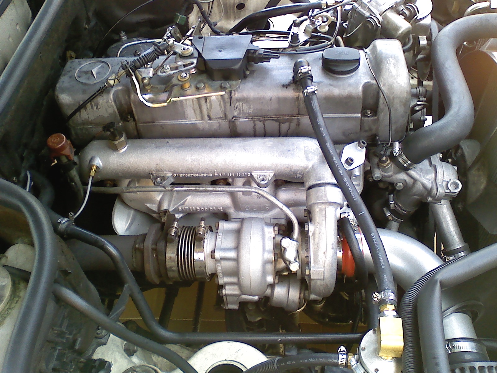

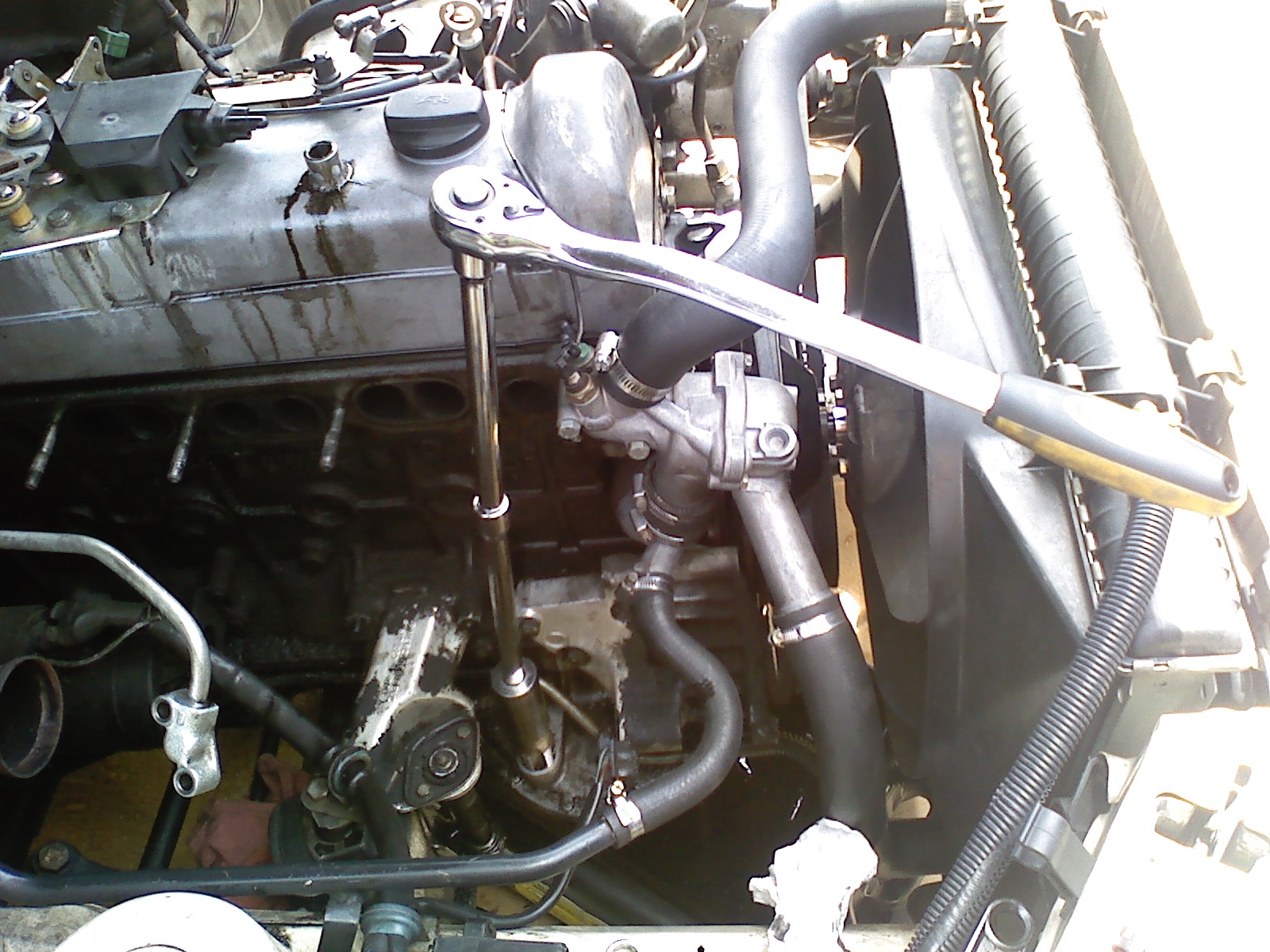

Well I finished the install of my new turbo and have some pics to share. I also fixed the leaky turbo oil return, not mercedes OEM, but how they should have done it!
Before teardown
Before tear down
OEM oil return tube
Oil retrun tube removed
Starting to drill hole for pipe tap
1" NPT pipe tap
A little assistantce to tap hole
Tapped holes
Oil return line from catch can
New return line
Some pics of the completed project...
Exhaust manifold
Intake and exhaust manifolds
Turbo exhaust housing
Turbo exhaust with v-bands installed
T3/T40e installed
Another pick of intercooler
A closer look at intercooler and piping
Before teardown
Before tear down
OEM oil return tube
1" NPT pipe tap
Tapped holes
New return line
Exhaust manifold
T3/T40e installed

07-07-2009, 07:21 PM #21
Initially I was disappointed...only 8 pounds of boostConfused, but then I figured out I didn't set the waste gate correctly. I needed to put some preload on the actuator. I also installed my manual boost controller. I made the boost controller out of 6061-T6 aluminum and used two ball bearings on either side of the spring. It uses a set screw to adjust tension on the spring. I will post a pic when I get some time.
I have adjusted the MBC and the boost peaks at 14 psi.Big Grin It starts to come on around 2000 and peaks at 4500. At 70 I am at around 4 and when I floor it it comes up to 10 pretty quick. I don't have the low end boost, but there is a compromise.
I also have removed the rack limter and eliminated the ALDA, but I may put the ALDA back on since I am not building boost right off the line. I was experiencing some smoke when I would come to a stop, I think oil was making its way past the turbo shaft seals and getting into the exhaust side. Since I turned up the boost I haven't seen it.
I still need to hook up my EGT gauge and boost gauge...I ended up getting VDO in lieu of using my Sunpro boost gauge....
Does anyone want to but my old setup? I just rebuilt the turbo a month ago.
BTW, how much boost can I run?Huh
