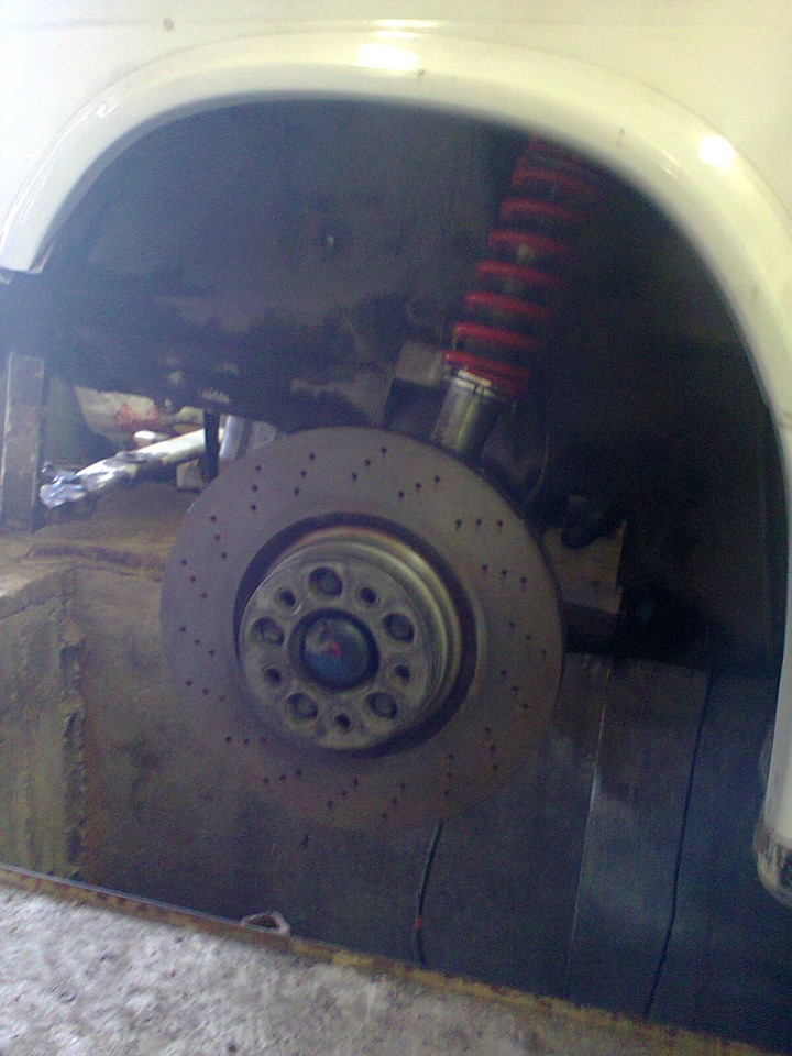

Just to follow up on my install, I couldn't get these to fit inside any of my 15" wheels, although the problem didnt seem to be the diameter, more of an axial (from spindle) clearance issue...different backspace wheels would possibly work(mine rubbed/stuck on the inside face of the wheel)... at any rate, since my w123 is not currently running, I stole my 16's from the front of that one and have a set of 17's from a later model (202 comes to mind) that do work (will need 12mm bolts with 14mm ball seats)...just awaiting my full suspension rehab to fit those as they have all new rubber on 'em.

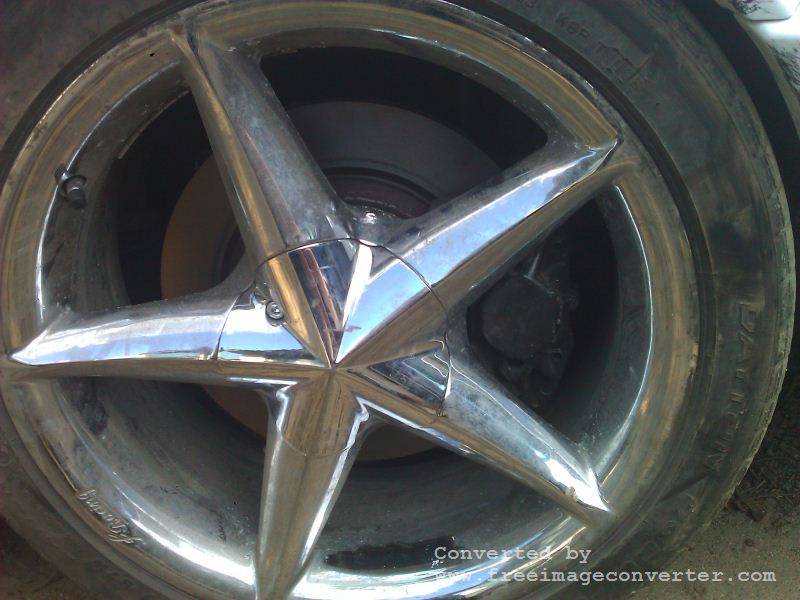

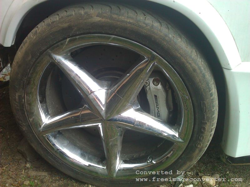

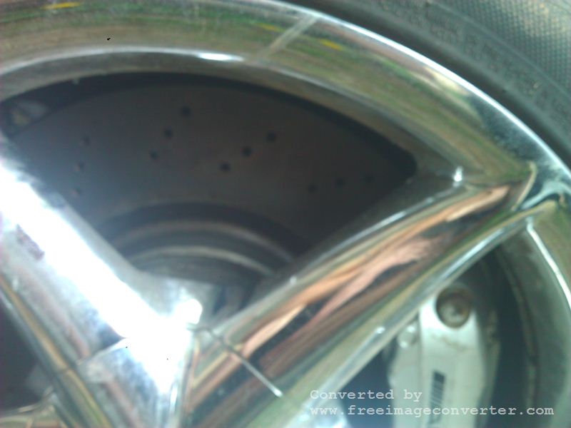

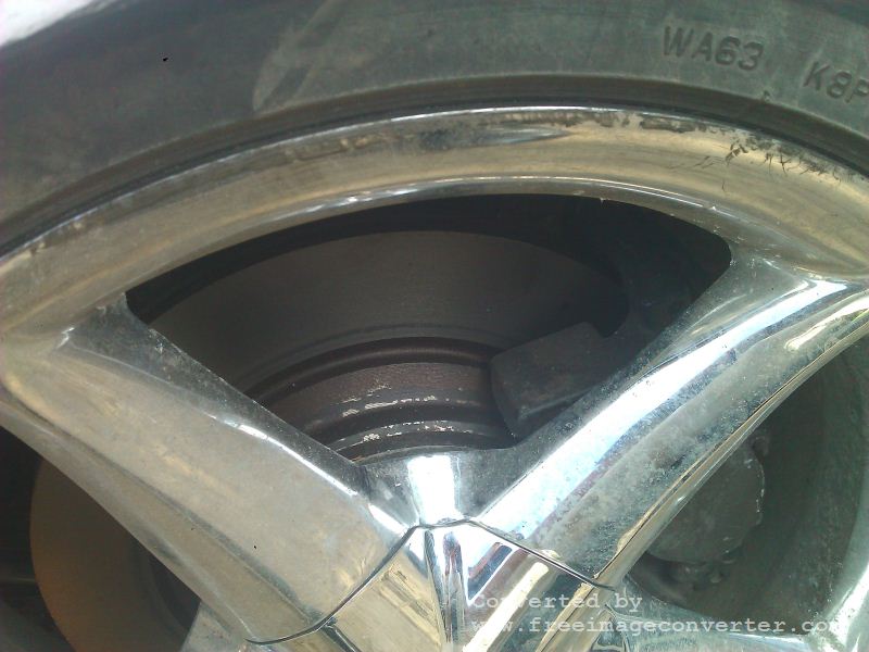

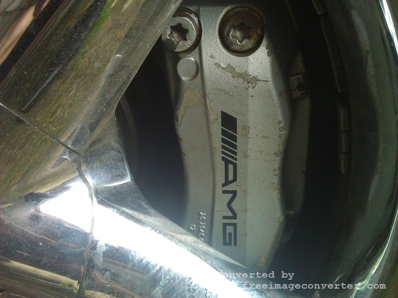

05-21-2013, 01:48 AM #17
(05-10-2013, 07:53 AM)swecias I put AMG brakes to my 190D
http://www.per4m.lt/forum/download/file.php?id=3318
http://www.per4m.lt/forum/download/file.php?id=3317
here is more photos
This post was last modified: 05-21-2013, 01:48 AM by swecias.
