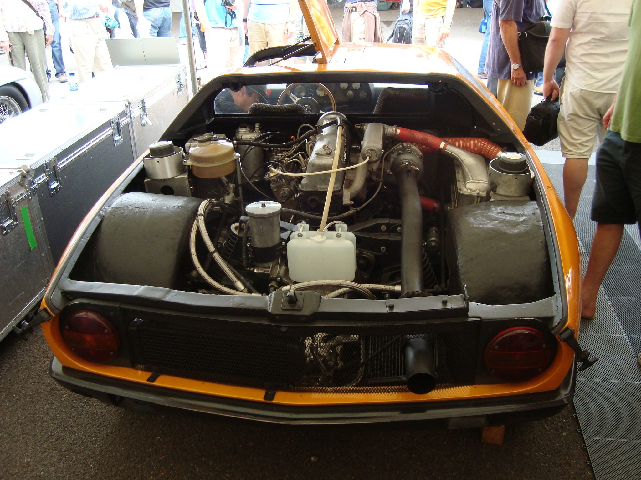

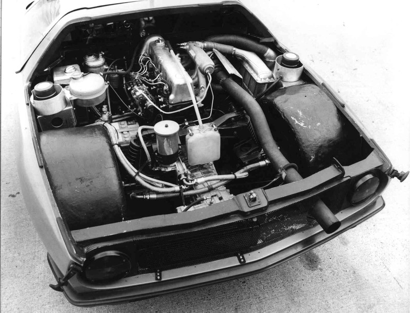

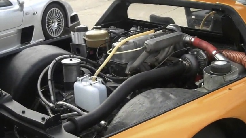

05-12-2009, 11:04 AM #5
Too bad MB didn't put this car into production. Hmmmmm, I wonder where DeLorean got his styling cues from............Angel
So, what can we learn from these engine pictures for our quest to 200+HP?
-Free Flowing Fresh-air intake
-Custom intake Manifold
-intercooler
-is that an M or an MW pump?
-Larger straight-thru exhaust
What we can't see...
- Injectors?
- Pump mods?
- Timing?
I wonder what the average sustained RPM would have been for the trials. It's obvious that these engines are near bullit-proof!!!
OH! Before I forget, most important: Thankyou, thankyou Forced for putting forth the effort to get this great information!!!! CoolBig Grin

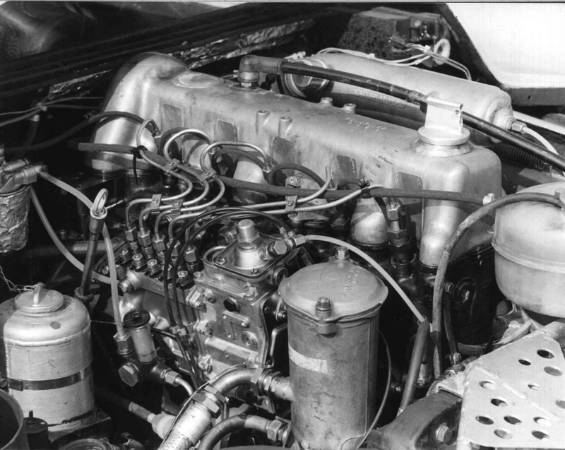

05-12-2009, 11:27 AM #6
(05-12-2009, 11:04 AM)Telecommbrkr -is that an M or an MW pump?
Its an MW, but based on the pictures above showing the smooth sides of the pump case, its definitely not an off the shelf pump. Plunger size, injection timing, etc is part of the "confidential" information the Dr. wouldn't tell me.
Quote:I wonder what the average sustained RPM would have been for the trials.
Assuming "230/600 x 15" is an error meant to be "230/60 x 15", and 215/70 VR 15 means a ~26.5" diameter and with the noted 1.65 overall ratio: 156mph II average- 3200rpm, 186mph III average- 3400rpm and 201mph III top speed- 4200rpm. It makes sense they would run at that average RPM given its right at the torque peak.
They used a nonwastegated turbo and got ~300lb/ft of torque around 3500rpm. I bet if a wastegated, or VNT, were used that the torque could be near 400lb/ft at 2000rpm.

05-12-2009, 02:25 PM #7
Good information, thanks.
I can't believe the head is of light alloy.
Also the tires are not the same seize on front and rear on the photos, but in the list of data.
But I can check this on the car in the museumCool
One day I might give the guy a call, maybe I can get further information.
I heard that they used custom made 6 mm elements and that the next restriction was supposed to be the prechamber.
Electrical fuel pumps? also to be checked on site!
But I think we can do this too and even more using the VTGs.
We will see.

05-17-2009, 05:02 PM #15
I am also noticing a dry sump oil system on both cars. That could be worth some power.
kamel
05-17-2009, 05:59 PM #16
They still have a dipstick though. All the dry sumps I've seen measure at the tank.

01-03-2010, 11:15 AM #18
Hmm....
Looking at those pics, That 'Ally Head' looks suspicously like a Cast-Iron one to me!....
Alastair E
Hmm....
01-03-2010, 11:38 AM #19
They never say what alloy it is. Just because its "light" doesn't mean it has to be aluminum. They could have also painted it.
