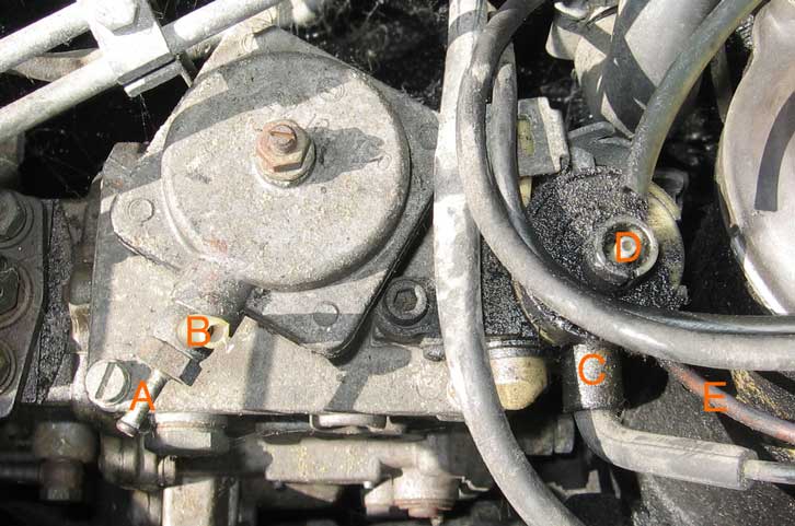

therfore the fuel cut needs vacuum for the engine to start? I have a solenoid I can use to turn it off, so I just need to hook it to the vacuum pump?
there are a few vacuum lines on top of the IP... where do they go? Thanks I am kind of lost on this setup.
[Image: attachment.php?aid=489]
A is boost to ARV - (WHAT IS THE ARV)
B is boost from manifold - ( Front of manifold)
E is shutoff valve i think (NEEDS FULLTIME VAC TO RUN?)
C is vac vent from cabin (NOT NEEDED?)
D is either from the main vac line or to the trans cant remember.(NOT NEEDED?)

(04-08-2009, 11:07 AM)winmutt Fuel cut: vac == shutoff.
ALDA: has no vacuum, that is boost from the back of the intake manifold.

The engine STOPS when vacuum is applied to the fuel shutoff. Are you using a mercedes automatic transmission? C and D can be ignored if your not. The ARV is an emissions device, you most likely want to disable/remove it during the swap, just cap that off or replace it with a standard banjo bolt without the hose nipple.
