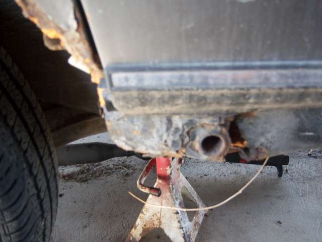

It has sever rust on the undercarriage I don't know if it's fixable yet it's made mostly of ducting zip screws and expanding foam. It was hit in the front and needs a new grill and front bumper but that was about all that got damaged!Big Grin

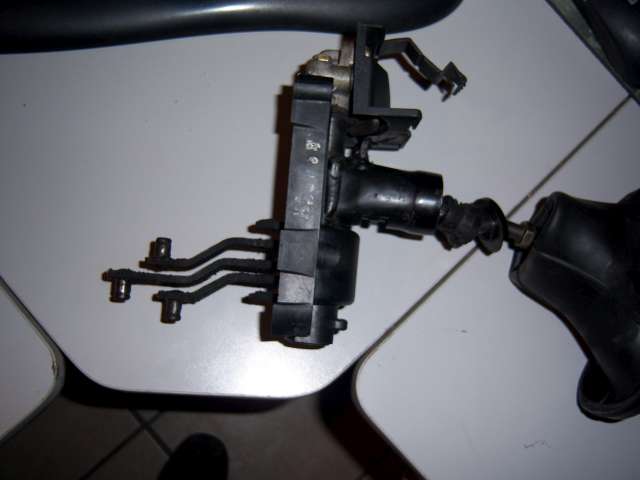

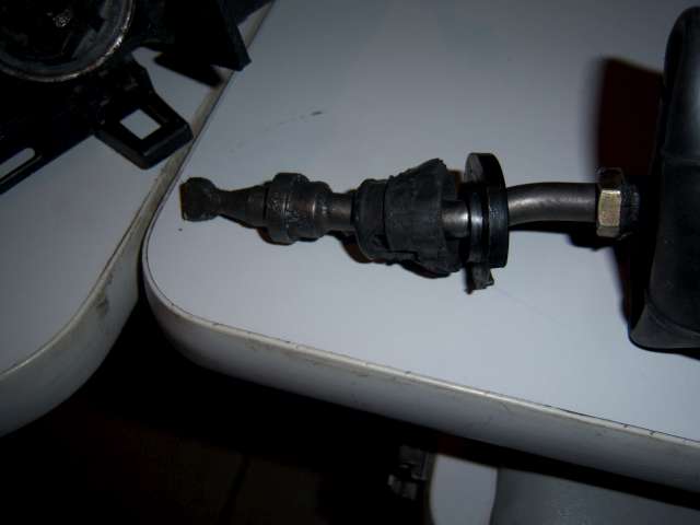

The guy I got it from said it was a getrag it drives nice but needs shifter bushings

I've got the Getrag as well. I can give you the parts code for the lever bushes... they're dirt cheap over here - about 1$

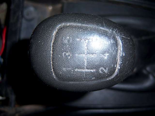

I was amassed it was actually a 5spd!

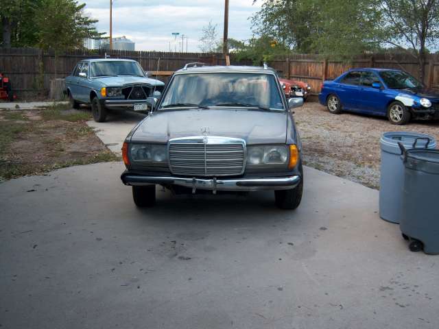

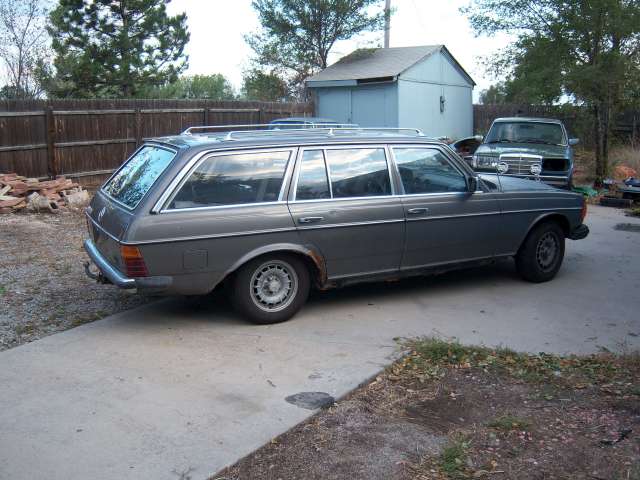

10-09-2011, 07:12 PM #17

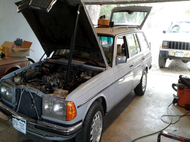

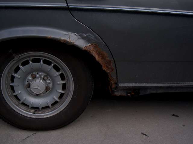

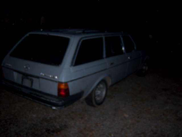

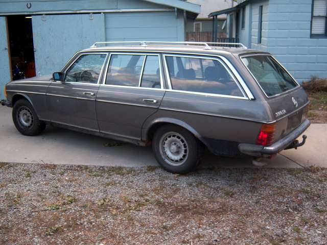

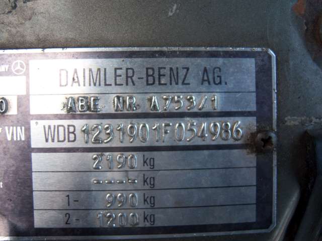

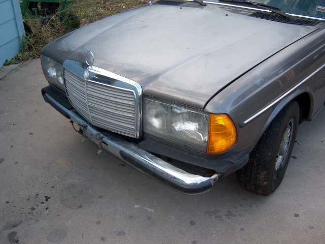

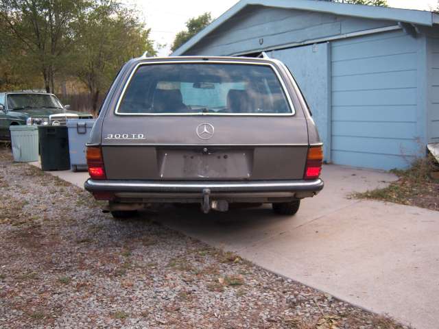

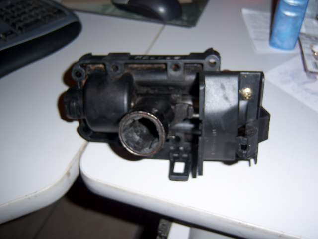

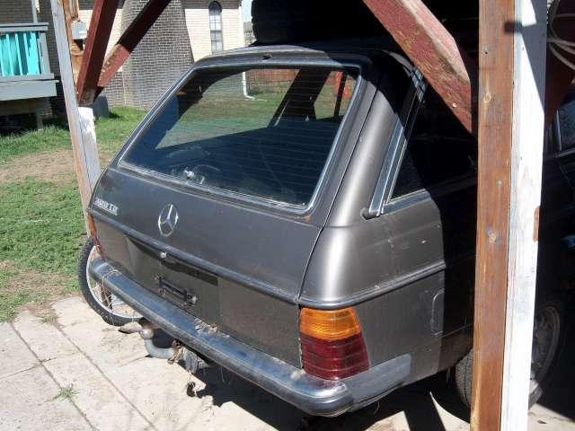

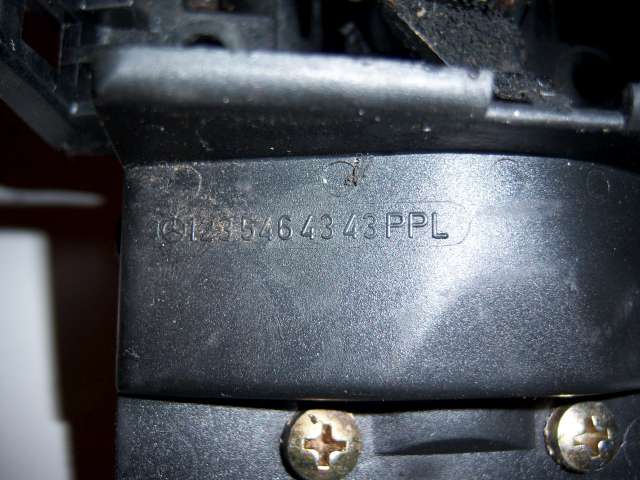

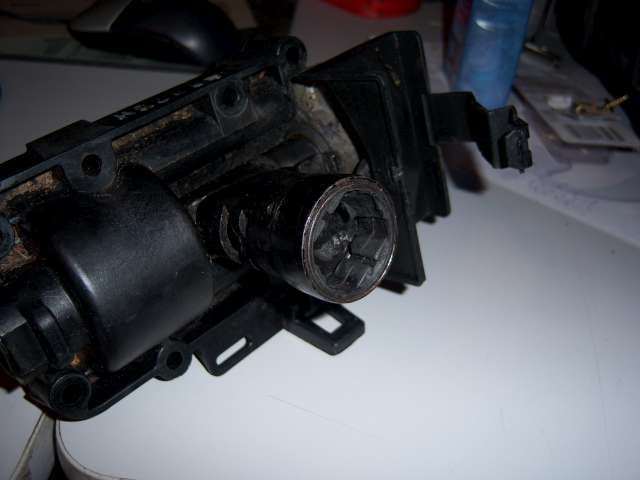

Here are some pics and the vin number

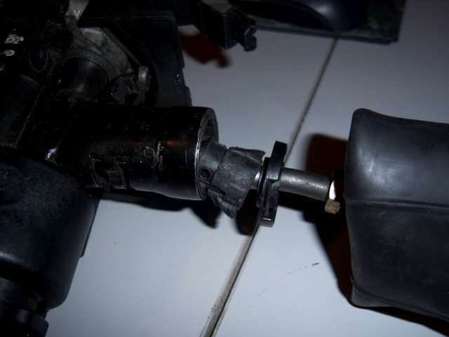

On Saturday I replaced the ignition switch. And it was still dead then I found all of the positive wires where ripped off the starter. So I fixed them and all of my electrical stuff worked except the starter it was still bad. I pull started the car and drove it the rest of the way home then I dug through the crap in my garage and found a spare starter and replaced it. Now it start and runs great. and has almost 3 bar oil pressure when warm!

10-10-2011, 07:22 AM #18
you even have that euro hitch the wagon owners are frothing over!
That car doesn't look near as bad as I thought, but rust repair is probably not going to be fun.

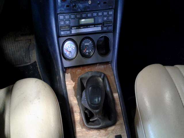

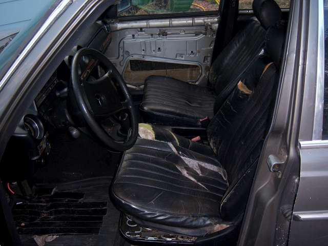

Somebody drove the hell out of that car, i don't think ive seen seats that worn in out of an MB before. That looks like my van seat. Of course, the leather sure doesn't hold up like the MB tex amazingly. I pulled a complete set of leather seats out of my old 300D that were less damaged than that, but still cracked and worn. I wonder if MB had any idea that MB tex would effectively last forever?
This is an awesome find, combined with a rust free body and a turbo motor, this is going to be a fun project

10-10-2011, 09:17 AM #19
The odometer reads 395k and dosent work! But the previous owner said is been broken as long as he's had it and he put at least 30k on it. I found a Mercedes 500km badge in the back of the car!
Anyone know how to decode a euro vin? there use to be a Russian web sight that worked great but its gone now Huh

1985 300td 5spd
fin
vin WDB1231901F054986
whc WDB
chassbm 123190
chass_ident 1F054986
type 123
subbm1 190
subbm2
auxiliary_drive
body 01420
body_code
delivery_date
engine 617912 10 213415
front_axle1
front_axle2
heater
interior 251
lights HELLA
model_idx 0
odometer
order_num1 0521203075
paint1 172
paint2
paint3
paint4
paint5
platform
production_num1
production_order_ref
rear_axle1
rear_axle2
release_date
retarder
rims
service_num
steering
trailer
transfer_case
transmission 717400 00 053440
vin_dc
vinwhc
winch
wiper
Code
212 ELECTRONIC TRACTION SYSTEM (ETS)
233 Unknown
236 SPECIAL LAMP SWITCHING - DAYTIME RUNNING LAMPS
260 TYPE DESTINATION ON TRUNK LID - ELIMINATION
411 mechanical sliding roof
438 Unknown
451 rpm gauge
466 central locking system
532 Unknown
570 FOLDING ARMREST, FRONT
593 ALL-ROUND WD-GREEN GLASS,HEATED REAR WINDOW-ESG,BF

10-10-2011, 10:07 AM #20
1985 300td 5spd
fin
whc WDB
chassbm 123190
type 123
subbm1 190
subbm2
auxiliary_drive
body 01420
body_code
delivery_date

10-10-2011, 11:58 AM #21
(10-10-2011, 10:07 AM)DeliveryValve 212 ELECTRONIC TRACTION SYSTEM (ETS)
646 LIGHT ALLOY 5-HOLE SPOKED WHEEL 8X18
DAM EST & DRL's in 1985?
5 hole spoked alloys 8X18 on a w123?
When I decoded the vin on Benzworld it said it was 1976 gaser

10-10-2011, 12:07 PM #22
(10-10-2011, 11:58 AM)willbhere4u
This place has...
236 - special light wiring, daylight
646 - 7-hole light alloy rims

Today I got an 1984 300TD turbo diesel wagon it's rust free. I got it for $700 the guy told me that the transmission was locking up and would cause the engine to stall. I bought it and replace the fuel filters and drove it home and it didn't stall but it started sputtering so I pulled in to the gas station and filled it up. The gauge read 1/2 tank! It took 17 gallons and it stopped stumbling after I filled upBig Grin
The interior is ruff but saveable and the body is in great shape and Evan has ok paint so this will be the new home of the 5spd transmission and euro bumpers and lights and trailer hitch
I'll post some pics tomorrow

Here are some pics of the 5spd shifter and the new turbo wagon
sorry for the crappie pictures damn daylight savings time Its already dark out Big Grin

11-07-2011, 09:12 AM #34
shit thats pretty different. You ripped that rubber bushing and lost that spring clip? I had the same problem with a 4 speed a while back, looks like almost the same mechansim, maybe the rubber bushing from a 4-speed application could work if its even available? It actually looks just like a 4-speed shifter, at least in that reverse part, maybe one of those would work for parts
However, could you drill a hole down the center of a rubber stopper from a hardware store and make a similar type bushing?
From what I remember, its totally related the reverse lockout, right? maybe you can come up with something, or find something almost the same. I have a feeling that it would be possible to manufacture something that would work almost the same way
That wagon looks great, and thats a beautiful color! I don't understand how you find these cars on craigslist with no rust in CO. Its amazing

11-07-2011, 03:59 PM #35
Most true Colorado cars are not rusty we don't salt the roads like other states
We put down gravel witch chips paint and breaks windshields! your lucks if a windshield last more than a year out here
Both of my 4spd shifters had a nut that held the shifter in place I cant for the life me figure what actually held the shifter in the 5spd assemblyHuh
This post was last modified: 11-07-2011, 04:05 PM by willbhere4u.

11-19-2011, 11:09 AM #36
I finally got all of the parts for the 5spd shifter from Rusty at buymbparts.biz
Turns out I was missing the clip that holds it all together.
I got such a great deal on all of it I even splurged and got a new 5spd shift knob from him for $30

11-19-2011, 07:52 PM #37
I got the shifter rebuilt and back in the car but i got the linkage for 1-2 switched with the 3-4 one so my shift pattern is
3-1-5
4-2-R
I'll have to fix that tomorrow in the day light!

11-20-2011, 11:47 AM #38
With the shift rods in the right order it shifts like a new car

(11-19-2011, 11:09 AM)willbhere4u ... got a new 5spd shift knob from him for $30
Cool! What's the part number on the 5 speed shift knob. I need a new one too!

The shifters is part# 123 267 05 10 and it was $31

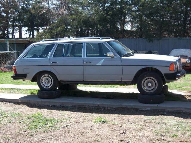

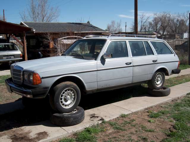

04-05-2015, 11:24 AM #44
I'm finally getting started on this swap after only 4 years of home improvement projects witch are still on going. with our first house. So here's the up date both cars are up on jack stands i am giving the remains of the euro car and its non turbo engine and old auto transmission to my friend for help with the swap. I will be stealing all of the the euro goodness for my new car bumpers lights trailer hitch and all. The American turbo wagon was up first we removed the auto transmission and drive shaft and shifter last weak end this weekend we removed the 5 speed Getrag and other parts and started moving them over to the new turbo wagon. Here are some pictures you can see the extent of the rust in the euro car and that's not even the bad rust I would say about 1/4 of the floor boards are rotted away and reassembled with spray foam and old license plates! I still need to stab the manual transmission in to the new car. My friend has already started putting the rusty doner car back together with the old auto transmission he is building some kind of Apocalypse car out of it for some reason? I just found my spare clutch kit for my old 240d turbo and it looks like the same clutch so I'm going to use it in the 300td.

04-12-2015, 08:04 PM #46
"jackstands" Love it!!
Way to get back on your project after so long.  Dont you hate when normal life gets in the way of your car stuff?  I know I do!!  I think my last will is gonna be nothing but hundreds of projects I was never able to finish in my lifetime  Smile
