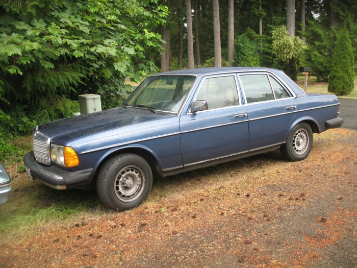

Hello, y'all, this is my first post. I'm 56. I work for a small company which renovates high-end older homes in Seattle.
I bought her in February and then found this forum and so have ambitions of dominating the street, but quietly, modestly, tastefully.
She has 356K miles on the odometer. Seller said the engine was overhauled 100K ago, the IP recently. Windshield, left front fender, and driver's door are not original, so I guess at some point it has been in an accident. Still, it tracks and rides like a Mercedes should, i.e. like a cloud on rails. Color is Nautical Blue with a Fawn pinstripe; she has very little rust, but has been repainted extensively by an amateur. So far, I've polished her as best I could by hand, and fixed several dangling rubber trim strips, and fixed a water leak into the cabin --battery acid had eaten a half-dollar-size hole just aft of the drain hole below the battery. I patched the hole with a Dremel (well, actually a Proxxon, the German Dremel), some GE Premium silicone caulk (the one that smells like epoxy, not vinegar), RustReformer and black spraypaint from Walmart. Installed Sylvania XV headlamps:

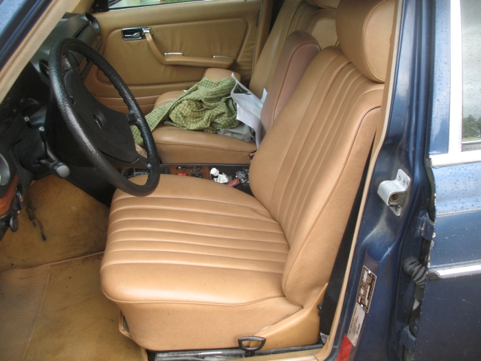

Interior is Palomino MB-Tex and I had the good luck to find some choice quality front seats in the exact matching color. Unfortunately the driver's seat armrest upholstery had come loose, torn, around the armrest's release knob and the shop I took it to for repair (Sure-Fit Auto Upholstery, Tacoma) totally messed it up. DO NOT use this shop!!! So I have taken a replacement armrest from a pull'n'pray, and have obtained some dye which I hope will match the existing seats. There is a small crack in the dash by the right speaker, the vinyl moldings around the windows are heat-warped, and there is an oil spill on the left of the tranny hump, I presume from some kind of accident involving an oil line in the area of the ignition switch. The parcel shelf is badly sun-bleached, and I have had to spend much time making sure all the doors and windows open and close like they should, e.g. replacing small items of hardware. All in all though, I think this one's interior is in much better than average condition:

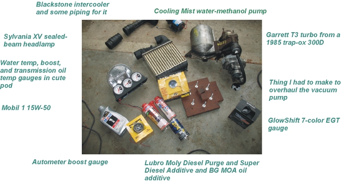

Also, as indicated above, I have a Garrett T3 from a California trap-ox 1985 300D. Plus a "mystery Garrett" from a Volvo, model unknown, which has a 60-trim compressor wheel. Unknown if this 60-trim wheel will fit on either of my other Garrett's (the T3 and the GT2256V), but I intend to find out.
I also now have an M-pump.
Not sure yet, which pump (M or MW) I will go with, and what to do about elements and injectors. Somewhere I saw that setting the pop pressure on the standard Bosch 261 injector nozzles to 130-135 bar, will eliminate nailing.
Somewhere in this mix, I hope to find the sweet combination, the Savoy Truffle, the Wabash Cannonball...
Oh yes, I almost forgot, I also now own a "heated centrifuge refinery," for turning WVO into SVO.

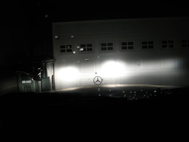

Update on headlights: I must disrecommend the Philips Xtreme Power bulbs. Their high beams are too bright in the yellow end of the spectrum. When it's pitch-black dark, on a moonless midnight out in the rural area where I live, the Xtreme Power bulbs light up yellow warning signs too brightly. I cannot read what the sign actually says until I'm almost right up on it, 75 yards or so from the sign; until then, the sign's black "ink" is dazzled-out by incredibly-intense yellow. Philips has a new bulb called NightGuide which throws a three-color beam: yellow off to the left so as to minimize glare to oncoming drivers, white straight up the road, and blue off to the right. It seems reasonable to speculate that this design may cure the too-bright-on-warning-signs defect of the Xtreme Power bulbs. So my next headlight bulb purchase will be a set of NightGuides.
Well-known lighting authority Daniel Stern wrote a forum post in which he denounced the use of "Bosch motorcycle headlamps," but I believe he must have been thinking of some other headlamp than these Bosch 0 301 600 118's; I attach a comparison pair of photos, against Sylvania XtraVision sealed-beams, which shows the Bosch headlamps' low-beam against my garage door. As you can see, low-beam cutoff on the Bosch lamps is absolutely beautiful --the photo does not do it justice. Parking my car in the right lane of a deserted country road at 1 AM with the low beams on and walking out ahead of it, I see that glare to oncoming drivers is non-existent. On the road at night, low-beam vision is good and is very very good when the yellow fog lamps are also turned on. When the low-beams are perfectly aimed the high beam is just a tiny bit too high, but not by much --high beams are only very slightly "up in the trees" (but, this is not necessarily a bad thing out where I live). Overall, I deem that night vision (with the Xtreme Power bulbs) is quite acceptable *except* for the too-bright-yellow-in-high-beams-on-warning-signs problem; after having driven for the last 6 months with the Sylvania XtraVision sealed beams, driving at night now with this Bosch + Xtreme Power combination is pure bliss, as long as I'm not coming up on a yellow warning sign. Hopefully, the Philips NightGuide bulbs will cure the warning-signs problem and will give equal or better straight-down-the-road lighting as the Xtreme Powers. We'll see.
I also found today, a pair of Cibie 7-inch round H4 headlamps, I pulled them from a 1967 European 230 fintail. General consensus of opinion, from what I find on the 'Net, is that Cibie's are the best H4 headlamps ever built by the hand of man, with the possible exception (just maybe) of Marschal lamps, but...both reflectors are badly rusted. One of the Cibie's glass face has a small rock hole near 12 o'clock, the other's glass face is nearly flawless, just a few dust scratches. Can anyone tell me if it is possible to re-chrome the reflectors?
Sylvania XtraVision 7" round H6024 sealed-beam low-beams (non-existent cutoff):
Bosch 0 301 600 118 H4 conversion headlamps (so-called "motorcycle headlamps") with Philips Xtreme Power 9003xps2 bulbs, low-beams (excellent cutoff):
