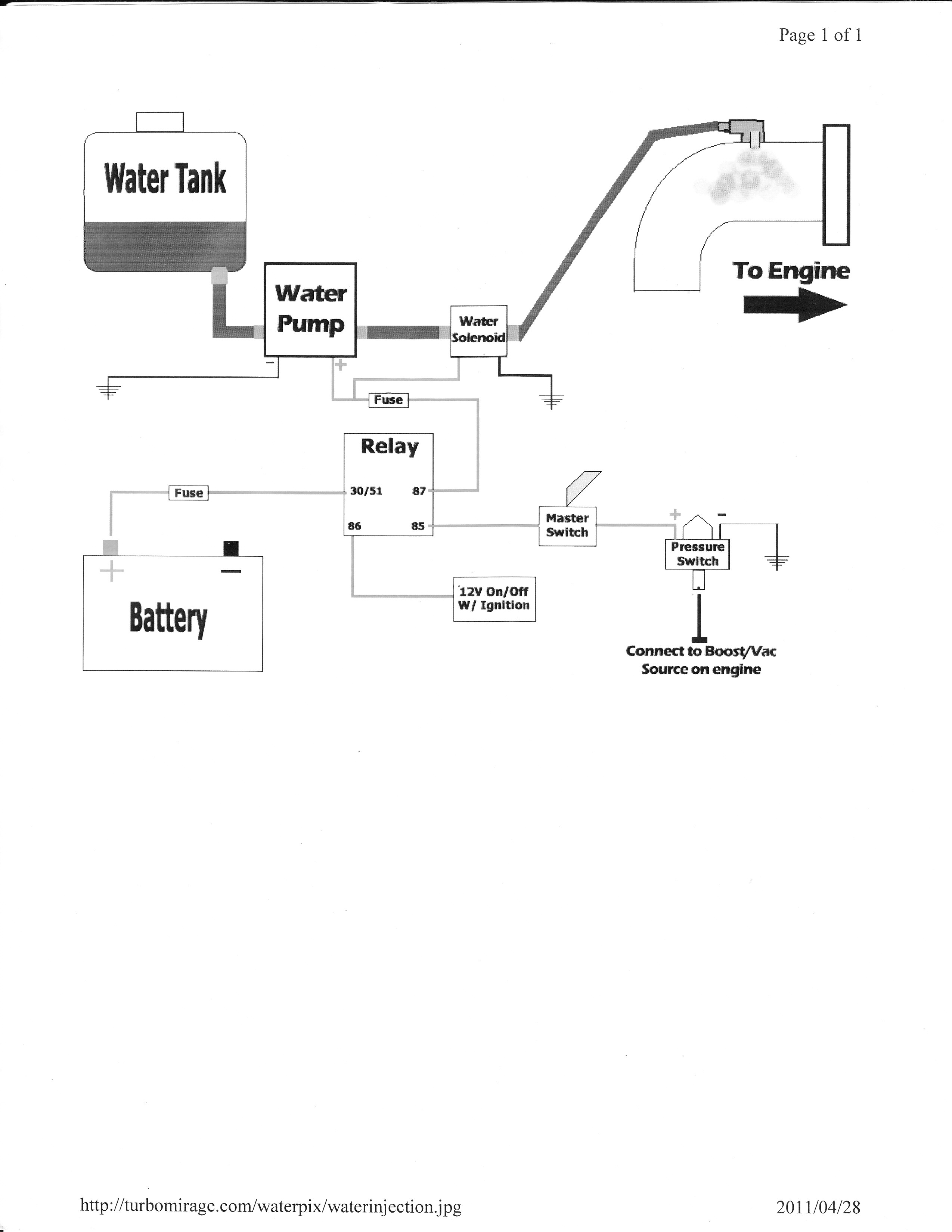

04-20-2011, 08:38 AM #7
Actually, a little lost. What will crack? I got the need for a pump, and the check valve for flow OK (why do you need this??) and, what triggers it -- the nozzle to get a flow or to operate? Vacuum from the turbo? My turbo has the ARV (or whatever you call it). Can I go into that somehow with the nozzle?

04-20-2011, 09:03 AM #8
http://www.alcoholinjectionsystems.com/W...index.html
so it is one way. And also needs 22psi pushing in the right direction to open. If your turbo is
turbo <---check valve (this will 'crack')<---- pump <---reservoir
so the turbo will be sucking on your system just like it is sucking air in from the air filter. I guess the location should be further from the cylinders. I was think of moving mine further back in the snail as I mentioned before.
A previous member here at std said that moving the nozzle back to that position from just 3 in. closer to the manifold.

04-20-2011, 09:46 AM #9
OK -- I understand the theory by your flow chart. Thanks!!!!
BUT, where would be the best place or the place that folks have success with. The ARV is in the way on my turbo, or should I figure out a central spot on the intake -- I have the "log" type and not the W115 type yet. So, is it better to be closer to the air filter side of the turbo or closer to the intake manifold side?
So, the amount of vacuum -- PSI -- is the trigger.
So, once my line makes it to the engine bay, I will need a
1. Pump - high pressure 100 psi plus
2. Nozzle
3. Line & Fittings
4. Pump since I am not perfectly gravity flow -- some uphill
5. Anything else ???

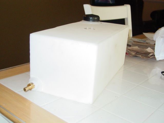

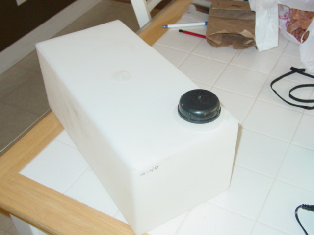

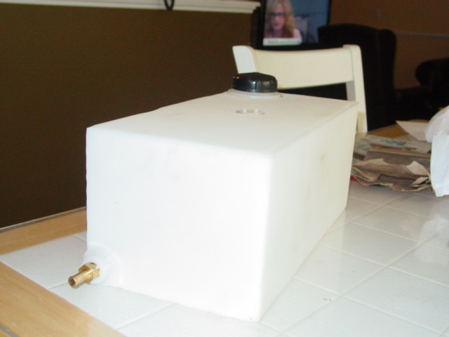

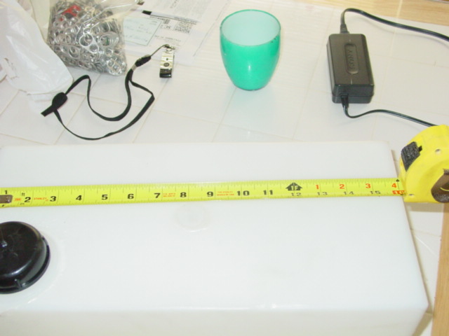

Also, found a great place where you can get a "custom" poly container. I got a 16" long x 8" wide x 12" high tank on order and they will insert up to 3 fittings free. The tank is under $40 and shipping is around $15.00. I will post the specifics when they call me back. They are located in ID and OR, called Roto-Custom Plastics. Seemed like nice folks. So, for around $55 I can get a 6 gallon tank that will fit perfectly in the other side compartment in the trunk. This will balance out nicely with my battery box. Got a really simple design for the bracket & holding straps.
So, for under $100.00 I can have a 6 gallon container, bracket and straps, hi-pressure nylon tubing 3/8 x 25' and intake manifold ready to go. Just need pump, fittings, and switch. I found one that is activted 2-10 PSI.

1.Yes, i have WI in three cars, two diesel and one petrol.
2. Yes, it has been bulletproof, my daily drive had zero issues, it worked thru the cold winter (-20 - -35C here very long periods).
3. One nozzle is really the best way and after turbo. If you install the injector far away from cylinders it affects more as and air temp lower and closer to the cylinder more as an extra fuel.
4. Pressure sensor that activates the pump
5. Yes me like, no way i'm going back to not having WI Big Grin

To Captain America, Water meth with a modern pump and small nozzle in the right place will atomize to a lower micron than your air filter will clean. If you don't want the power, and have a decent intercooler, it is probably not for you. The closer the nozzle is to the intake manifold, the less chance it (methanol) has to cool the air. Mounting the nozzle in a place with little turbulence is the most important.
To yankneck696, SAAB did pre-turbo with a washer pump, and noted a 200K mile life on the turbo, meaning yes, there was wear, but the turbo would need to be replaced at 200K miles. That was with a washer fluid pump and nozzle in the 80`s. Current pumps are up to 200-250 psi, and nozzles have greatly improved in even the past few years.
(04-19-2011, 08:54 PM)Greazzer 1. Has anyone installed a W+M system?
2. Does it work perfectly everytime?
3. Does one install the nozzle at the turbo or is there 5 seperate nozzles for each lead into the manifold.
4. How do you set up an automatic "trigger" to activate the system, e.g., hitting 2,000 rpm's or certain PSI from the turbo or a certain speed?
5. For those that have a W+M system, do you like it?
1. Yes, but not on a diesel yet
2. Unless I don't have fluid in the tank, or once in a blue moon when the power isn't flowing right.
3. Direct port, the terminology for into the manifold will have drawbacks. If one nozzle gets clogged, you have no way to tell unless you pull the nozzles periodically to check. Even with a flow sensor the difference in overall flow might be negligible. Unless your IM has distribution problems, you should be fine with a single nozzle.
4. Hobbs switch for boost activation, some will use the kickdown signal. You could use a WOT switch from a nitrous company, you could buy a progressive controller that uses a boost feed or map sensor signal to control the flow automatically, or just wire up a switch to power the pump on.
5. A diesel will take water/meth differently than a gas, but the results I have seen on the Devil's Own forum are nice, and several people have installed basic kits to keep WVO remnants from causing problems in their engine.
You were asking about pumps. There are several pumps out. Made by shurflo and recently aquatec. YOu can still get shurflo pumps at academy or places where RV parts are sold. They will pulse, which will lead to inconsistent flow and spray pattern from the nozzle. The aquatec, and some shurflo (was offered by AEM Electronics for a little while, and wish I could find one because the aquatec pump is just big enough to not fit where my old 100 psi shurflo pump is at) pumps are recirculation pumps, meaning that they do not pulse, and can keep a preset pressure and flow without problems. Because you are not in it for the performance, and won't be "tuning for it", meaning your tunes relies on the mix, any pump should be fine, as long as you understand that most nozzles are made to atomize at 40+ psi, and that whatever boost and check valve(solenoid doesn't count) will have to be subtracted from your pumps pressure. Meaning 22psi check valve plus 20 psi of boost makes a 100 psi pump a 58 psi to the nozzle pump. Multiple nozzles will also cause a reduce in flow, which is why DO(Devil's Own) and others recommend using the more beefy Shurflo 220 psi pump for direct port installations. It is beefier than the 100 and 150 psi shuflo and the new 150-250 psi aquatec.
Last, be careful of running dry with that big tank. If you are mounting it so that the longer of the two (length and width) is parallel with the length of the car so that acceleration pushes the fluid back to the pump pickup point you should be fine, but if you notice that when the tank is low you lose flow, you might want to look into a surge tank. A small tank below the big tank fed by gravity with a vent hose on top of the smaller tank fed back to the top of the larger tank, or a tank mounted up front fed by the rear tank fed by a washer pump.
This became a novel, but hope it helped.
