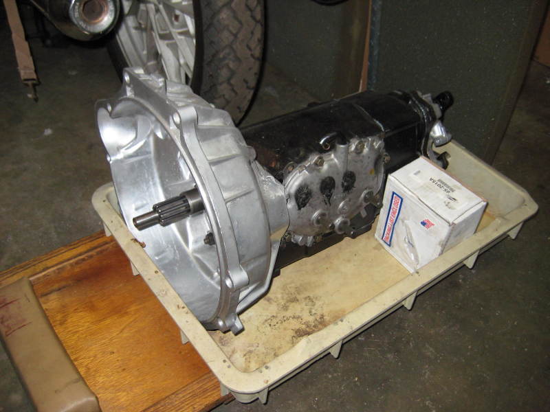

01-22-2009, 07:06 PM #3
so what is the one in the pic? The guy says it is from a 72 220 is that a 4 speed it looks like the bell is removable and I coul make a adapter to put a nv3550 behinde it

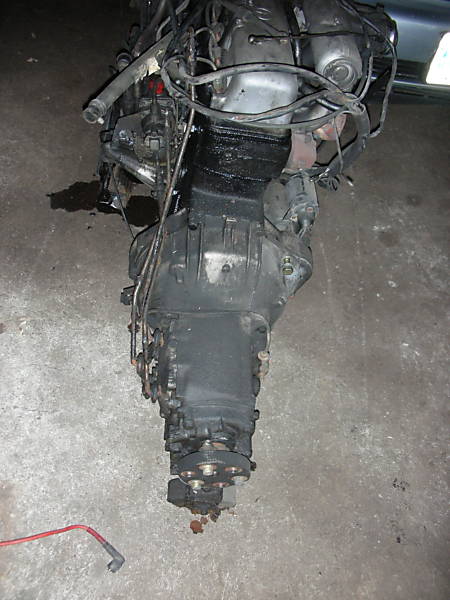

01-23-2009, 05:10 AM #4
Thats a run of the mill 4-speed. The bell is removable.

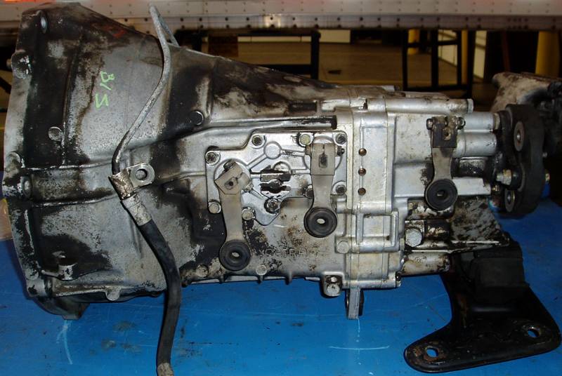

The two 5-speeds that will work look like this-
Iron early style:
Aluminum later style:
Iron early style:
