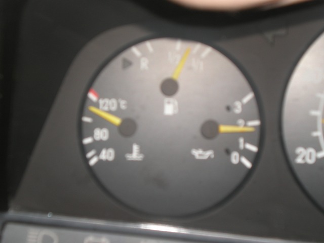

11-02-2010, 07:06 PM #4
the car is running just above or below 100c at all times, which is too hot. Interestingly, it gets cooler when you push it, and hotter when you back off.
Running up some fairly big grades, it crept down to 95c, and on the downside, moved up to 105c.
Ive got a water pump coming anyway, but Im thinking that the water pump impeller is eroded or loose on the shaft or something, any thoughts?

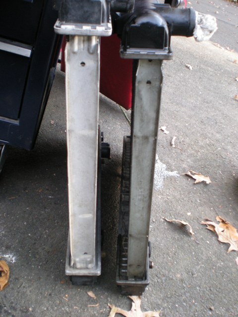

11-21-2010, 05:34 PM #7
to continue with this saga-
original temp sender read cold, 50C.
Replaced it with spare temp sender out of parts engine, which immediately read hot, around 100C
Replaced it with brand new sender, which read colder, 45-50C
Replaced THAT with KNOWN good sender out of my 240, and it read hotter, 105-115C! That seems to be the most correct temp, as I verified it with a temp gun a few times, the engine is running at between 230 and 240 degrees F when its up to temp.
During all this, I discovered that the no name radiator in this car is about 1/2 inch thinner than another nissens 300D radiator I have, so I swapped them. heres a pic of them compared-
I also replaced the water pump, flushed the coolant a few times, checked that little bleed line above the water pump, pulled the entire water pump housing out and looked for blockages, same with the thermostat housing, did the same with the radiator, checked my new thermostat and will maybe replace it again, ect. maybe there is some huge blockage in the block or something?
Every single thing I do, the engine runs a little hotter every time. Theres no head gasket problem or anything (yet), and the coolant is not leaking or otherwise disappearing, it just runs REALLY hot. ie-
Now Im going back to possible faulty parts, or maybe a faulty gauge now. Any suggestions would be much appreciated, this is annoying me

11-21-2010, 08:44 PM #8
Take a digital meat probe thermometor and stick it in place of the sendor, using a compression fitting and various adapters to the right thread style. Use that to verify if you have an overheat condition or not.

11-22-2010, 02:07 AM #12
(11-21-2010, 05:34 PM)dropnosky original temp sender read cold, 50C.
The sensor is $12 and it lasts 20+ years, just buy one. Its one of the first things anyone should do when buying a 10+ year old car.
Quote:During all this, I discovered that the no name radiator in this car is about 1/2 inch thinner than another nissens 300D radiator I have, so I swapped them.
The thinner one is from a non-turbo 300D.
Quote:Now Im going back to possible faulty parts, or maybe a faulty gauge now.
You verified the gauge with your thermometer.
Have you bled all the air out?
Is the water as hot as the engine? Does the radiator get hot? You may need to do a good acid flush to get rid of scale in the block. The problem with using an external thermometer is its reading the metal temperature surrounding the water.
This post was last modified: 11-22-2010, 02:09 AM by ForcedInduction.

11-22-2010, 07:55 AM #15
(11-22-2010, 02:07 AM)ForcedInduction The sensor is $12 and it lasts 20+ years, just buy one. Its one of the first things anyone should do when buying a 10+ year old car.
I did order a new sender after the spare was so different from the original. The reading on that one was unusual, and extremely low.
The radiator and upper hose are all heating up like normal, and aside from the consistent high mark on the dash, everything feels correct temp to the touch in the engine bay, not way too hot, and its completely bled of air.
This is whats making me doubt the gauge and maybe the temp gun I borrowed. Im going to check the thermostat again, then attach another gauge and see if I can verify the stock temp gauge reading.
Everything appears clean in the coolant passages as well. A citrus flush is a good idea, ill put that on the list. I did several hose flushes and the water came out pretty clear.

11-24-2010, 06:52 AM #18
(11-23-2010, 10:59 PM)ben2go Big if,the coolant is over heating.Have you checked the fan and fan clutch?Or is that fan direct bolt on without a clutch.Is the fan shroud in place and in good condition.I'm just tossing out ideas.You are already doing everything I would do.Do you know anyone that would loan you an aftermarket gauge to compare your dash gauge to?
Im going to replace the thermostat again, maybe its faulty, later in the week. This guy over on PP had a really interesting idea, since I have the car parked directly next to the parts car, he was saying make a common ground between both vehicles, and run the temp lead from the one car over to the other and use the other gauge! I might try that, I know the 240 gauge to work properly
EDIT- While I was on the road today, I picked up a 15 dollar sunpro temp gauge as well just in case the thermostat is not the problem. Im hoping to drive the car like 700 miles in a few days, can't be running that hot! I can't believe how cheap those things are!
This post was last modified: 11-24-2010, 02:12 PM by JB3.
