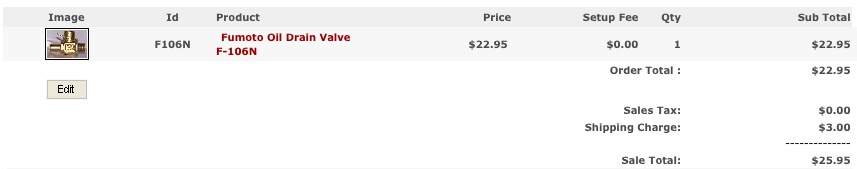

I just ordered one also, but I paid 27 bucks! I guess you are a lot closer to the shipping location.
Im banking on the idea that the rear facing drain at an angle will mean this thing will not hang down enough to really be at that high a risk, but I also don't have a skid plate, so we will see. They make the claim that it only is 1/2 inch longer than a normal drain plug.

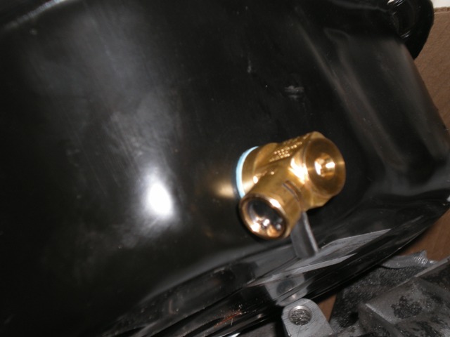

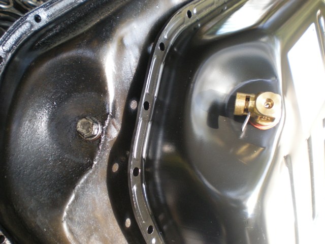

10-23-2010, 12:46 PM #14
new pan arrived, and its all installed. The valve works perfectly on a 617 oil pan, nice and tight is straight up. It does stick down a little more than the drain plug, and as you can see from the damage I already had on my car, that there is some additional risk to having this on there, but I think pretty minimal.
Eventually I think I will add some protection down there as well, ive replaced the lower pan on every diesel MB I have ever owned, yet I have never bottomed out on one (knock on wood)
Works great, I tested it with some water earlier in the other pan, Ill post back the next time I have to do an oil change with it.

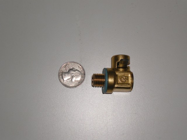

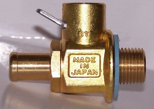

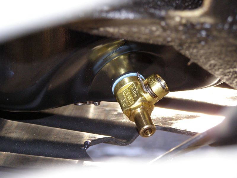

10-24-2010, 09:05 PM #17
(10-23-2010, 11:32 PM)ForcedInduction Thats why I got one with a nipple, so it will drain clear of the skid plate.
do you have a pic of how it looks with the nipple?
10-24-2010, 09:13 PM #18

10-26-2010, 02:35 AM #19
1. FI where did you source that from??
2. How 'well' does the valve stay put??
3. And??? what about being able to then connect an attachment to help 'suck' out all the oil from the engine?? I know some shops advertise something along this line but I'm not exactly sure how it works.

10-27-2010, 05:40 AM #21
(10-26-2010, 02:35 AM)Silberpfeil 1. FI where did you source that from?
What, the picture? Pretty much every place that sells them has it.
Quote:2. How 'well' does the valve stay put??
The same as any oil plug.
(10-27-2010, 12:43 AM)300D50 Most "suckers" pull from the dipstick and leave anywheres from a cup to a quart+ of old oil depending on how far down the dipstick goes.
If you actually look at the oil pan and how the drain plug is placed, there is a lot of oil left no matter how long you let it drip or if you put the front wheels in the air. The only way you'll get all the oil out is to put a line into the hole and suck out the rest, which is exactly what a dipstick sucker does without having to get under the car or pull the plug.

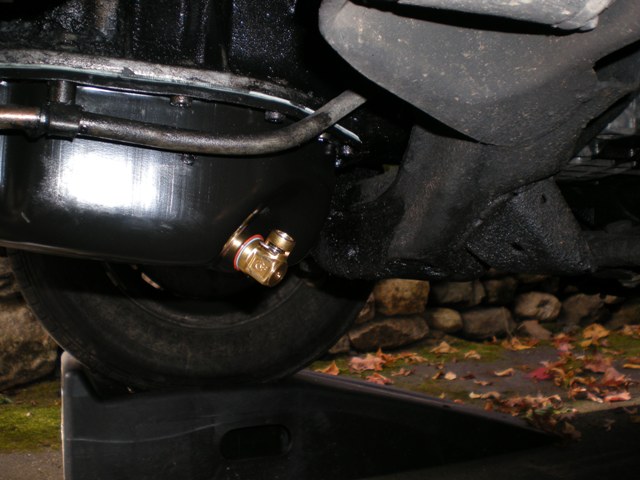

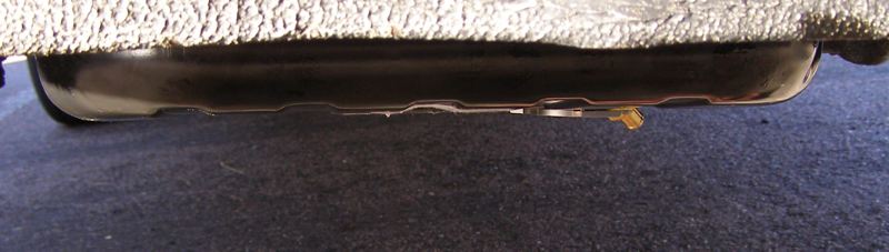

10-30-2010, 10:43 PM #23
The new pan, fumoto and skidplate are in.
Without the plate the nipple version hangs too low. Even the non-nipple version would hang down lower than I'd be comfortable with.
With the skidplate there is plenty of room. That silver piece is a neodymium magnet from a hard drive to help catch any wear metals before it goes into the pump.

10-30-2010, 10:56 PM #24
wow, that works perfectly with the skid on there!
I just discovered another great feature to these things, I overfilled the oil accidentally topping it off, and resolved that problem by draining it down in seconds without actually getting dirty. I drained it into a water bottle I had. (another reason to go with the nipple if you have a skid) A nipple would have been even easier to use
