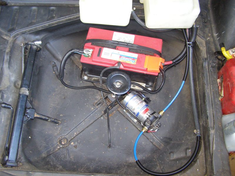

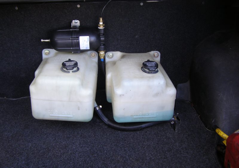

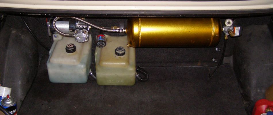

The rear half of the system is now complete. I'm only waiting on the nozzles and solenoids to arrive.

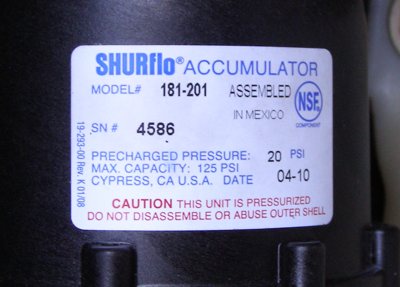

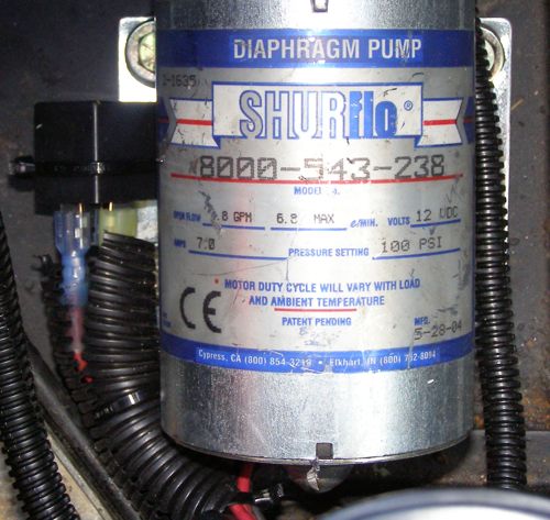

Its got a Shurflo 8000 pump set at 110psi and a model 181 accumulator which I will charge to 95psi when the system is complete. The two reservoirs are 1.5gallon coolant expansion tanks from 90's Chevy pickups connected in parallel. The pump power is controlled by a dash-switch signaling a relay by the pump. The pump tubing is 3/8" inlet, 3/8" to the accumulator and 1/4" from the accumulator on.
They are filled lopsided because the car was on a slope when the picture was taken.
The plan is 6x70cc/min(1gph) nozzles which is right about double the capacity of the system I use in the 240. One nozzle in the manifold inlet activated at 4psi, primarily for keeping the cylinders carbon-free during normal driving. One nozzle in each of the W115 manifold's runners activated at 10psi for additional power and heavy cylinder scrubbing.
More to come, hopefully soon.

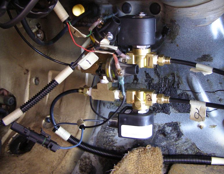

07-28-2010, 06:57 AM #10
Finally.
I had issues with the valves. The becooling ones are crap, one body cracked with the water pressure. For the same $50ea as online WI places wanted, I got a pair of Parker K family valves from a local hydraulic shop.
I'm also having an issue with the accumulator's top fitting sweating water past the threads. I can't tighten it any more without the risk of cracking the plastic.
The two Hobbs switches work well, but they don't have any amount of hysteresis so I had to set the pressures a little differently than I had planned (3psi and 8psi instead of 5psi and 11psi).
The blue wire is to the pump relay and the green and red wires go to indicator LEDs on the dash.

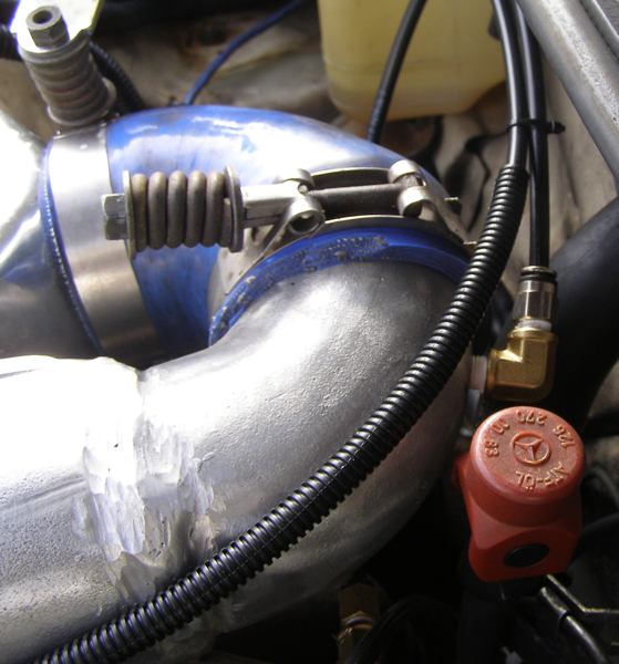

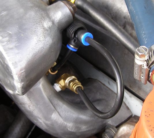

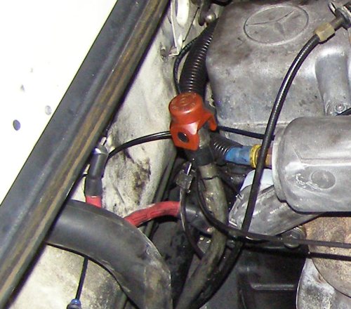

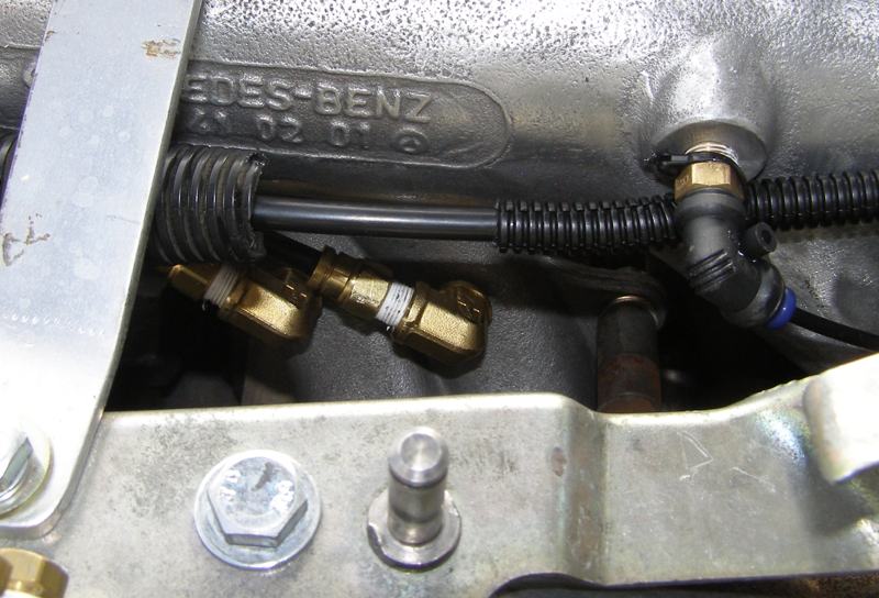

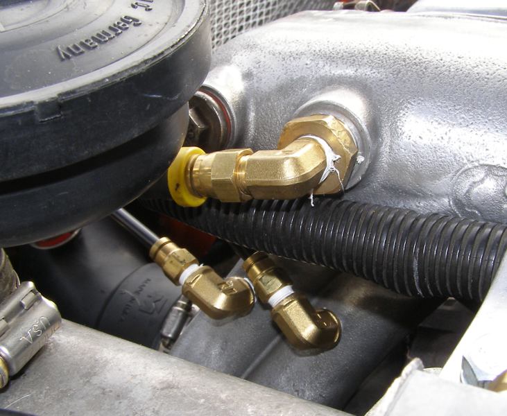

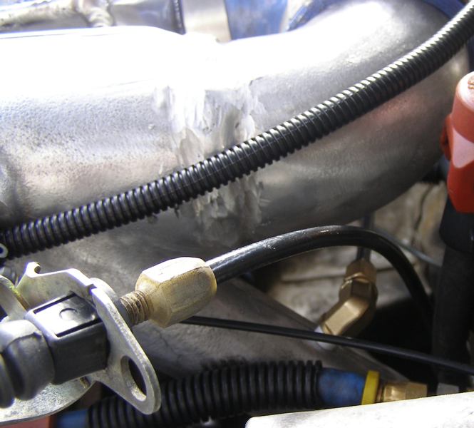

There isn't much visible engine side.
Stage 1 at the manifold inlet. It works well for cruising cleaning, but I already feel it could be doubled in flow.
#1 of the second stage.
2-3, boost gauge/pressure switch fitting.
4-5, VNT control fitting. It was a tight fit, I couldn't avoid a U on the end.
Haven't done a 0-60 yet but it does give a nice kick. Waiting for an email back for a dyno session.
Finally.
Peak EGTs remain unchanged, which I'm sure is due to the long duration of the 5.5mm injection pump elements.

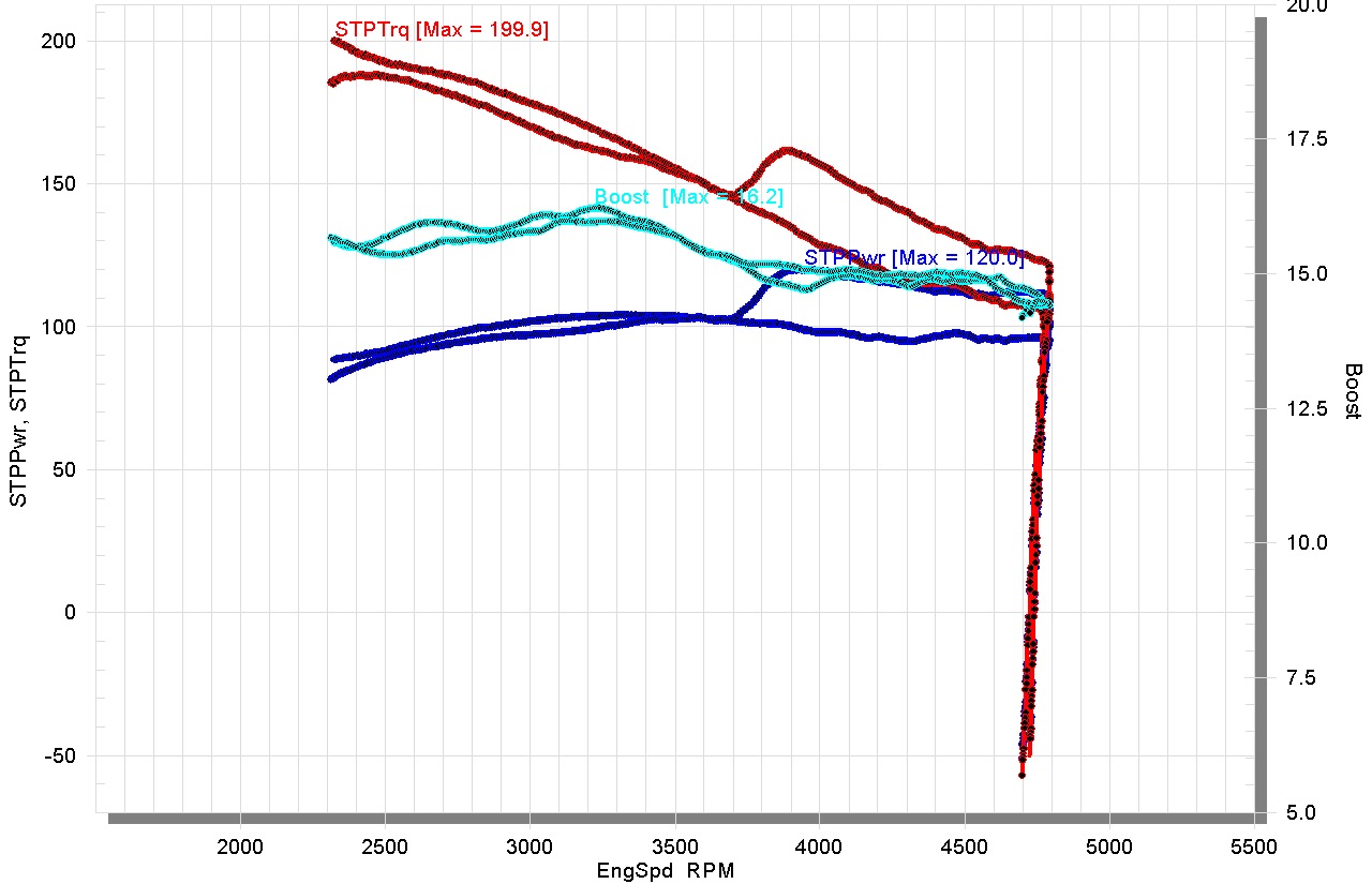

I'm pretty displeased with the dyno operator this session. Not only did he have issues maintaining a reliable RPM reading but he just wouldn't put the throttle all the way to the floor even though I told him the kickdown was disabled.
Out of 6 pulls, half of them he didn't give it more than 1/2 throttle until 3500rpm and only one was partially valid. After Bandimere next week I'm going to find a better dyno shop.
Still, with the usable data, it shows 13hp over last year's non-WI run and bested my previous torque even without full throttle. A 0-60mph test shows .4sec quicker.

10-23-2010, 11:14 PM #21
Updated the 240D to the new tank system. I left the pump in the engine bay and it has no problem sucking water through the 17' of 3/8" tube once it was primed. This eliminates unnecessary stress on the hood cable in cold weather to check/fill the water and adds another 1.5 gallons capacity.
