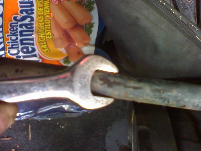

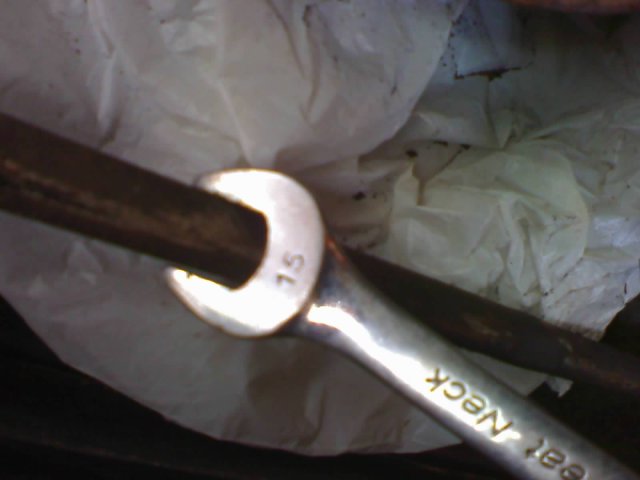

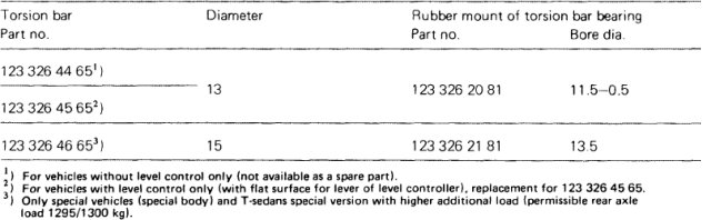

I am happy to announce the STOCK sway bar on the 126 is 15mm AND its the same as the 123 (just bigger). AND BETTER YET!!!! Behold the 17mm sway bar! The 17mm requires different mounting holes which requires poking some holes through the U/box channels. No easy task but wow what a bar. It also requires some type of bracket to connect to the sway bar links, honestly probably way overkill. It was found on a 500SEL with SLS and oddly enough no springs.
[attachment=1]<!-- ia1 -->04-19-08_1149.jpg<!-- ia1 -->[/attachment]
[attachment=0]<!-- ia0 -->04-19-08_1147.jpg<!-- ia0 -->[/attachment]

04-20-2008, 05:36 PM #6
Wrong!
The W126 sway bar will not interchange with the W123. I pulled the rear sway bar out of 2 W126s at the yard today and compared them, they were the same between a Euro 280SE and a 300SEL. I bought one and came home and pulled the bar out of my 240D. The W123 bar is about 2 inches more narrow than the W126 bar both at the Z bends where the mounts to the body are, and at the ends. I tried stuffing it in anyway, but the bracket mounts on the W123 are indeed to narrow.
Now I have to go put my old one back on. :|
Edit: my stock bar seems to be 13.5mm because I can not get a 13mm wrench around it, but a 14mm fits with a tiny bit of slop. Also both W126 bars seem to be 14MM, not 15, as a 14mm wrench will fit around it tightly. (Notice the gap between the 15mm wrench and bar in the picture above.

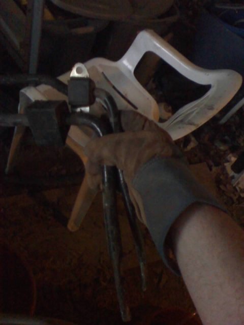

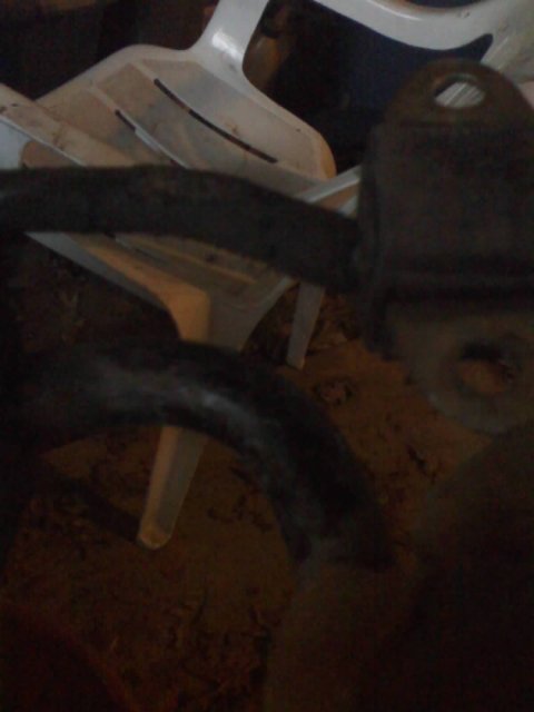

Left camera at home yesterday side by sides of the 17mm vs 13.5mm tonight. The wierd bit is the car I took it off of had no rear springs. Just SLS and this sway bar.

04-23-2008, 07:20 PM #12
Here is the W123 13.5mm vs W126 560SE/SLS 17mm bar:[attachment=1]<!-- ia1 -->04-23-08_2009.jpg<!-- ia1 -->[/attachment][attachment=0]<!-- ia0 -->04-23-08_2010.jpg<!-- ia0 -->[/attachment]
I agree whole heartedly that this is something anyone with access to a torch a vise, a bit of pipe and a drill press could fabricate. The 17mm mounts bushings are twice as large give or take as the stock ones and will require special drilling. I think if we can get 15mm smooth stock it should be a no brainer with even a cheap torch. I do believe that the longer the ends means for the slower travel and a smoother ride. Who can find stock? I will make a 15mm with variable length ends.

05-10-2008, 04:31 PM #23
I think an R107 bar may be close to what we need but they are very rare in the parts yards.

So disappointed. Wrong part came in. I got the TD bar. For future reference:
[attachment=0]<!-- ia0 -->swaybar.jpg<!-- ia0 -->[/attachment]
05-20-2008, 07:39 PM #32

Now the geeky part, unboxing!
[attachment=2]<!-- ia2 -->LMN 15mm sway bar unboxing1.jpg<!-- ia2 -->[/attachment]
[attachment=1]<!-- ia1 -->LMN 15mm sway bar unboxing2.jpg<!-- ia1 -->[/attachment]
[attachment=0]<!-- ia0 -->LMN 15mm sway bar unboxing3.jpg<!-- ia0 -->[/attachment]
[Image: LMN%2015mm%20sway%20bar%20document1.jpg]
I'll hog out my spare 13.5mm bushings to fit it and probably install it this weekend.
