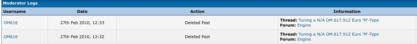

02-27-2010, 03:17 PM #10
Wot on earth happened in this thread.....??
Where are the various Posts by 'OM.616' gone...?--He was the guy as far as I know, who first started adjusting up the N/A engines, and brought it out in forums....
Did he himself delete them...? Or did someone take exception to something he said....
--From what I recall, There was nothing in any Post that could have caused offence....
Worth remembering, Excessive 'Censorship' is the Death of Democracy--And Forums!
Alastair E
02-27-2010, 06:49 PM #11
(02-27-2010, 03:17 PM)Alastair E Did he himself delete them...? Or did someone take exception to something he said.
He removed his own posts.

(02-27-2010, 06:49 PM)ForcedInduction
That is only two, tell them what happened to the third.
Many regrets for the pissing contest, not my proudest moment. I am too old for this.
OM616
02-28-2010, 04:13 AM #12
