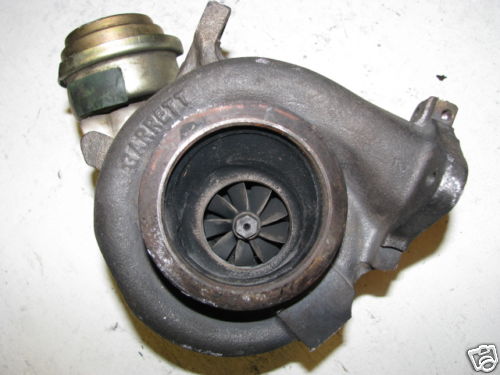

05-08-2008, 09:07 AM #60
I think my chinese loan from the gubment might buy me one of these: <!-- m --><a class="postlink" href="http://cgi.ebay.com/ebaymotors/ws/eBayISAPI.dll?ViewItem&category=33742&viewitem=&item=180239830296&_trksid=p3907.m29">http://cgi.ebay.com/ebaymotors/ws/eBayI ... =p3907.m29</a><!-- m -->
$60 for shipping.

05-08-2008, 12:56 PM #61
ForcedInduction The liberty is also a 4-valve engine. I'd be willing to be that the R 428 DOHC flows much more air at 4300rpm than the 617 does at 5000rpm.
I hope you are right. The problem seems most pronounced in first gear when the Revs come up really fast so I think the issue may be the pressure actuator not responding quickly enough.
Winmutt-
That looks like a good buy. Is that a T3 inlet flange?

05-08-2008, 04:14 PM #62
bgkast That looks like a good buy. Is that a T3 inlet flange?
Looks like it. Maybe t4 T25 something I can find a cheap adapter for. I am waiting to pull the trigger until I hear more feedback from you. Are you going to be working on it this weekend? Auct ends in 3days.

05-19-2008, 02:48 PM #77
There is a part # 35242115F Liberty turbo listed on ebay currently: <!-- m --><a class="postlink" href="http://cgi.ebay.com/ebaymotors/GARRETT-TURBO-35242115F-763360-1_W0QQitemZ270238076314QQcmdZViewItem?hash=item270238076314&">http://cgi.ebay.com/ebaymotors/GARRETT- ... 238076314&</a><!-- m -->
The only difference between it and the other version of the liberty turbos seems to be the pressure actuator. Because of this I believe that all of the liberty turbos are GT2260Vs! :mrgreen: :twisted:
Also looking at this picture of a sprinter GT2256V it does not look like the exducer of the turbine is any larger than the Liberty turbo's, it just looks like the GT2256 uses a larger V-band on the turbine outlet.
bgkast
