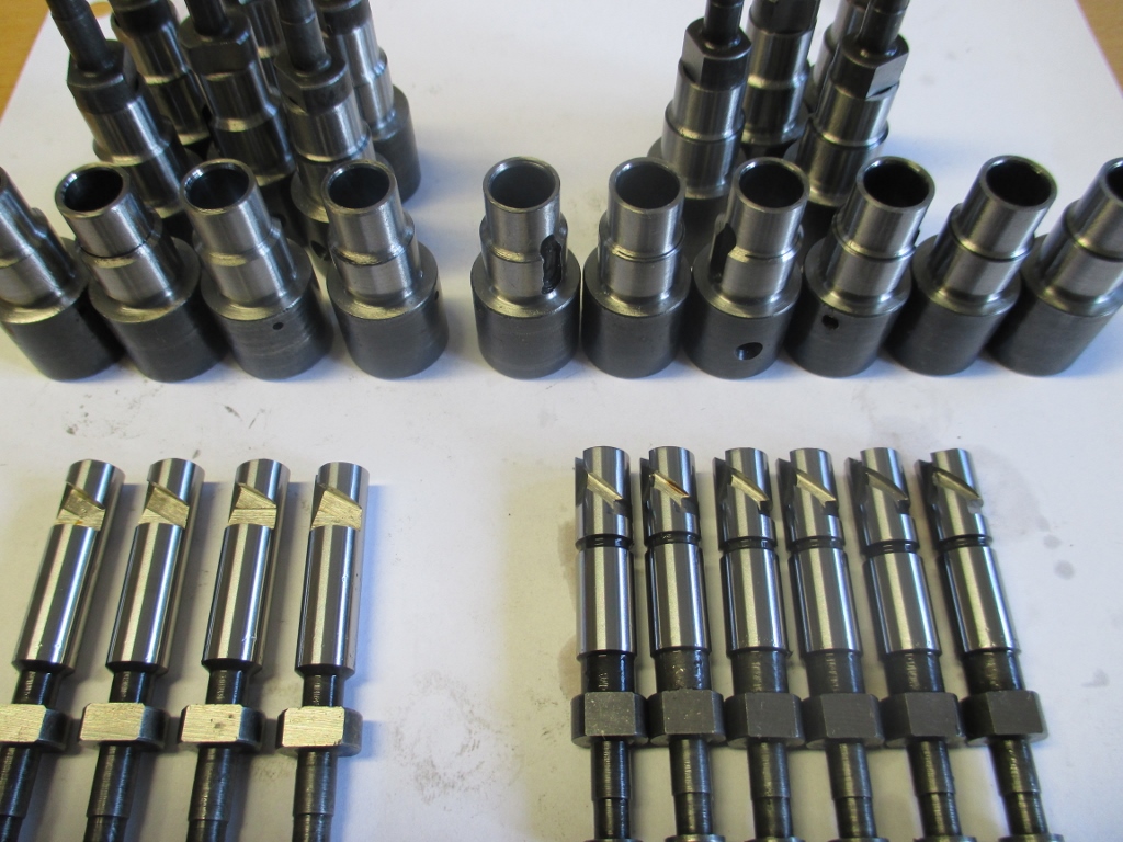

09-06-2013, 07:17 AM #418
New serie 7,5mm to the left & 8,0mm to the right. Arrived today, quality looks very good, quality test up next.
I come back with som results later on.

hooblah
401
09-06-2013, 10:39 AM #419
Oh new series? What are the differences compared to the last series?

EDH_Performance
537
09-06-2013, 01:26 PM #420
Looks very good, is this from the new suplyer you was telling me about?

The 8 mm was OK in design and have worked OK in Engines, November 2013 a new element started to be designed, Now its ready and tested, 250cc of fuel, very good result.
Also a new improved 7,5mm 140cc is in da house, to be tested soon.
These elements can soon be purchased from me, How about that!
http://www.youtube.com/watch?v=vJM2ASZri...e=youtu.be
dieselmeken
04-28-2014, 11:10 AM #425

First tryout in testbench was 220cc @2,5bar inlet pressure 2800rpm (5600 Engine rpm), 1500rpm pump did 250cc, its a improvment anyway.

Now I have reached the end,i dont Think the M-pump can do much Moore than this. Stroked camshaft,1mm higher lift, 17mm rollers, 8 mm element, cut deliveryvalves. almost 300cc with 210bar testinjectors, This is Black Smoke Racings pump for their OM606DI Project.
