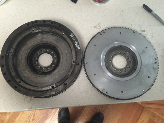

Well the proper flywheel for a 300D weighs 38lbs. I'm currently using a 28lb flywheel from a 240D. I'm not sure which one Fred started with

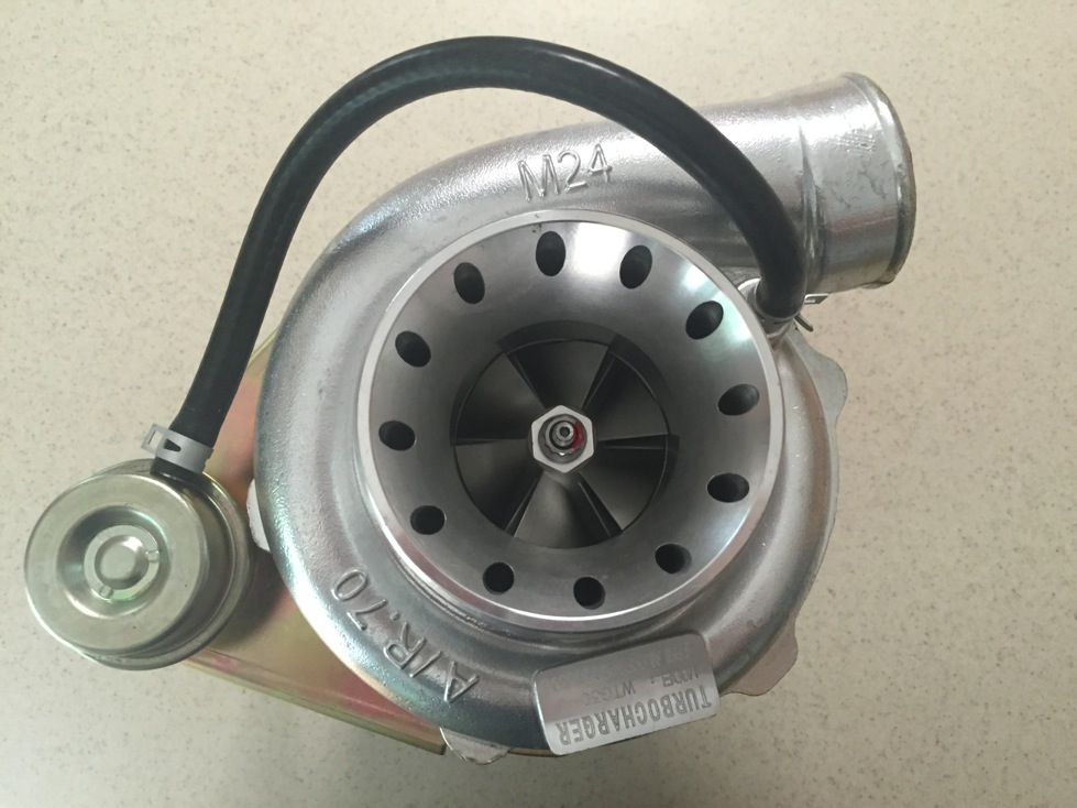

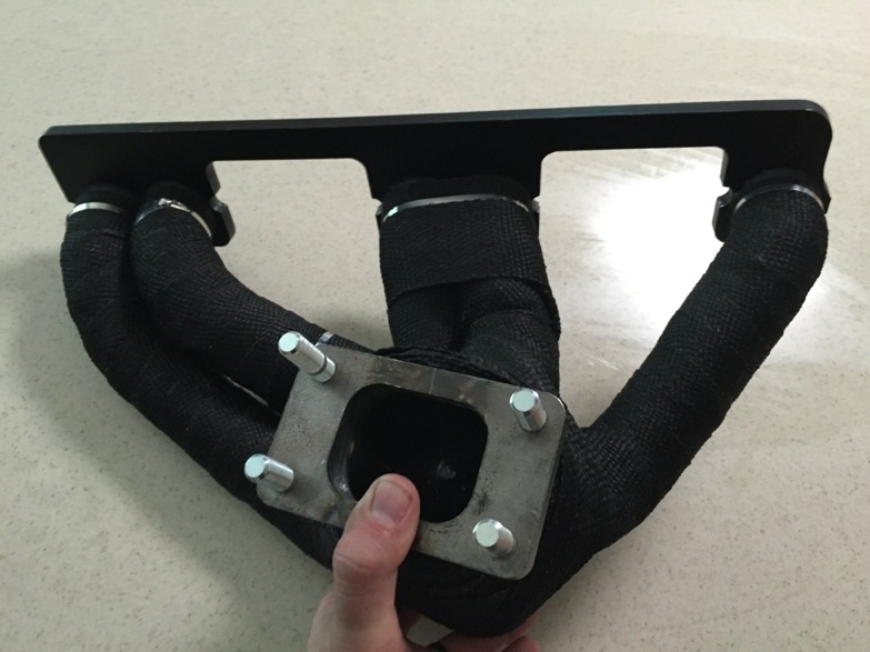

Nah, I'm leaving the hood alone. I've bastardized the W123 enough already Smile
With it rotated like it is in the picture the hood won't close. I rotated it so the outlet was pointing at the coolant expansion tank, it looked like it would make it.....and I have a nice little dent.
So I've decided to go with a temporary solution (that some of you won't like) while I save up for a genuine GT3076R.
I found a T3/T4 T04E 57 trim, Stage 3 turbine in a .63 A/R housing, Anti-surge compressor housing.
I got it for -get this- $170 shipped. Yes it's an eBay special. I only need it to last till maybe the fall.

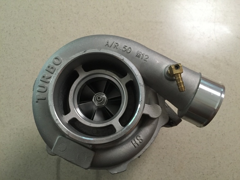

07-12-2015, 05:32 AM #209
Ray - Yes I was thinking the same. Now if I spring for the GTX I'll still be nicely on the map even at full output (5500rpm, 30psi) while also most likely having better driving manners than the HX35.
MF - I know. Taking a chance.
Atypicalguy - 12cm turbine housing

atypicalguy
555
07-13-2015, 08:32 AM #210
What holset did FRAS mock it up with in the photo?
You could bring it down and forward with an S-shaped adapter.
I was thinking 16cm housing for the HX35 but could try a 12 if the price is good.
atypicalguy
led-panzer
541
07-13-2015, 09:21 AM #211
FRAS used an HE351 with a 12cm housing. It all fits great, just not the hood clearance. He doesn't have a W123 chassis.
The HX35 is on eBay, have at it. Or $350 buys it now

07-17-2015, 04:32 PM #213
The T3/T4 arrived today.
It actually looks pretty good for being such a cheap turbo. I think it will work out. I clocked it the correct way and mounted it, it will just barely fit. Whew.
I was going to have the exhaust manifold ceramic coated but in the interest of time and money I decided to just wrap it.
And sanded/ threw some paint on the intake manifold.
I ordered some copper and teflon to make some proper gaskets for the manifolds, which arrived today, thats the next thing. Then we can get everything mounted and running (finally).
This post was last modified: 07-17-2015, 04:36 PM by led-panzer.
1985 300D 280,000 miles RIP

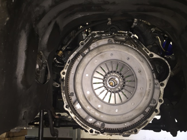

Started the flywheel and clutch install.
240 flywheel beside the new custom 18lb flywheel
Sachs 765 pressure plate and clutch disc
Installed on engine
The new setup is .140 shorter than the stock flywheel/clutch/pressure plate. So I spaced out the clutch fork pivot point with washers equal to .140", which should work, in theory.
Going to get the trans back in tomorrow. With a new master/slave cylinder and clutch line. Hope it works!
Installed on engine

led-panzer
541
08-12-2015, 09:01 PM #224
Thanks man Big Grin
Still using the same 240D 4 speed for now. Saving up for a proper (most likely ball bearing) turbo, then the next investment after that will be a BMW 5 or 6 speed. Hoping the old 4 speed tranny will hold together once I'm able to actually put power through it.

led-panzer
541
08-13-2015, 07:55 AM #226
The F-tune manifold is pretty well clear of the starter, the runners come out straight for a bit, unlike the stock cast manifold that makes a sharp 90 degree turn down.
Plus I wrapped the header, when the car is running you can touch the wrap and not get burned. Holds the heat in very well.
I have two 3" mandrel bends, as long as I have the car up on stands I'm going to make a proper downpipe. Then find a shop to finish it all the way out.

led-panzer

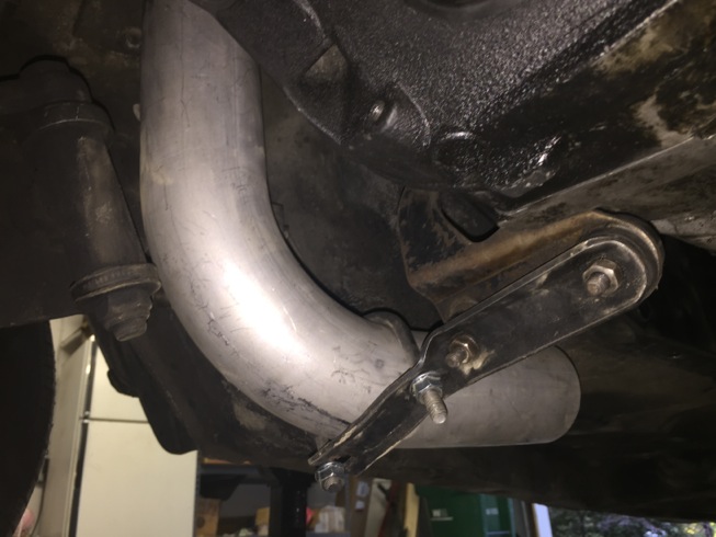

I haven't gotten my IAT gauge hooked up yet, but I believe my turbo is inadequate. With my HE341 last year after a highway run the pre-intercooler pipes would be hot, and the post-intercooler pipes would actually be cool to the touch. With this T3/T4 the post intercooler pipes are hot. Is it a precise measurement, no, but it leads me to believe that my intake temps are too high.
I'm going to try a smaller A/R exhaust housing to spool sooner, with this .63 A/R housing I don't have 30psi till 4000RPM. And at 5500RPM, 30psi boost, I calculate 52lbs/min of airflow. Off the map for a T04E 50trim compressor wheel.
And thus, I'm going to try a GT3582 with a .48A/R exhaust housing. Uncharted waters here, gasser guys will tell you that combo will suck, the turbine housing is too small, but they don't have an 80's prechamber diesel.

08-24-2015, 03:40 AM #243
Maybe stick to 0.63 and go ball bearing instead? You have a clone of a clone of a clone of a shitty turbo to begin with Smile So you can only do better. GTX-series???
F-tune Performance [Image: V-band_om606.jpg] [Image: GTX3582R.jpg] [Image: gs6-53dz_gearbox.jpg]
I can help you out with all your manual transmission, clutch, flywheel, intake and exhaust manifold issues.
F.R.A.S
led-panzer
541
08-24-2015, 08:21 AM #244
(08-24-2015, 03:40 AM)F.R.A.S Maybe stick to 0.63 and go ball bearing instead? You have a clone of a clone of a clone of a shitty turbo to begin with Smile So you can only do better. GTX-series???
I know man, I've been drooling over a real GTX3076R for a long time, but my wife will kill me if I spend another $1,600 on this car this year. Next years budget.

led-panzer
541
08-24-2015, 04:58 PM #246
(08-24-2015, 11:19 AM)Torkey Wow!  That is impressive.  Do you know what the max RPM setting is on your IP?  Sounded like you took it to about 5K but it seemed like it would have gone higher if you asked it to.
I love the sound of the turbo spooling down.
Thanks for posting this.  It was worth the wait.
I can do better I promise  Big Grin
Yea I took it to 5000rpm, and it was still pulling. Dieselmeken promised full 140cc to 6000rpm, and so far I believe it. Ive only taken it to about 5750, Im a little chicken  Blush
Ok, ok, trial and error, trial and error.
I put the GT3582 on today. Well its a bastardized clone of one.
The .48 exhaust housing is a no-go. There was only a little increase in response, and my top end is shot. It used to still pull hard at 5000rpm, now it bogs. Too much backpressure.
The good news: I was right about needing a bigger compressor. EGTs are down through all RPM's, except balls to the wall full power runs, but I attribute that to the backpressure. The charge piping after the intercooler is cool to the touch again. No surging noted at all.
So Im going to take it apart again, measure and what not, and see if i can put the larger turbine wheel and housing from the T3/T4 on the 3582, or vice-versa.

led-panzer
541
08-25-2015, 09:27 AM #248
(08-24-2015, 08:55 PM)raysorenson have you changed valve springs?
No not yet. So far so good
led-panzer
led-panzer
541
08-25-2015, 02:39 PM #249
Took two turbos with shortcomings and made one good one out of them.
Took the turbine out of the T3/T4, all the measurements were exactly the same as the one from the GT35, except the wheel itself of course. So I just simply swapped out the turbine wheel/shaft. Put the .63 housing on, which fit the GT35 CHRA, and it all bolted together. Couldn't believe it.
Fired it up, checked ok, took it out for a drive. Only took it to 25psi, but EGT's didn't pass 1300. Top end is back. Checked it out when I got back and there's no excess shaft play and it's not bypassing any oil.
So, it worked! We'll see how long I guess
led-panzer
