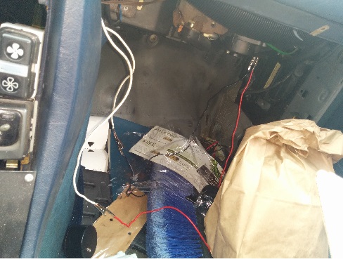

02-08-2014, 10:18 PM #168
OK I can't win. 3 cars and they are all not worthy of putting my kids in. .... I will rant first than actual questions near the end....its about my blower circuit.
So this here car. Got all the glow plugs glowing. It starts in the cold, win. I took it to a shop to get the support bearing for drive shaft fixed, long over due. They fix it great but now that I actually have a bearing I can tell that the guy who did the 4,speed swap prior to me did not balance the shaft. Either that or the shop didn't put it back together right. I like the manager and we talked about lining shit up. I believe he knew what he was doing. But I get some vibration at 40+ haven't taken on the highway so can't fully describe yet. Probably need to take that out and get it balanced, maybe custom shaft?
Any who all that.
My heat blower motor has no power to it. The fuse is good. #8 when I play with the fuse I can hear clicking like a relay might be attempting stuff. I put power to fan and it goes. Also blows heat. Is that clicking the monovalve?
Is there a relay aside from the resistor thing u dear hood on the fender?
By the way. I'm am tired of winter. None of.my cars were breaking when it was warm.
And ya know, now that I've been here a while I feel sorta bad about asking questions about general maintenance so I will say sorry for that. But its cold and all my cars are giving me headaches. I've googled this shit and everyone talks about fuse 8 or motor brushes. Both are good. Wtf.
Oh and dammit I'm on my.second climate control unit could it be that again?! I need a simple fix fuuuuuuu

02-09-2014, 01:09 AM #169
Simple stuff?... Check the cold engine blower motor lock temperature sensor located on the thermostat housing. If it is unplugged, your blower motor will not work. If plugged, then unplug it and ground the wiring to the block. Hopefully your blower will run.
If that is not the case, than look into a faulty resistor pack or another dead CCU.

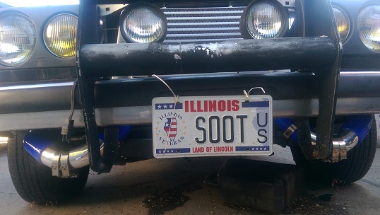

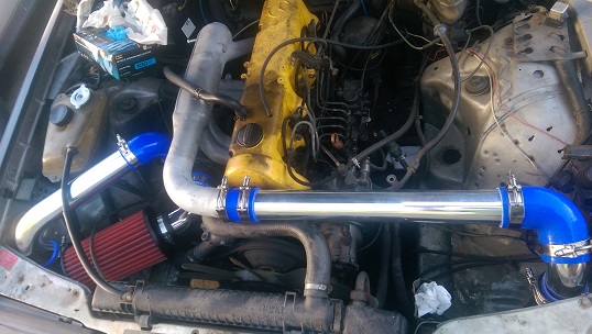

06-15-2015, 08:18 AM #188
done some work lately. Finished HX30 install. Front mount intercooler installed. New drive shaft. Crappy video above is of the sweet sounds brought to you by Holset ;-)
lgreeley83

06-15-2015, 09:16 AM #190
Eventually, ill have to do the research and get the clutch chosen. Did you get yours in yet? My car is still driveable as is with current clutch so it will probably be on the back burner for a bit. Trying to buy a house right now. Wife will kill me if I spend any more ;-)
Car is definitely a lot better with the intercooler. EGT doesn't get much over 1000 at extended full throttle, 25 psi boost. Before I couldn't go much more than 10 secs before getting up to the 1250 range. Boost comes in pretty quick too. No complaints with the HX30 yet. I've only got a few drives with it. I will need to tune a little and see if I even need that much boost.
lgreeley83

I burned up the motor doing that ;-) greazzer is hooking me up with another one.
I haven't looked at wiring diagrams yet but I should do something other than straight 12volt from the battery right? How'd you do yours simple? I'm removing the hvac control unit amd don't want to fry another one.
Im really getting the car to full simple status. Thinking of removing stock wiring harness all together to do it my way.
lgreeley83

06-16-2015, 09:37 PM #194
I did mine straight like yours, but the switch's shitty resistance slowed it down. Still burned it up though.
Unless you have a manual climate control ready to go leave the harness. Or just run a hi/low switch to the factory resistor block.
