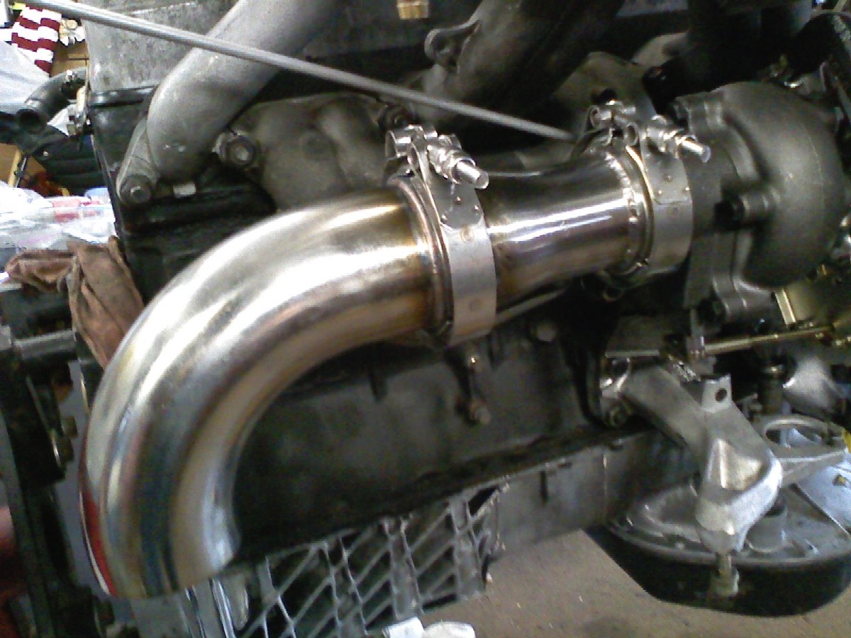

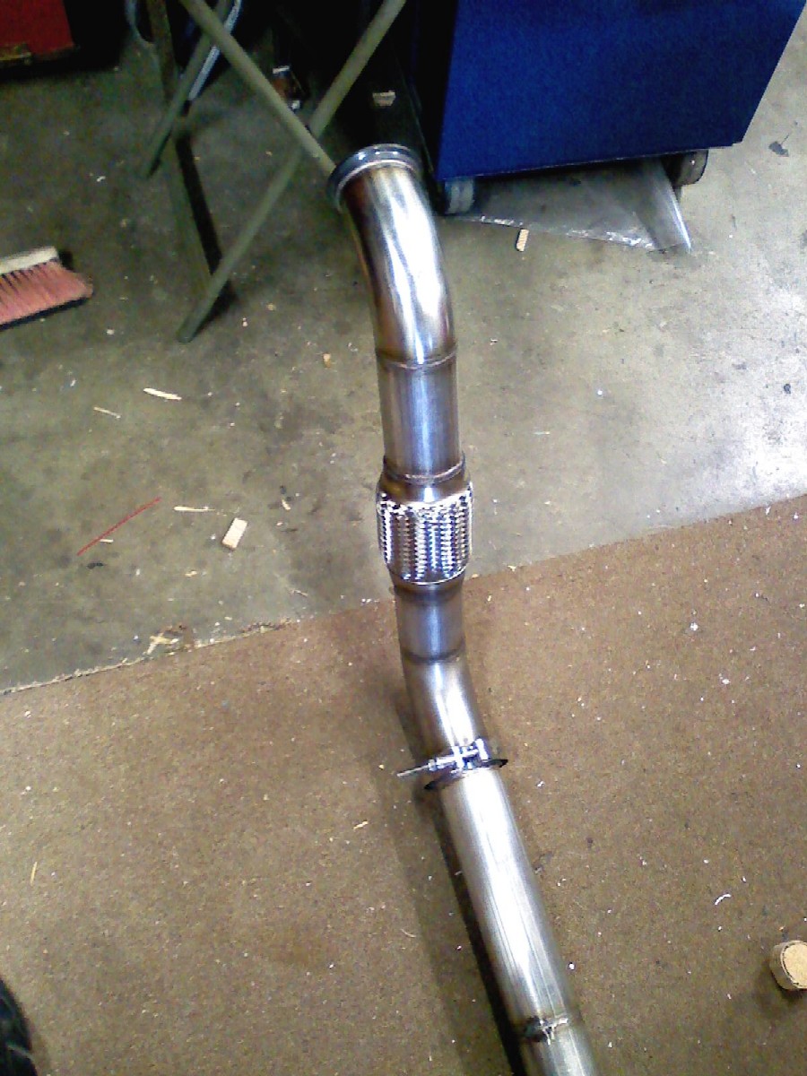

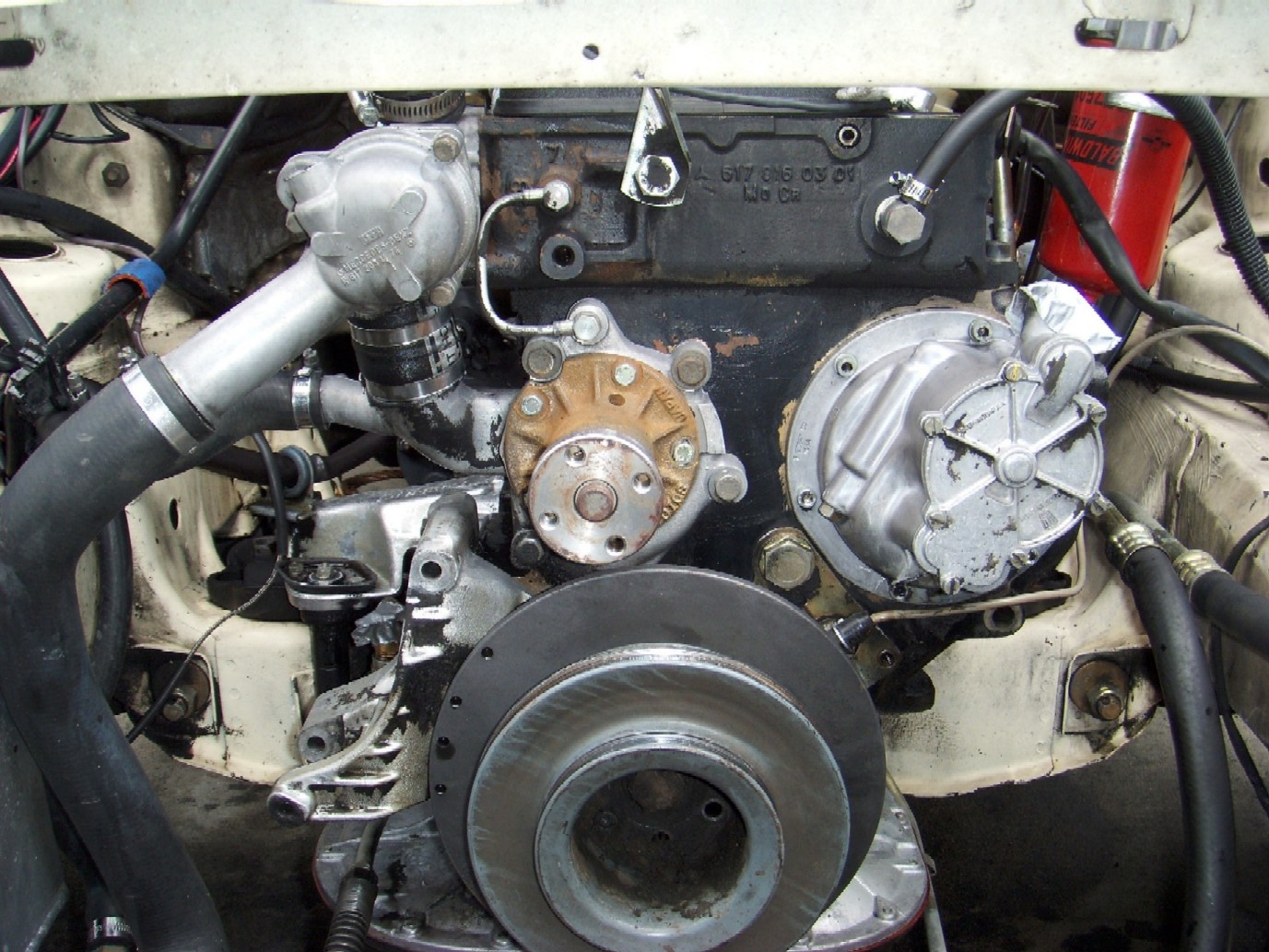

04-03-2010, 02:11 PM #102

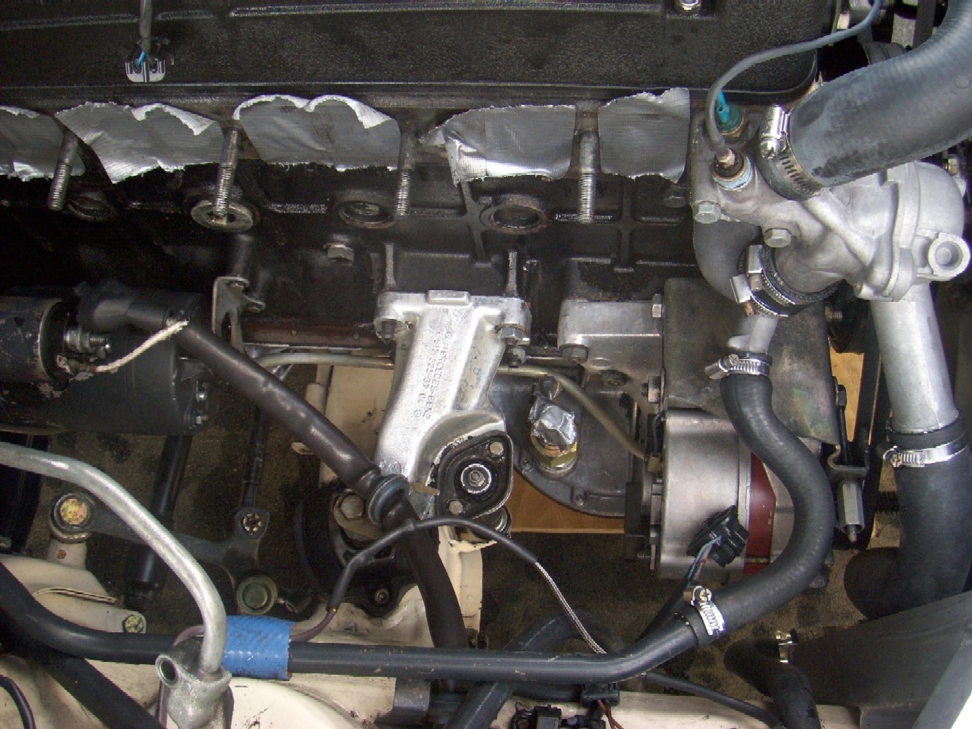

Thanks for the heads up on the tensioner. The one I purchased is an after market, maybe the OEM is better?
Evidence of hackage? Not sure what you mean, but I try my best to have form and function! I am a bit anal-retentive with a dash of OCDBig Grin When I build equipment or other projects I ALWAYS try to leave a lasting impression - You will be remembered one of two ways, That guy did a hell of a job, or that guy did a shitty job and I never want to see him again.
I try to keep cost in mind, but I just cannot bring myself to use something designed for feces on my carTongue If it works for you then more power to you, but not for me.
There is someone better than me and I use there knowledge to guide my designs if I cannot figure it out for myself. I am not building this to be THE fastest car, I am building it to see what I can do, how much power I can squeeze out of this motor and to see if I can inspire someone to also become an enthusiast.

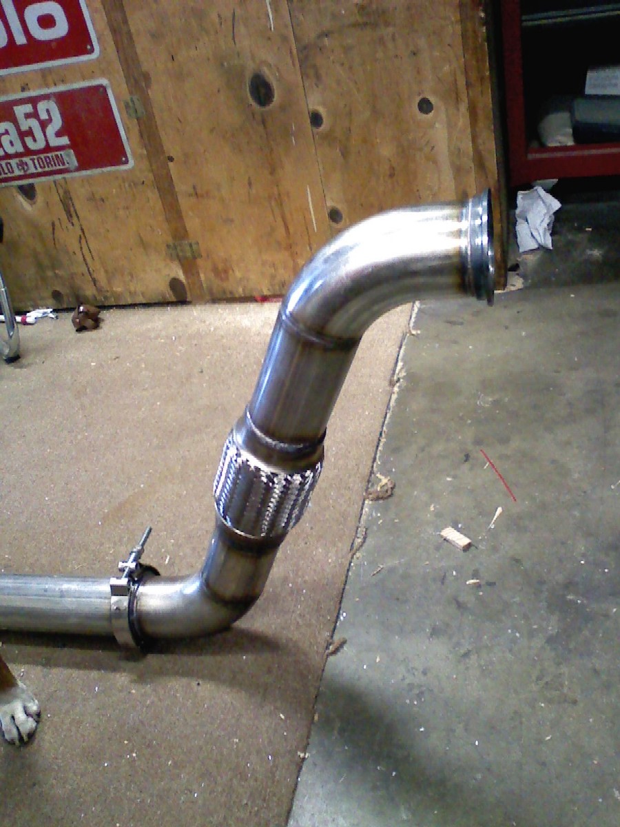

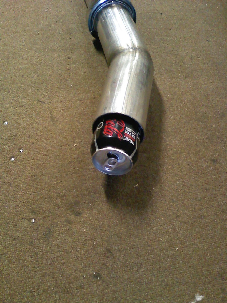

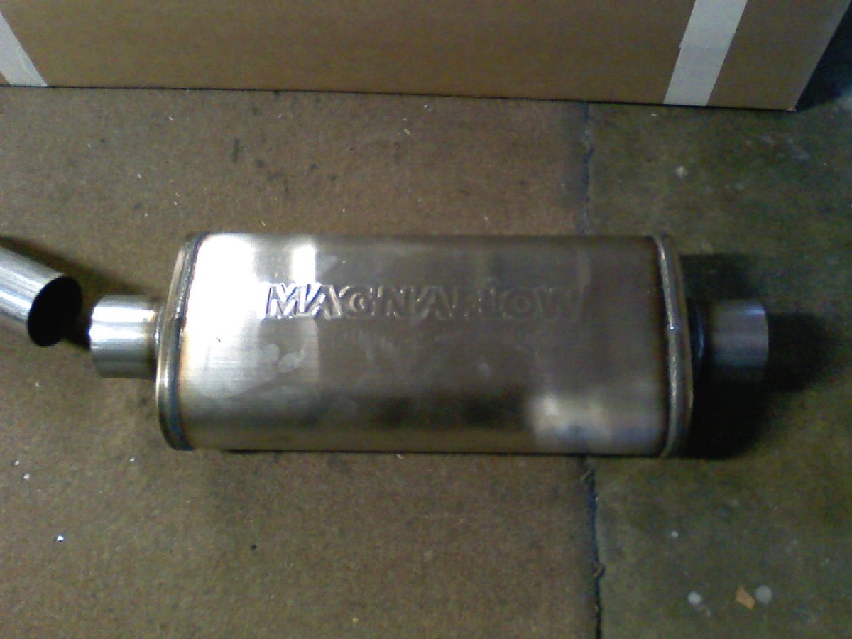

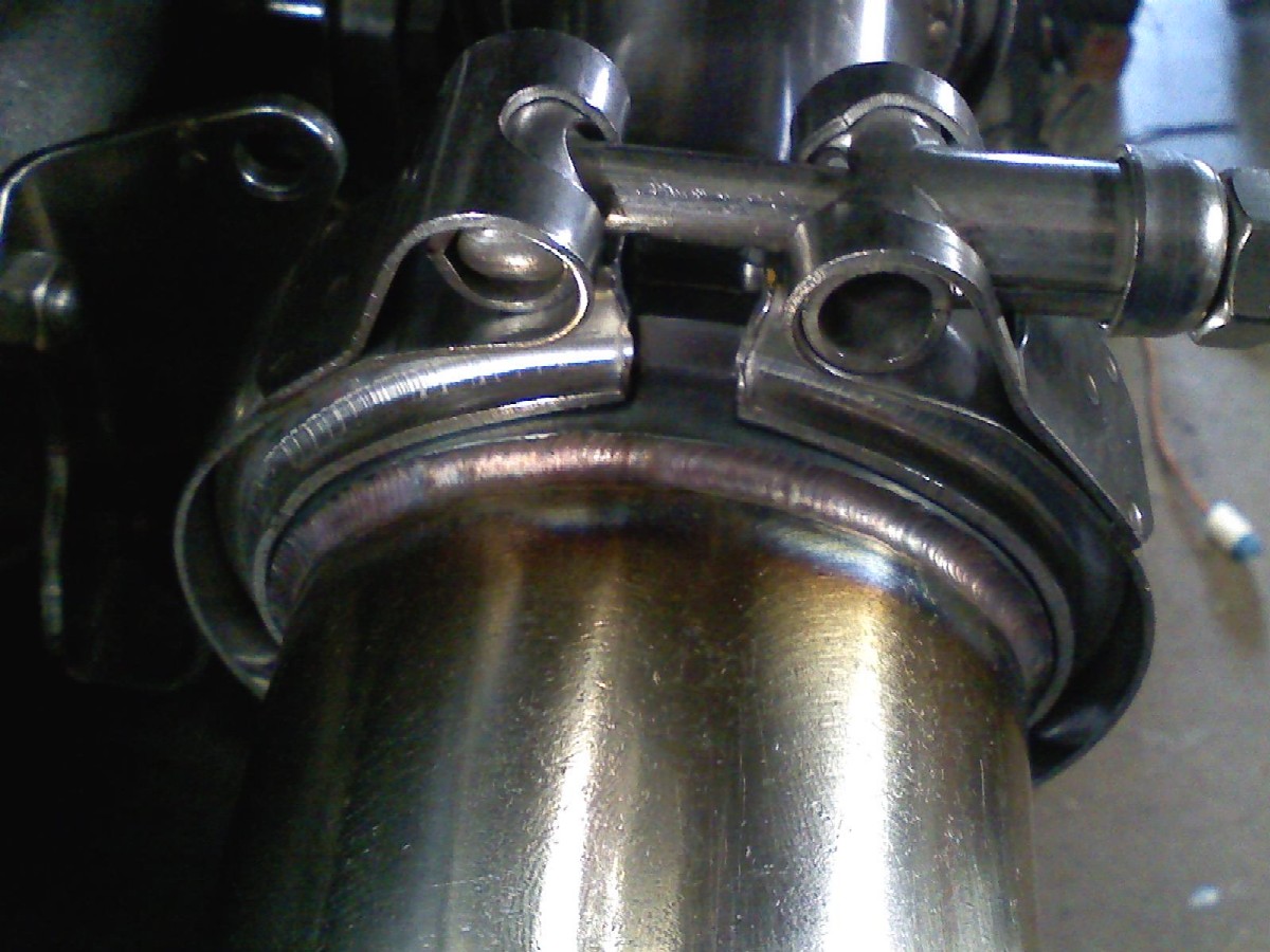

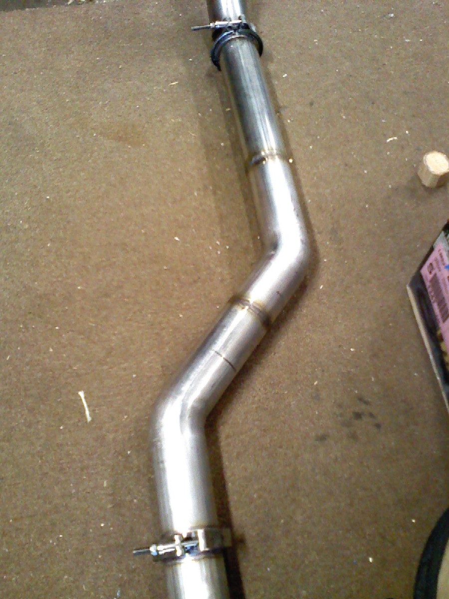

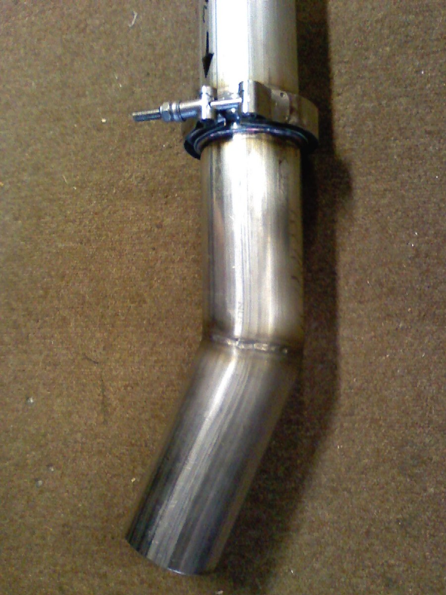

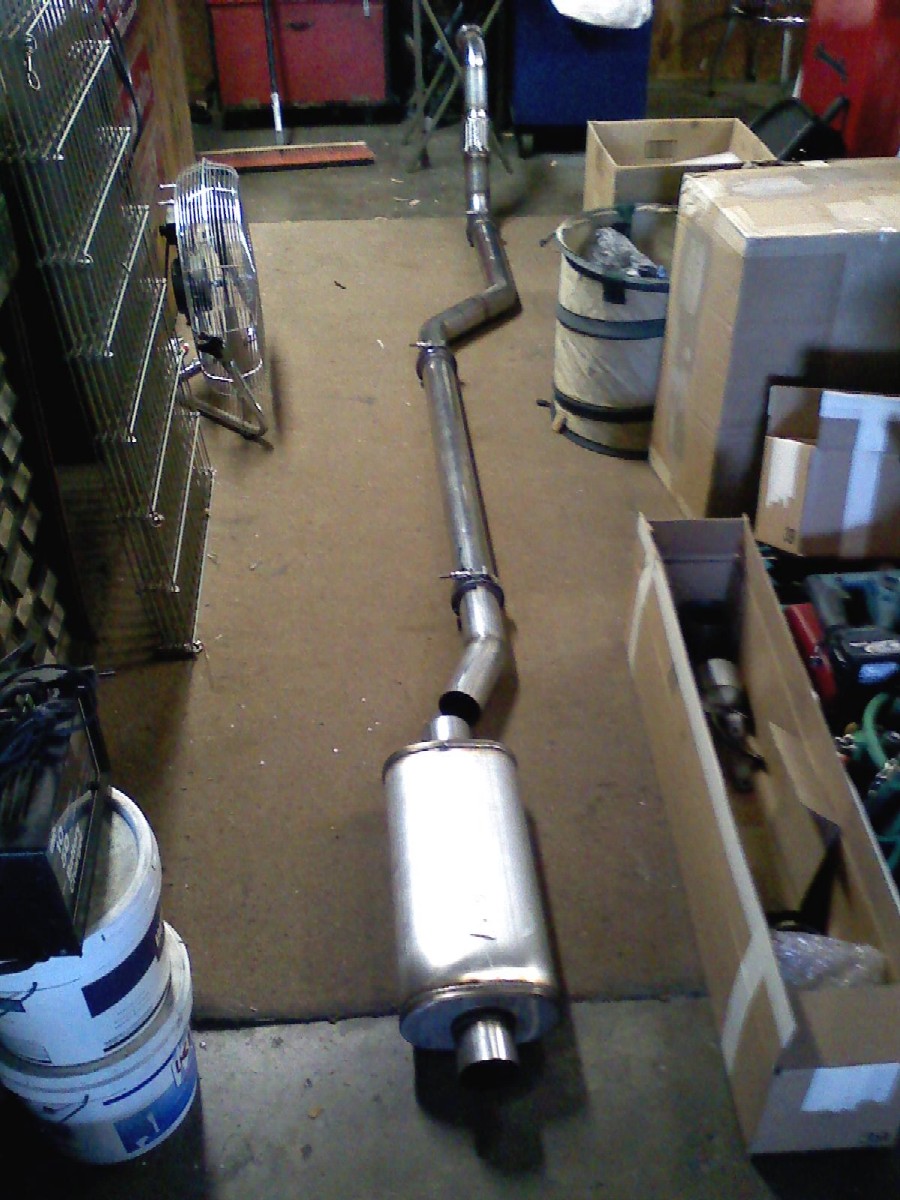

Off my soap box now and that being said here are a couple of pics of my exhaust system...I am waiting for my pump and its' 7.5 mm elements to be completed and then I WILL RULE THE WORLD!!! MUWAHAHAHAHABig Grin

04-03-2010, 03:48 PM #103
Looking good I like the exhaust so far!

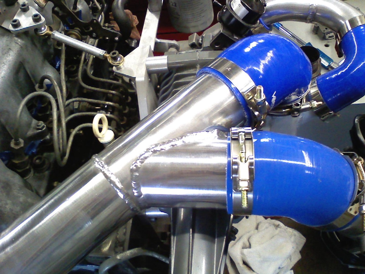

04-03-2010, 05:17 PM #104
Hey, your pipe is pointing the wrong direction, I thought you were going to run a hood stack!

04-03-2010, 07:04 PM #105
(04-03-2010, 05:17 PM)ForcedInduction Hey, your pipe is pointing the wrong direction, I thought you were going to run a hood stack!
Big Grin It's adjustable, I thought about having a port like the cars that have a bypass for open headers, but that probably won't happen...The OEM bracket will be utilized for support. I do not have a flex joint after the turbo on my current set up, it all seems to expand and contract nicely. It is held together with v-band clamps so they may allow for expansion and contraction.
I still need to trim the 90 to get the angle to follow the contour of the OEM pipe. I just ordered a 3" x 6" flex joint that I will place as the OEM design has. There will be another v-band clamp on the bottom side of the flex joint after a 90 elbow. A few more bends and I will probably end up going with a round full flow muffler, I may go with Borla or Magnaflow.

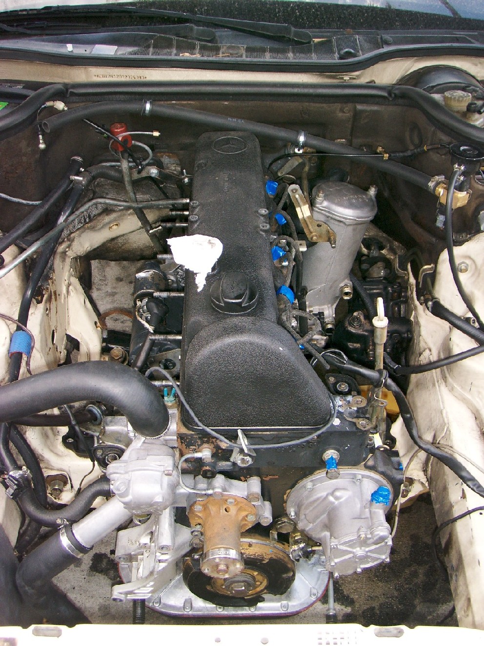

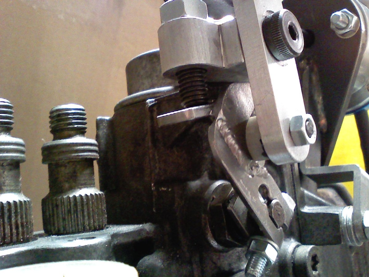

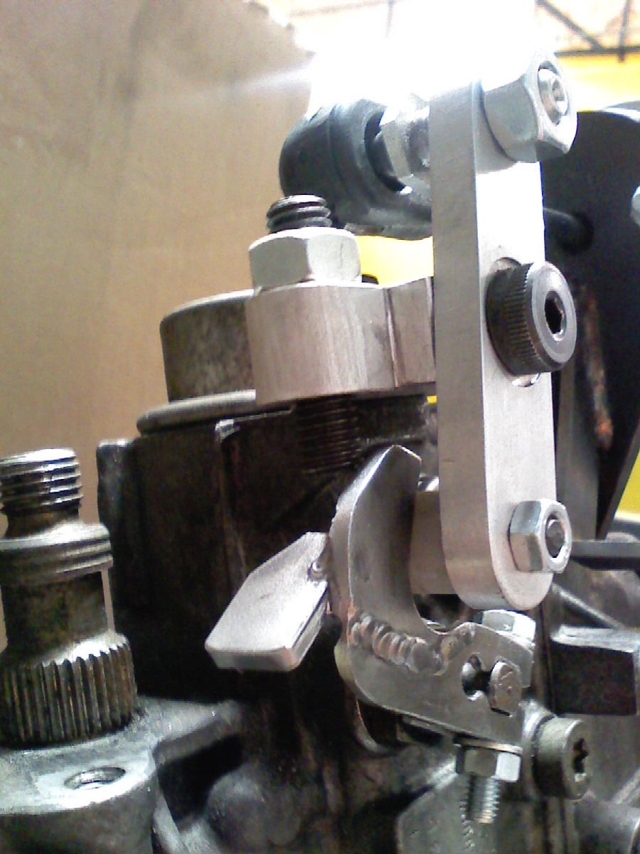

04-05-2010, 07:20 PM #106

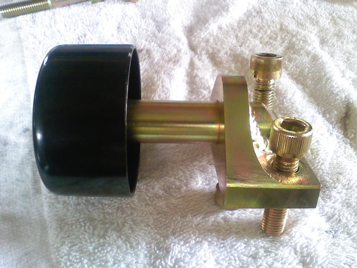

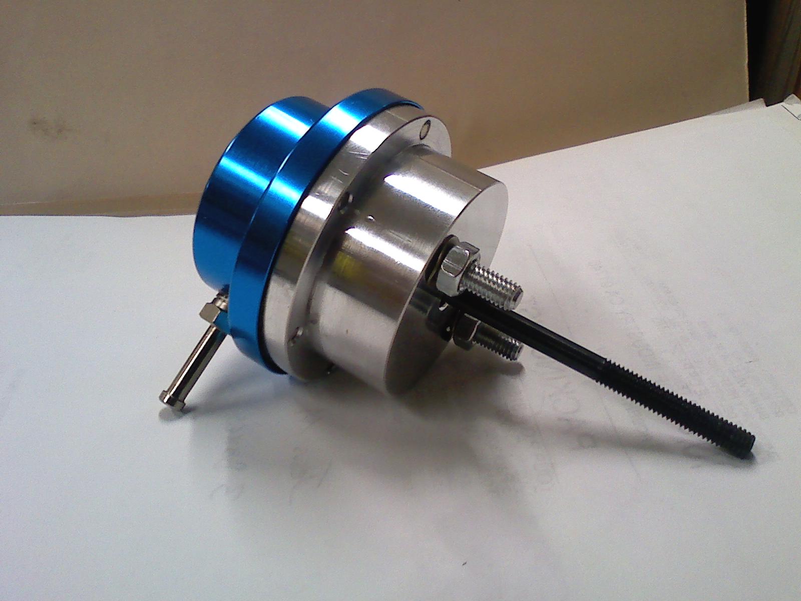

A couple of pics, 2 of turbo bypass valve and 1 of an M-pump installed, not "THEE" M-pump (7.5mm elements).Tongue

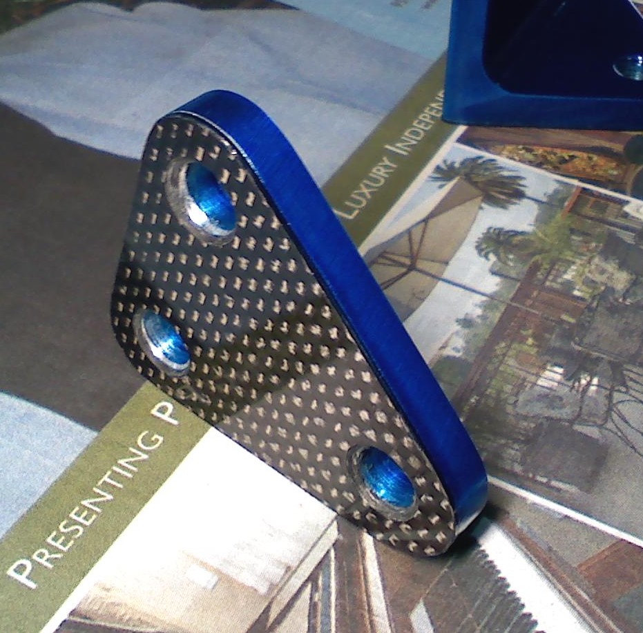

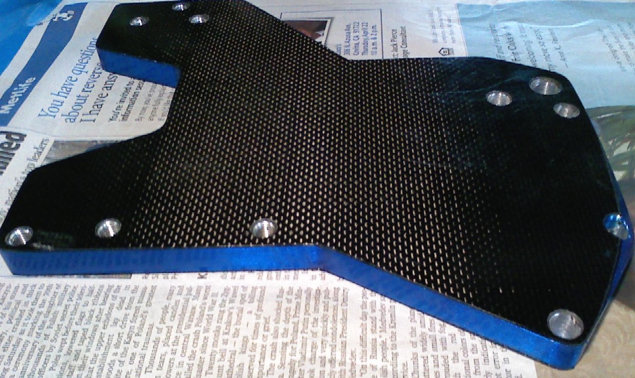

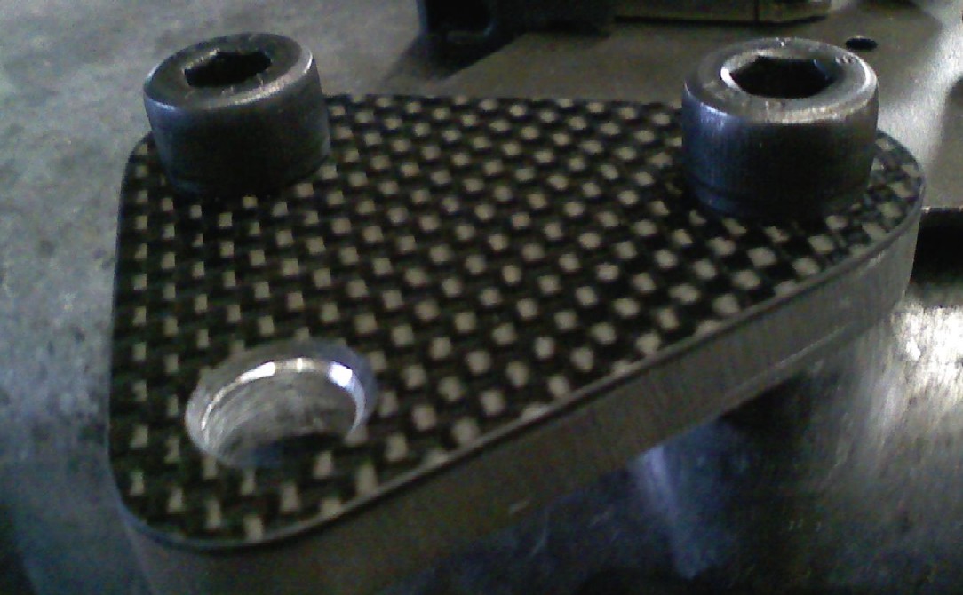

04-11-2010, 03:19 PM #107
Got bored lastnight and decided to dress up my brackets, It may not be to your liking, but ask me if I careBig Grin, that being said...(and yes it is real carbon fiber)
Valve cover strut bracket, before paint
Valve cover strut bracket, after paint
Supercharger mounting plate
By the way, I just picked up a set of headlights and wanted to see what you thought, see I do care about your opinion, sometimesBig Grin
What do you think, too big?

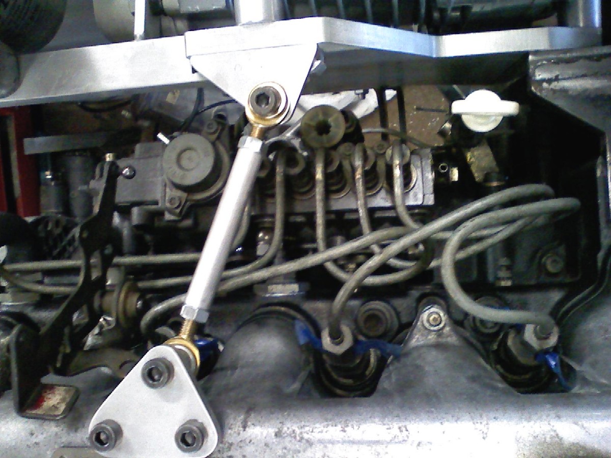

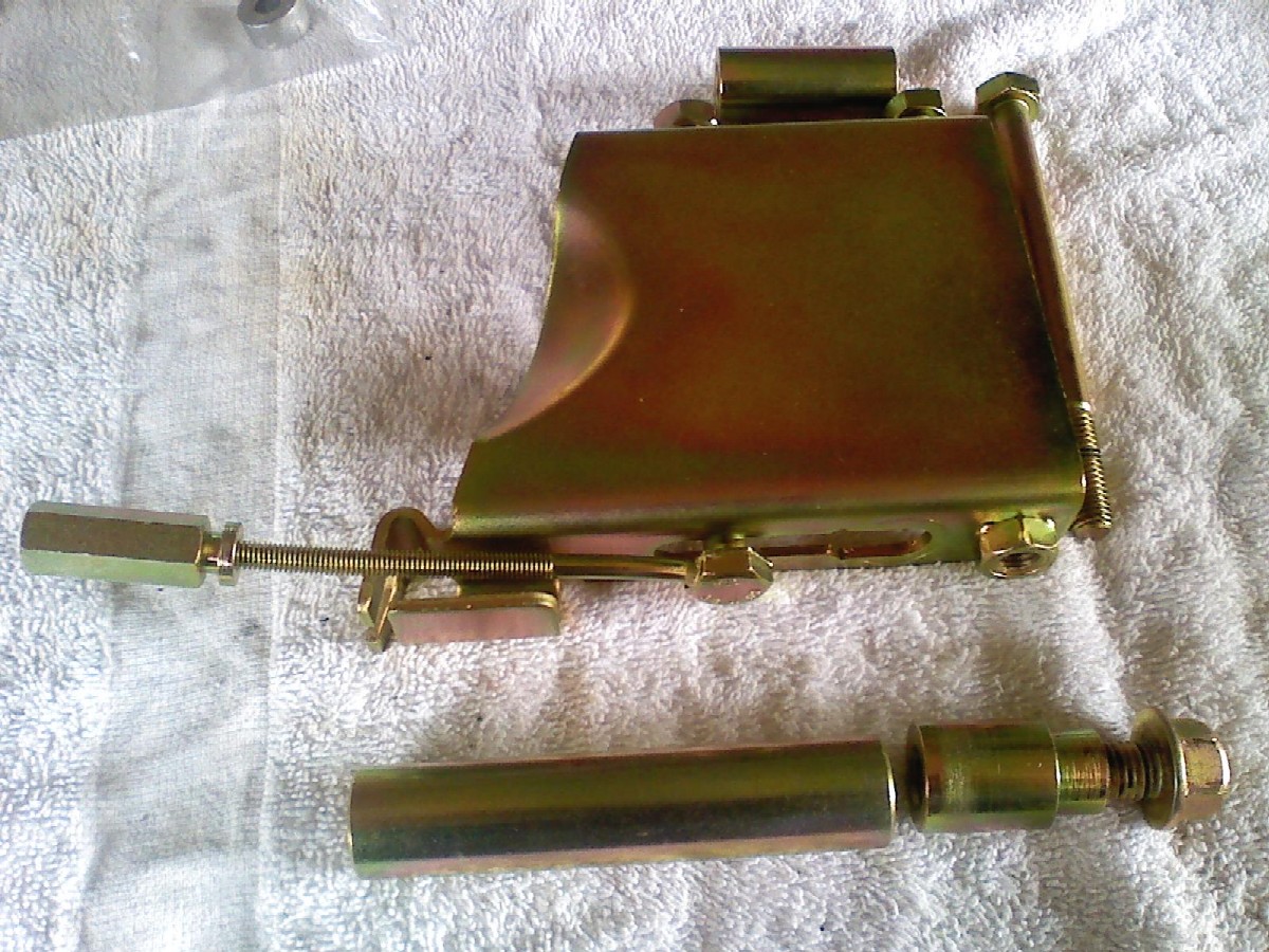

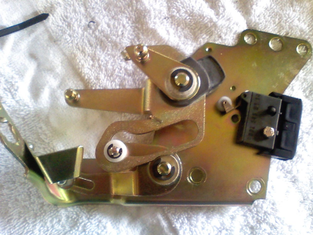

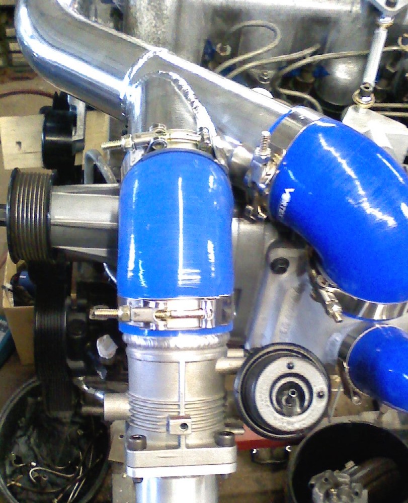

04-17-2010, 07:13 PM #109

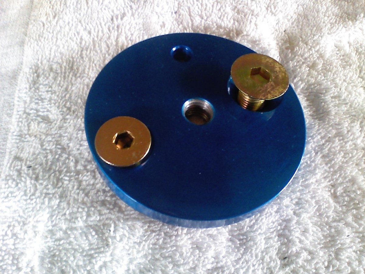

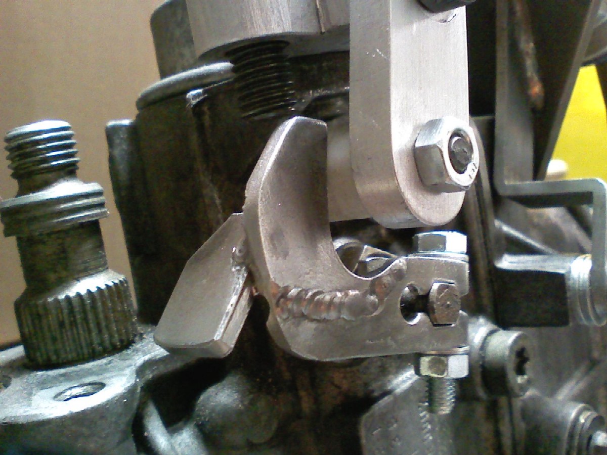

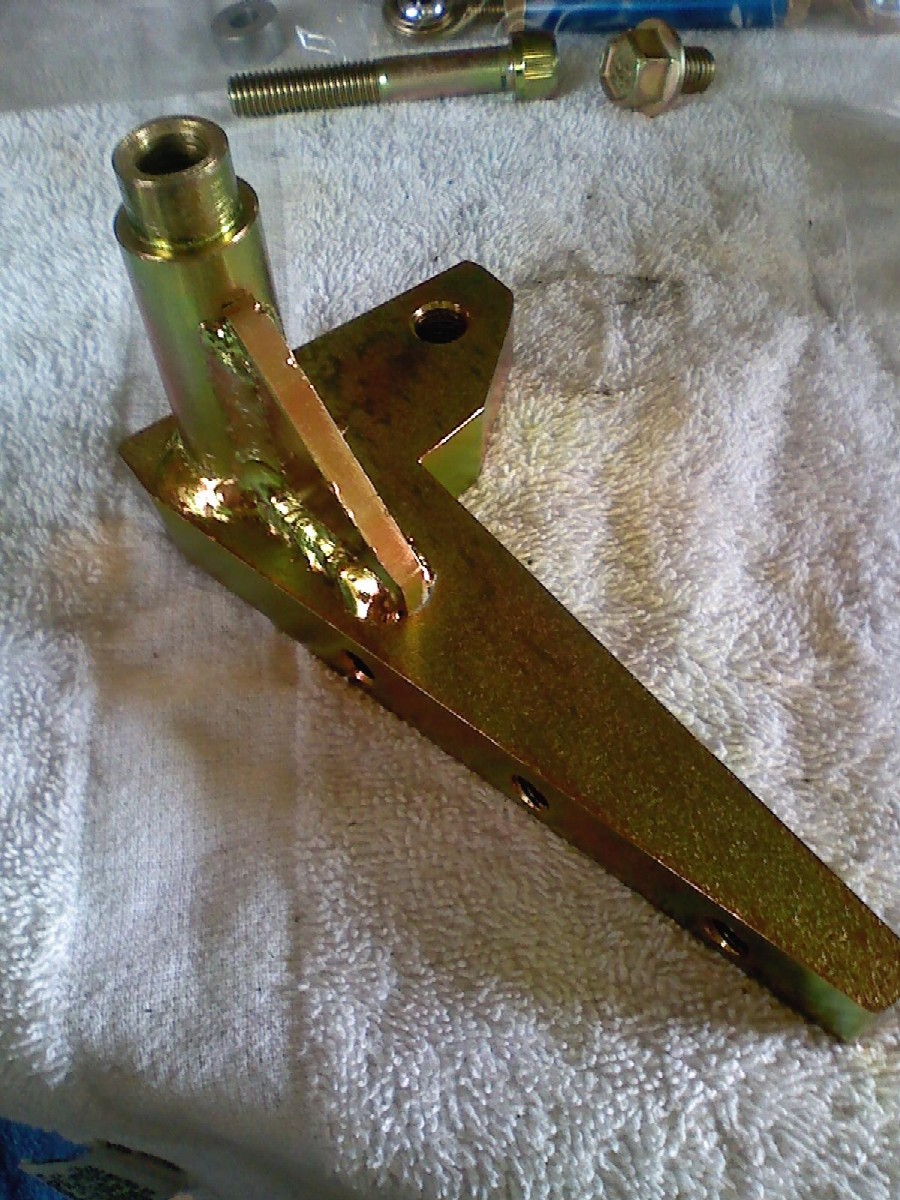

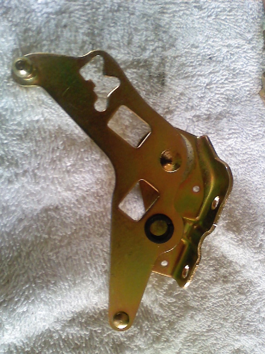

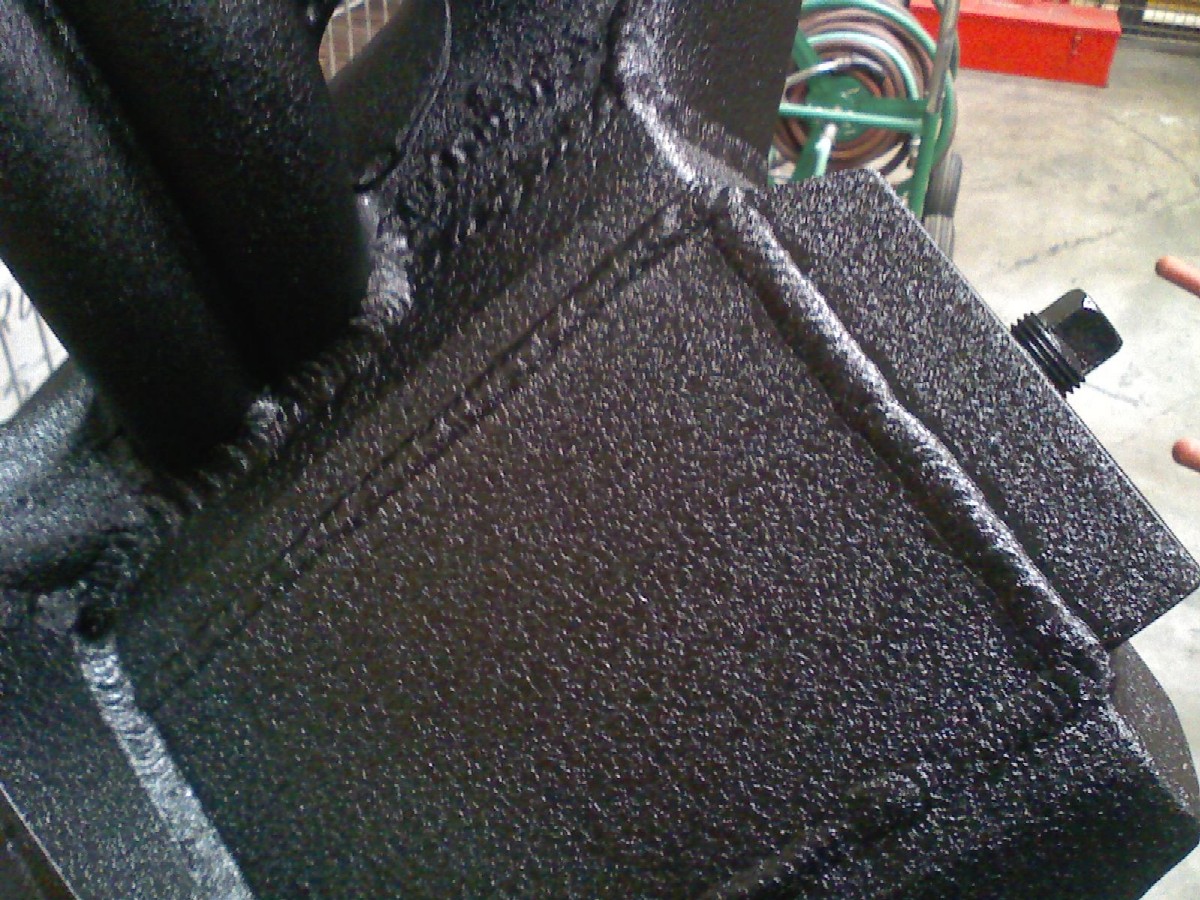

I painted my intake and Got a few parts back from the plating co. - they were yellow zinc coated.
Intake/intercooler painted wrinkle black to match valve cover
Another pic of intake manifold
Throttle linkage rebuilt to remove slop and replated yellow zinc
Throttle bell crank cleaned up of unnecessary attachments
Alternator bracket and idler assembly
A/C support bracket and idler bracket
Idler bracket
Aluminum mounting plate for tensioner/idler
I also had my injector lines plated and many other parts as well. I porbably had a 100 parts and it cost me $85.00

(04-17-2010, 08:23 PM)Kiwibacon Very pretty, but does it go?
Time will only tell. Rolleyes
I am definitley going to drive this thing, maybe even a gratuitous burnout becasue I can. It will eventually see the dyno and remain a daily driver.
My philosophy is to do it right and make it look good too. My taste may not suit everyone, but it is, in my opinion, done tastfully. Once the enitre package gets completed I will be proud to open my hood, show you my engine and stomp all over your dieselBig Grin
Countless times I watch these hotrod shows on TV and they almost never clean or coat areas that need attention. The old saying chrome wont get you home applies here too, but no reason you can't make things look nice. This was never intended as a budget build or see what I can make for $22.00 bucks and look like you spent way less.

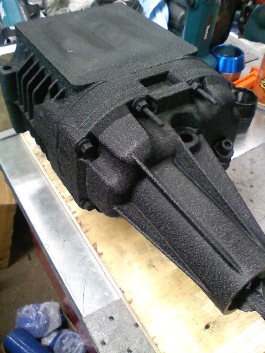

04-20-2010, 10:56 AM #115
Is that rhino liner?
Kozuka
I'm_Badass
334
04-20-2010, 11:52 AM #116
Looks like a *crinkle coat* paint.
Kozuka
04-20-2010, 01:19 PM #117
It looks like a high temp crinkle finish?
Rudolf_Diesel
Ask me if I care...
579
04-20-2010, 09:58 PM #118
It is VHT high temp wrinkle finish. I used it on my valve cover a year ago and it is holding up well. After spraying 3 wet coats I let it dry for about 30 minutes and then use an industrial heat gun to get the result you see.

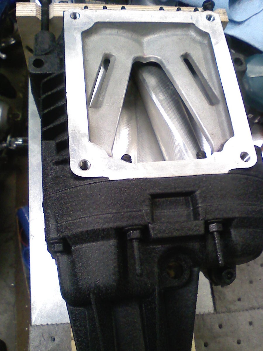

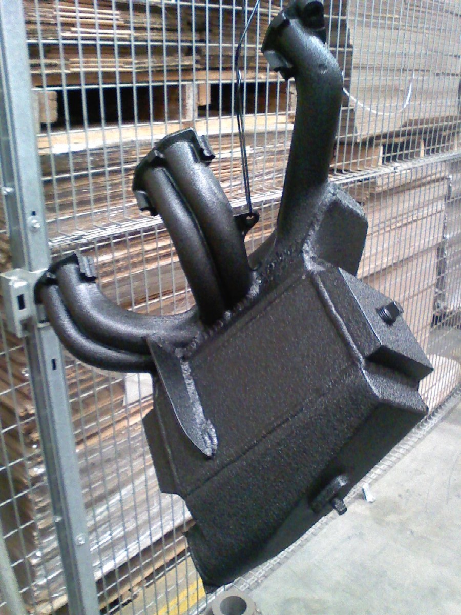

04-22-2010, 09:55 PM #120

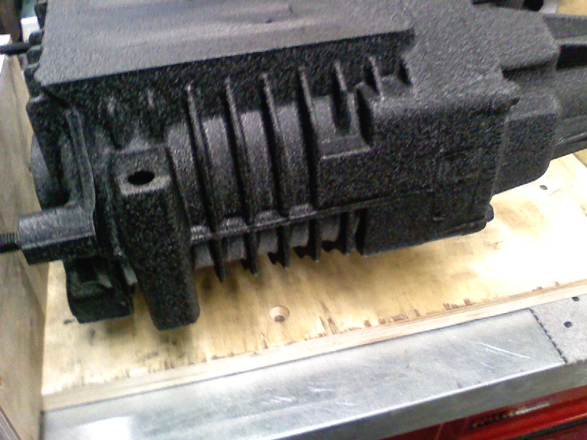

A few more pics of progress...
S/C painted and ready for action
More of the S/C
One more of the S/C

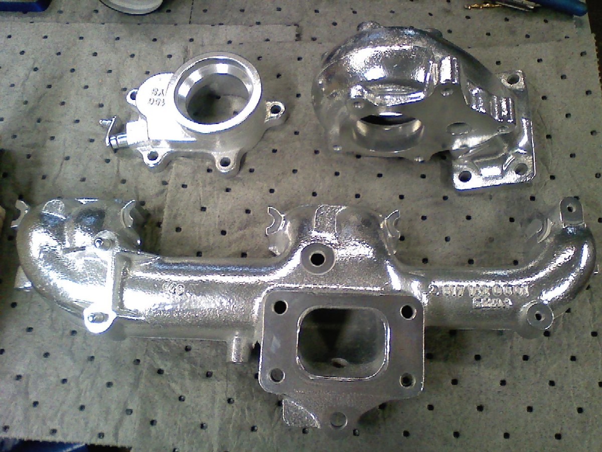

Exhaust manifold and turbo housing jet coated
The beginings of my ALDA

04-28-2010, 06:50 PM #126
(04-28-2010, 08:53 AM)winmutt I missed the bit about the ALDA, you are building your own?
Yes, I am building my own. I used a modified BOV and a linkage system. A couple of pics...
Here is a video of the action, I am connecting an air line set to 1 bar = full travel, it is rapid because the hose is disconnected to dump the air.
http://www.youtube.com/watch?v=806By9tLa1Q
This post was last modified: 04-28-2010, 07:26 PM by Rudolf_Diesel.

(04-22-2010, 09:55 PM)Rudolf_Diesel ....
Inspired by this?
[Image: attachment.php?aid=2150]
Looks like a reversed version.
BTW - I assume you previously operated the M-Pump without one. I take it the 7.5 plus the new induction setup would warrant the use of one.
Example picture courtesy of Charmalu.

I did get some inspiration from the Myna pump, however their version looks like it was slapped together from junk peices. The orientaion was all wrong on the Myna pumpp as well, it would not clear the area where the S/C is to mount.
I was running the M-pump for about 9 months and no form of an ALDA, but it was only putting out twice as much fuel as stock settings give or take a few cc's
The 7.5mm elements are in the area of 4 times the amount of fuel as stock. Even though I will have instant air via the S/C, I still need to be cautious of smoke, especially in So. Cal..

Once the above items are completed I will install the S/C so I can finish the intake portion of that sub project.
After completion of the above, I should have my pump...it is almost done, then the fun will begin.

05-07-2010, 10:10 PM #135
[/align][align=left]
(05-05-2010, 11:36 PM)supercharged3.0 ...Also, planning to get a big heat exchanger and run 20+psi. You think, intercooler of that size you have, will handle 20+psi?
What size is yours? How many cfm?
I was peaking around 24 psi for short periods, I don't think 20 psi will be a problem. I believe a plastic tank IC is good for about 40 psi before it blows apart. I have no idea what the CFM rating is, dimensionally it is 4" x 5" x 14" (heat exchanger portion)
I have been working on my exhaust and I am about 80% complete. I did not want to finish the muffler transiton piece until it is installed on the car - it just needs to be done that way so it fits right. Here are a few pics, the material is 304 SS. I also modified the OEM bracket that secures the pipe to the transmission.
This post was last modified: 05-07-2010, 10:30 PM by Rudolf_Diesel.

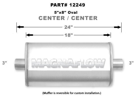

05-08-2010, 12:18 AM #136
What size Magnafow are you using?
I could only imagine how nice it is going to sound.

05-08-2010, 06:23 PM #137
(05-08-2010, 12:18 AM)DeliveryValve What size Magnafow are you using?
You my friend can actually hear it once it is completeBig Grin
This post was last modified: 05-08-2010, 06:24 PM by Rudolf_Diesel.

The chain tool would be great, I cannot get enough off of the web to reverse engineer one.
The plate came in handy! I have drawn it up in CAD and dropnosky is sending me a bell housing. I am going to see how the T5 will bolt up to the bell housing and go from there. If that doesn't work then it will be a new plate to mate to a Ford style bell housing.
I found a guy in Oxnard that build the TKO500 to handle 750 lb/ft (MMR) and that keeps the gear ratios as close to stock as possible and a .68 OD
All I have to do is sort out the clutch and flywheel. Jeemu said he used a BMW pressure plate, MB clutch and Tremec trans. He welded a bell housing to an adapter plate.

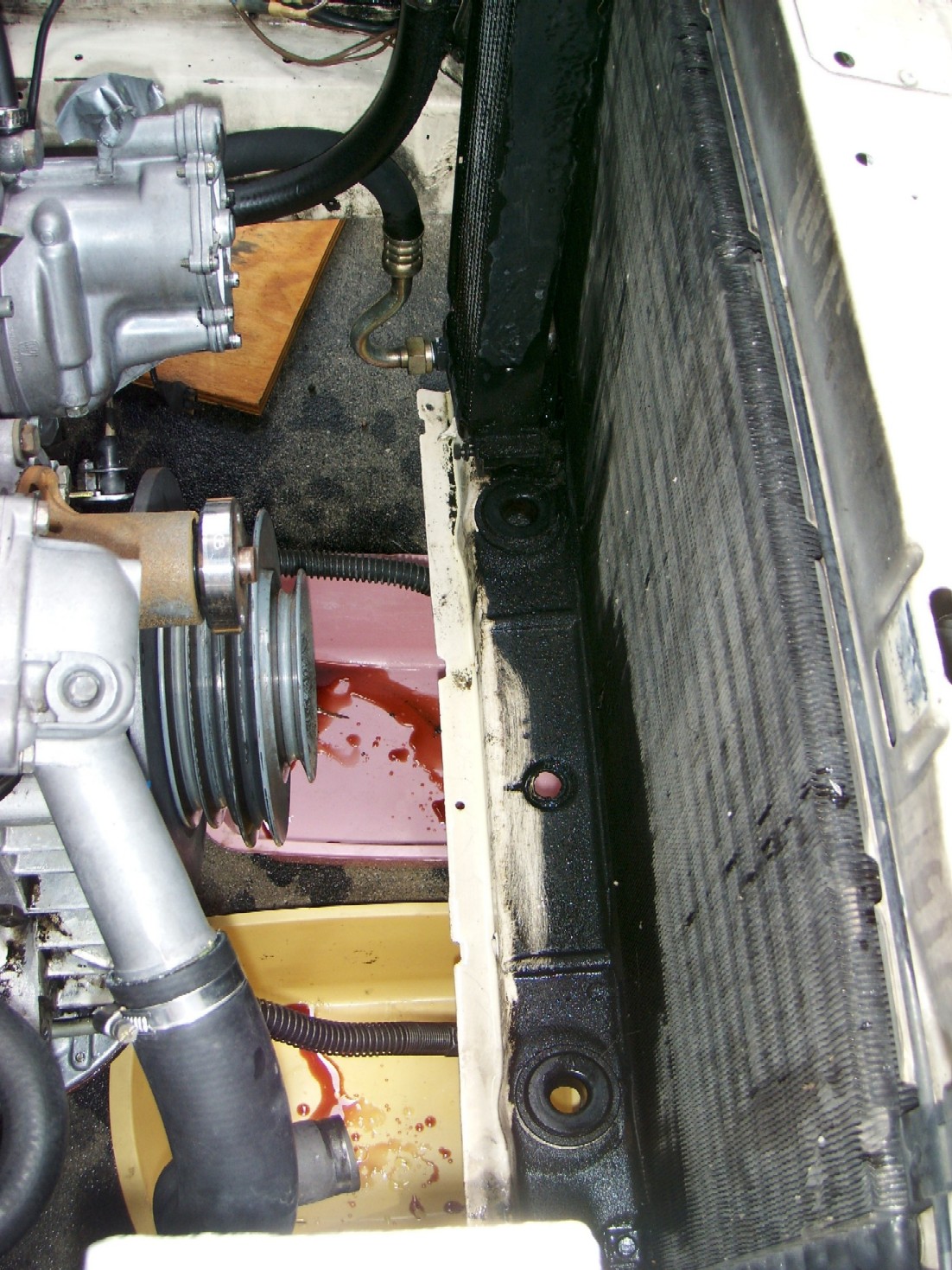

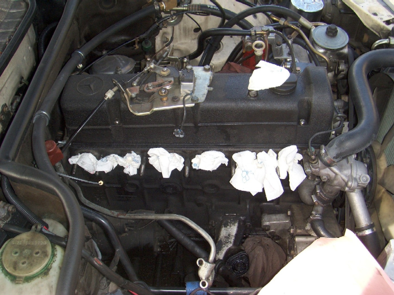

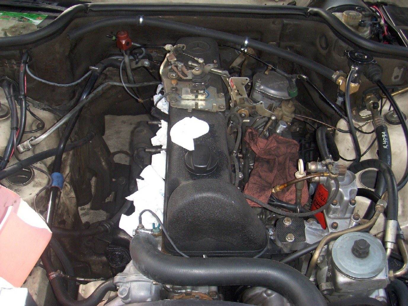

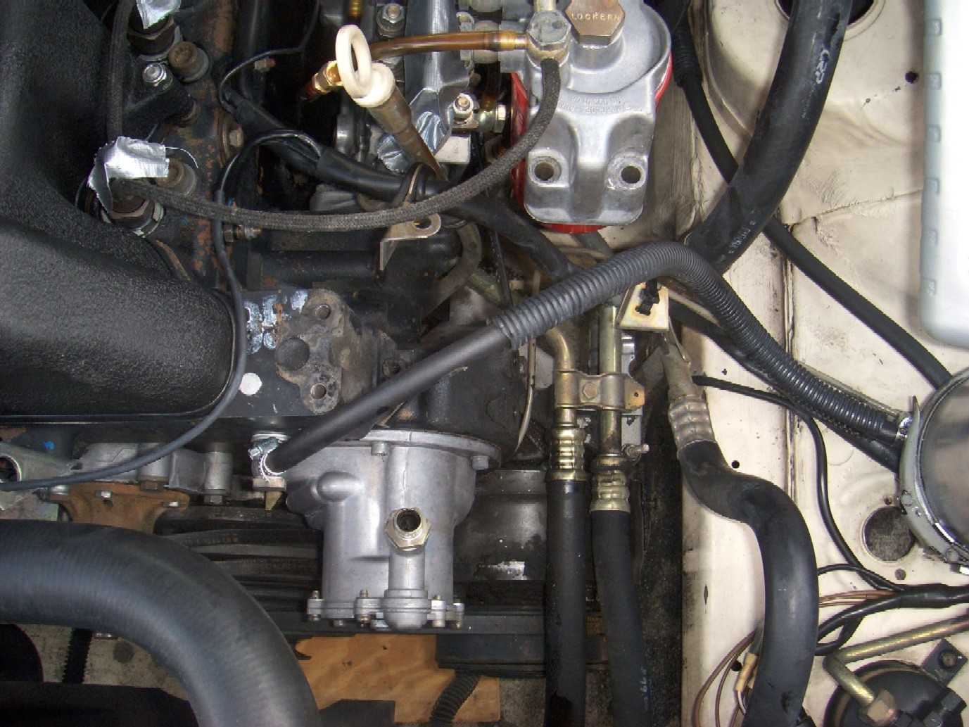

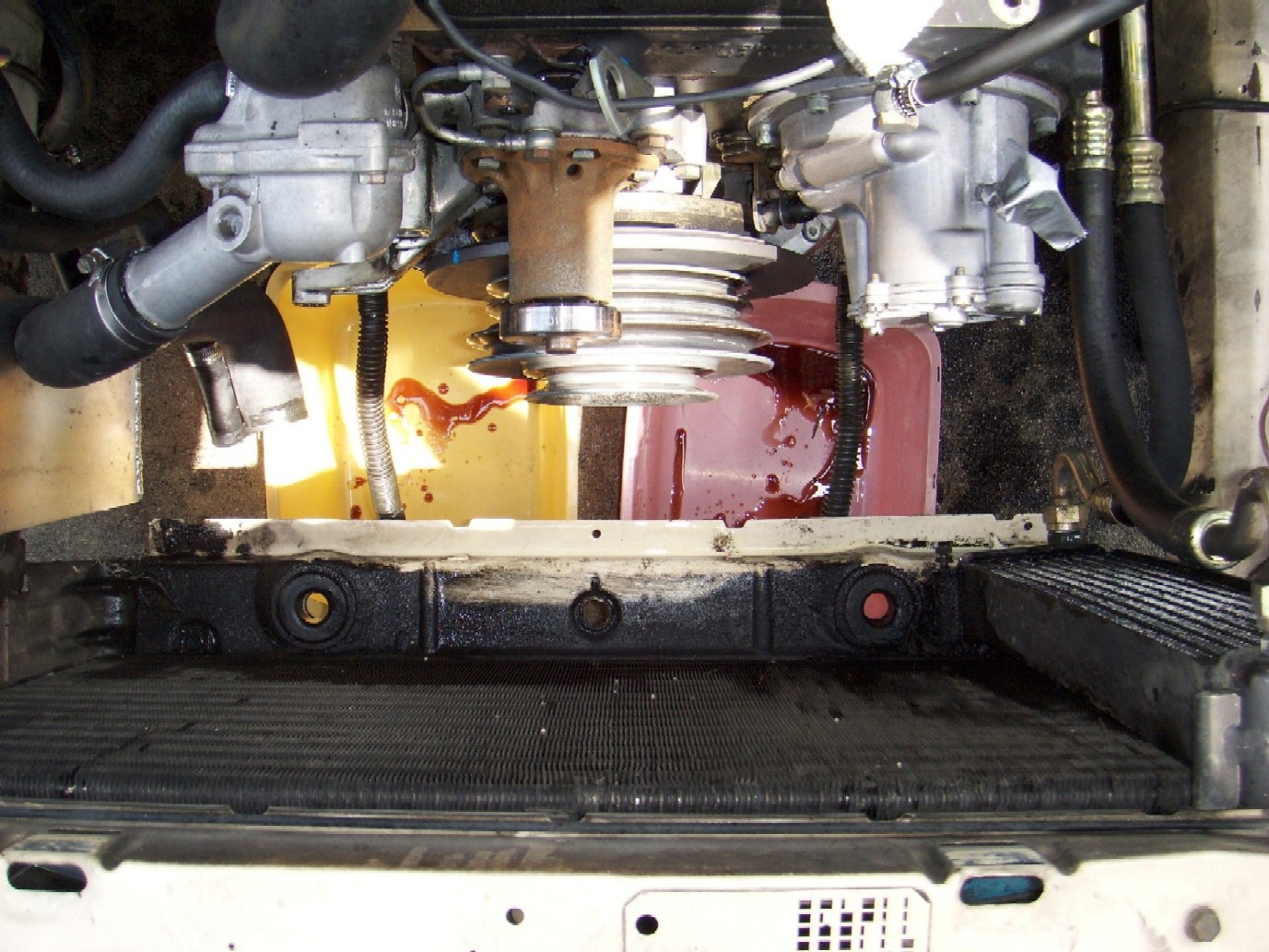

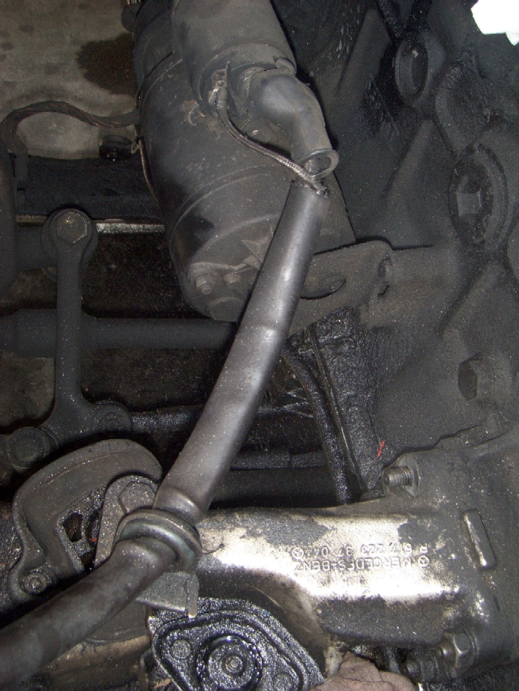

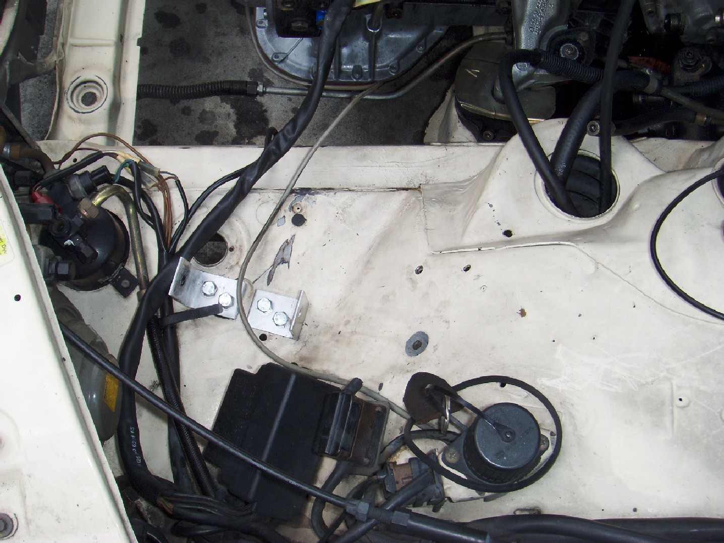

05-22-2010, 06:50 PM #143

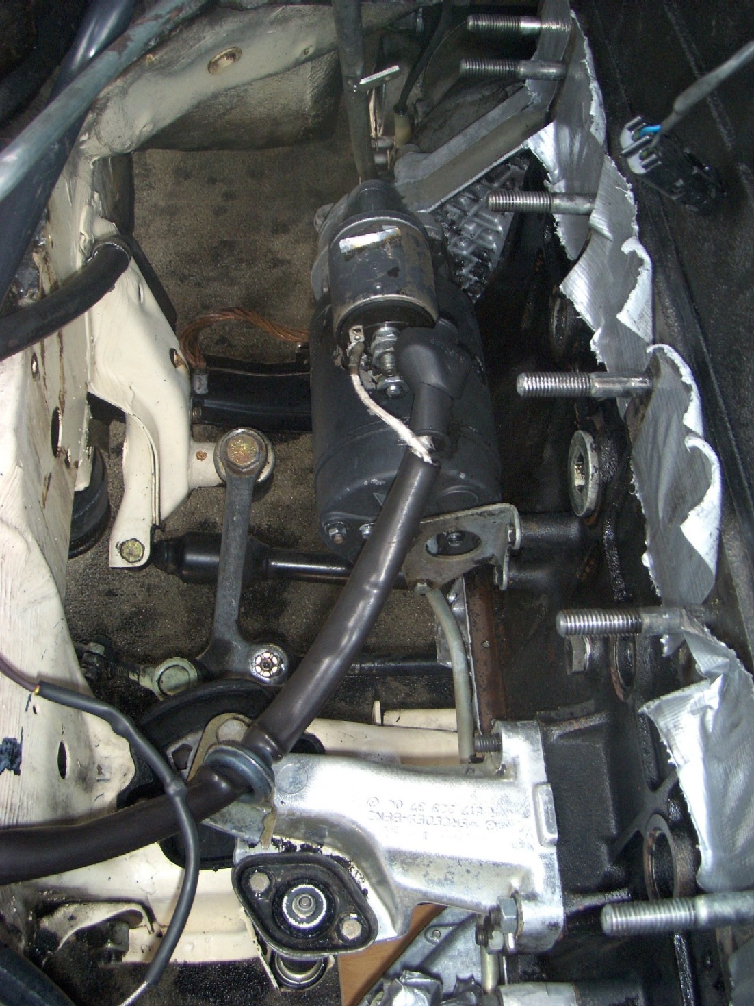

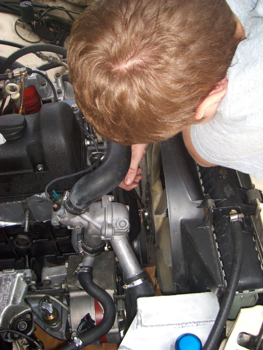

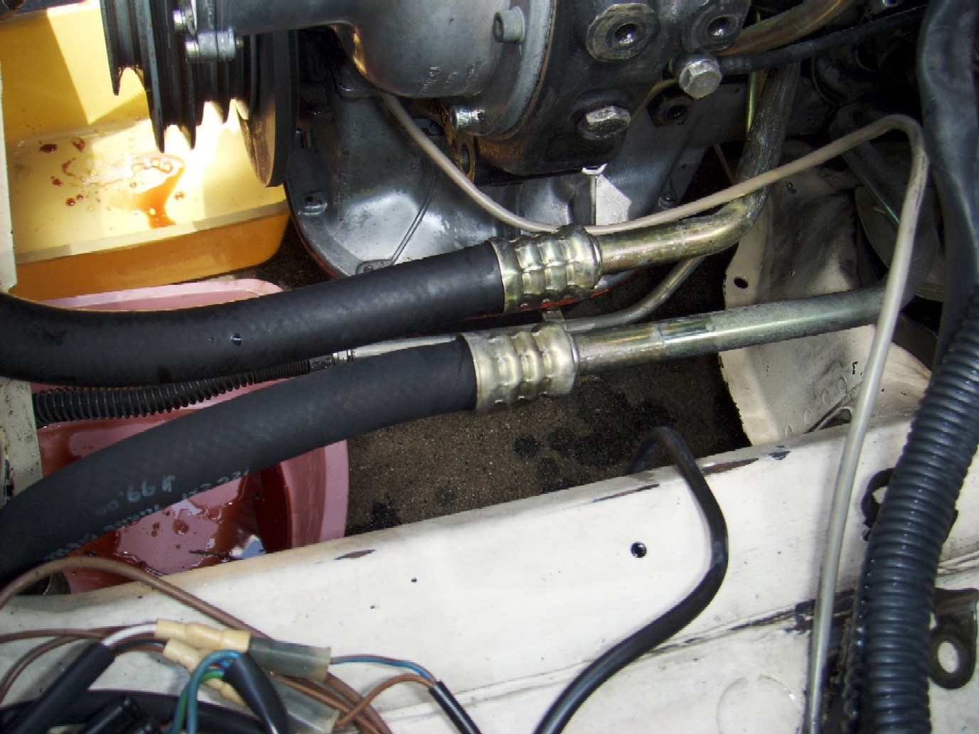

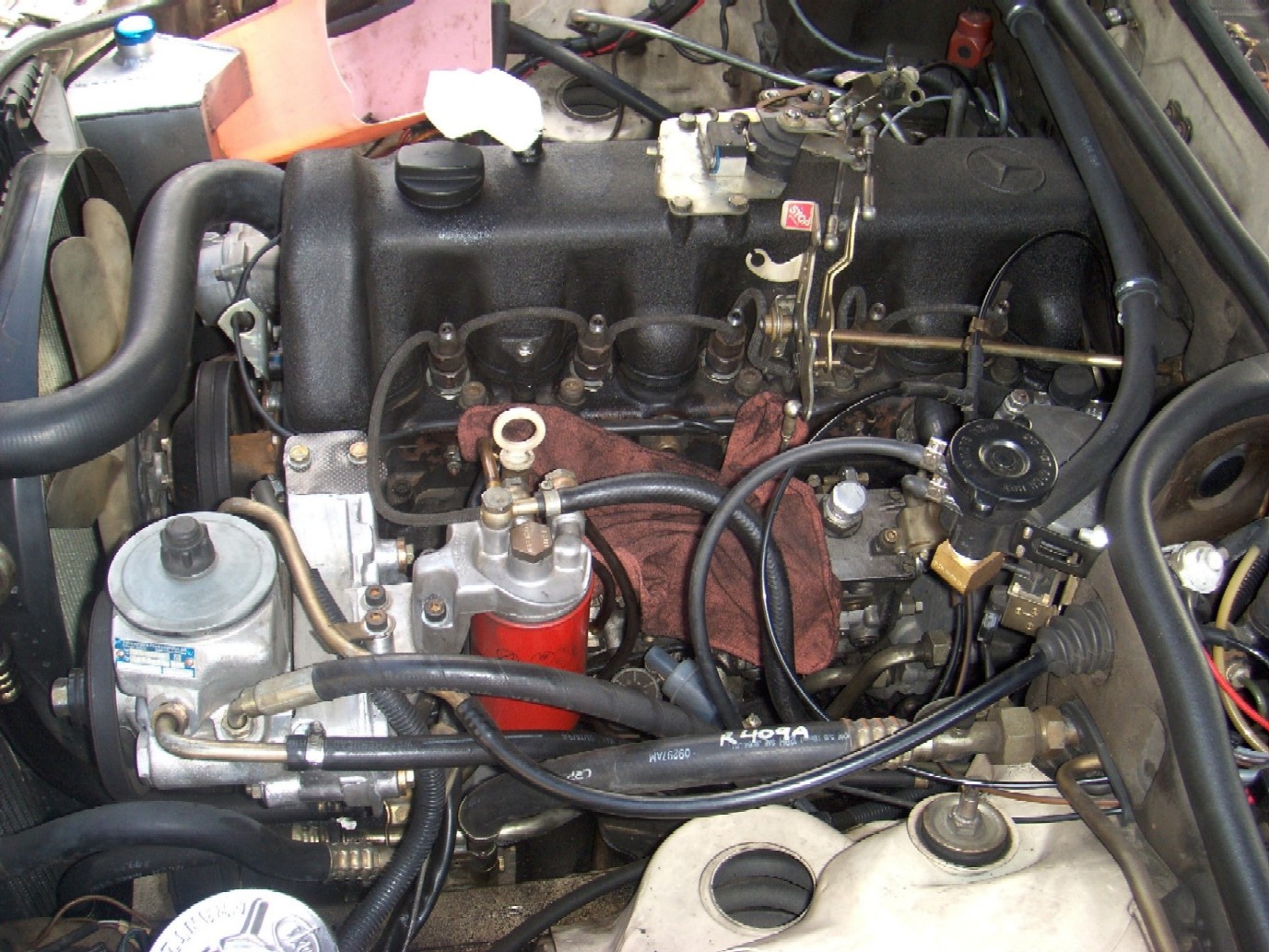

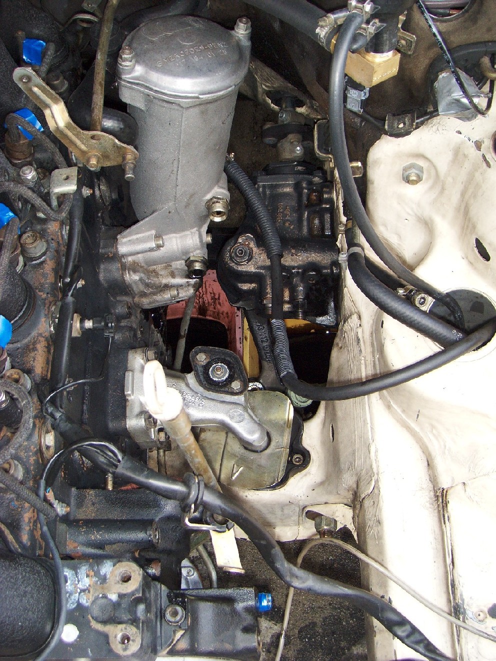

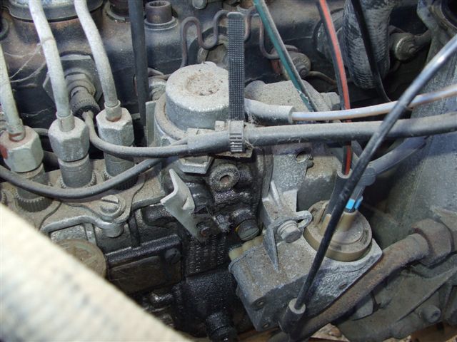

Well I started to tear down everything and get it clean so I can start getting the motor ready and the S/C installed to finish the project. My son is getting involved in the project and it is really cool that he is interested - he is 14 and sometimes has other things on his mind. Today was a good father and son bonding time. Here are a few pics from todays work:
Pic of engine before cleaning
Front of engine before cleaning
Side of engine before cleaning
Starter motor before cleaning
Top view of MW pump
Right side after some cleaning with orange based cleaner
Another view of right side after cleaning and view of sub frame
My son removing fan bolts

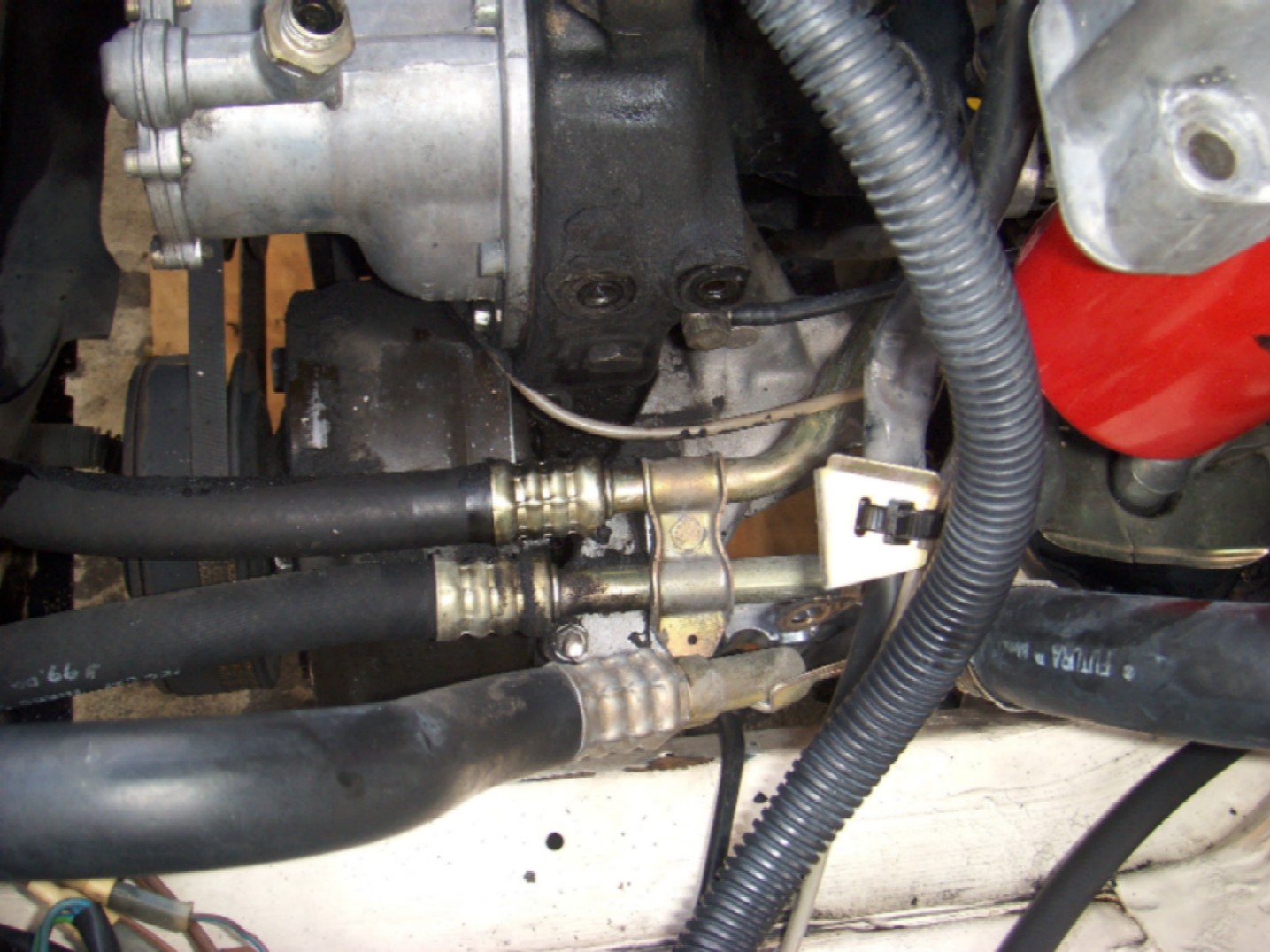

Power steering pump and bracket removal
View of A/C compressor
Front of engine with radiator removed
another view of front of engine
View of left side of oil pan
Front view of engine after cleaning
There is still more cleaning to be done, I want it as clean as I can get it. The orange oil based cleaner from Greased Lightning seems to work the best and using an electric power washer helps also.
More to come tomorrow....
05-22-2010, 07:28 PM #144
50/50 diluted purple power/water works great! I used it to get diesel oil off my shop floor and on my engine before power washing
This post was last modified: 05-22-2010, 07:29 PM by willbhere4u.
05-22-2010, 07:56 PM #145
(05-22-2010, 07:28 PM)willbhere4u 50/50 diluted purple power/water works great! I used it to get diesel oil off my shop floor and on my engine before power washing
I 2nd Purple Power. Got to be careful with aluminum though, it can discolor or stain it.

05-22-2010, 08:14 PM #146
(05-22-2010, 07:56 PM)DeliveryValve
That is the reason I chose not to use it. The orange based, which uses D-limonine seems to work great on soot too. I appreciate the feed back.

05-23-2010, 05:59 PM #150
Removed the IP, fuel filter, oil lines, and power steering lines today. I did some more cleaning and I think I am at the point of completion - there are a few stubborn spots, but I can live with that. Anyone want to buy some oil cooler lines, power steering pump or other parts?Big Grin
Here are a few more pics:
Tomorrow I will dry fit the S/C and see what it really looks like in the engine compartment.
Rudolf_Diesel
