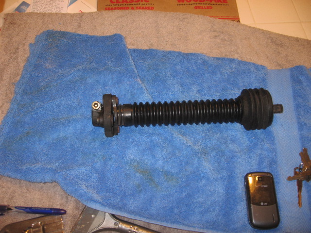

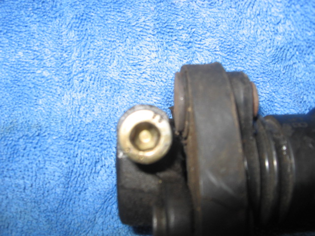

11-08-2012, 09:07 PM #64
Tried to get the box in and super problems.
All went well until I tried to put on the coupler. Apparently, the coupler is now 1 1/2" too short or my steering column is 1 1/2 " too short.
Any thoughts. Here is a super crappy picture. I am royally ticked. Got stranded. Had to call the wife. Now, everyone in the house is PO'd and not sure why. WTF

11-09-2012, 07:03 AM #67
Morning everyone,
Puzzled solved in theory. There is a 369mm steering shaft particular to this application whereas I have 322mm. So, my car sat overnight stranded. After taking my Dad to the doctors this AM, I will have to go at it again and re-install the power unit until I can regroup. Very ticked off right now at myself. The peep hole method worked perfectly to line up the center point. Very very simple. I really hate starting a task or project only to be defeated and not get anything done. That's the worst for me. I had this last weekend when I did the valves and injectors. The PO forgot to mention that he or his "Indy" used silicon caulk as a sealant on the VC and VC gasket and that crap was everywhere. Instead of 1-2 hours max, it turned into a 5 hour job. Now, this to start off the weekend. Whine .... LOL. The steering shaft appears to be super simple to remove and install. Just need to find one right now.

11-09-2012, 08:24 AM #69
Sorry to hear your having trouble with the box.
I guess you need this part number.
A 123 460 48 09 STEERING SHAFT - FOR MANUAL STEERING,BOTTOM
A 123 462 12 96 BOOT - MECHANICAL STEERING
Where else for reference sakes, you currently have this.
A 123 460 47 09 STEERING SHAFT - FOR POWER STEERING,BOTTOM
A 123 462 13 96 BOOT - POWER STEERING

I got a lead on the steering shaft from the guy I got the box from. Hopefully next week I will have it.
If not, machine shop wants $60 bucks to make one which is super doable, although I prefer no R&D on something like this.

Here is a picture of the 322mm steering shaft. I need the 369mm shaft ...what's another 47mm of shaft anyways.

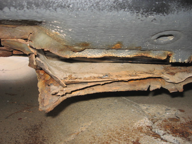

I think I am going to totally abandon any work on the body since my efforts today revealed how horribly rotten the body is. I will post a picture of the passenger side tomorrow. A 15' footer picture. That was a term used by the PO to describe this little gem.
Here is one picture. I put about 1/2 my weight by kneeling down and the floor went with me. I never had that happen to me in a car.
The picture I will post tomorrow will show what looks like the entire or most of the passenger floor pan hanging about 4-6" from the car. I am afraid to touch the drivers side now. So, I think its time to do all the mechanical stuff and mod's to the engine and start really looking for a rust free donor car. What I got really is not safe to drive.

thats a shame about these cars, the vinyl inner and outer coating on the sheet metal is so thick, that a huge hole looks like a rusty seam, as the metal disappears, but the undercoating keeps everything in place.
that pic I posted earlier showing the entire side of the car metal removed had similar initial rust locations to you as they appeared with a cursory inspection. My hair got progressively whiter as I peeled back the vinyl and found less and less floor. Big Grin

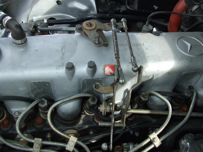

I meant reworking the linkage for Cap's application. Although I now realize he still has the auto trans. Which changing stuff over would mess with the Bowden cable.
However there is a possibility it could be adapted to your setup Mark. You can use your current pivot arm on the valve cover leading to the injection pump and incorporate the turbo style rod leading to the firewall.
Here is what I had in mind for cap. Pic courtesy of charmulu.
Much simpler but lacks Bowden cable attachment points.
For a more direct movement, The w116 300sd linkage does have a rubber bushing in between the rod that goes to the firewall and the pivot arm on the valve cover. I think there is a possibility to bolt that setup together. I've seen a pic of it around the net in the past. I would need the linkage on hand to confirm it.
