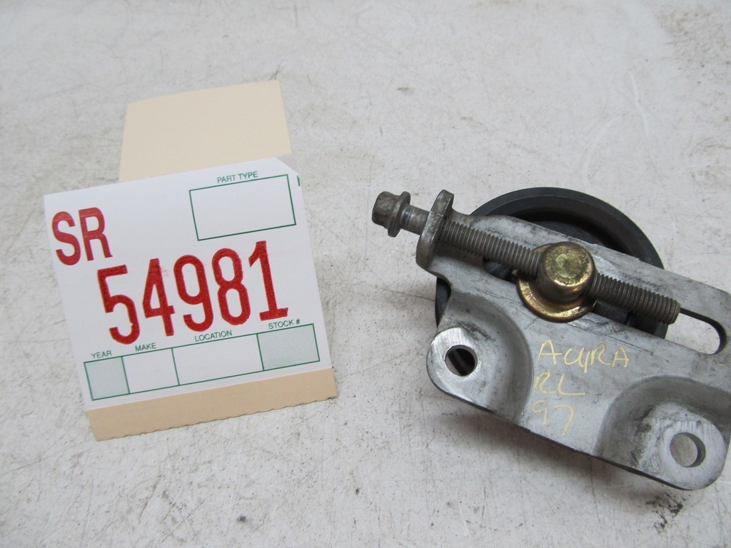

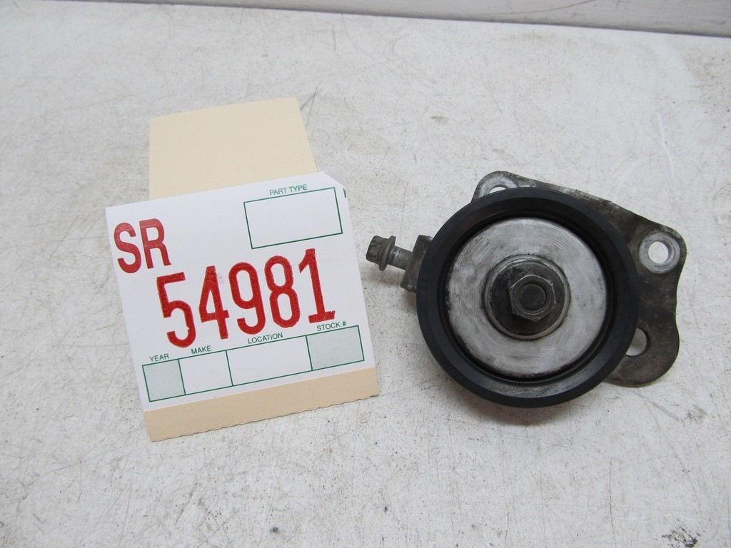

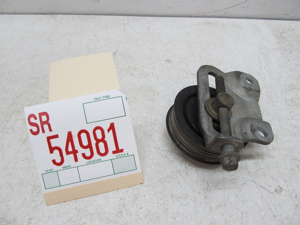

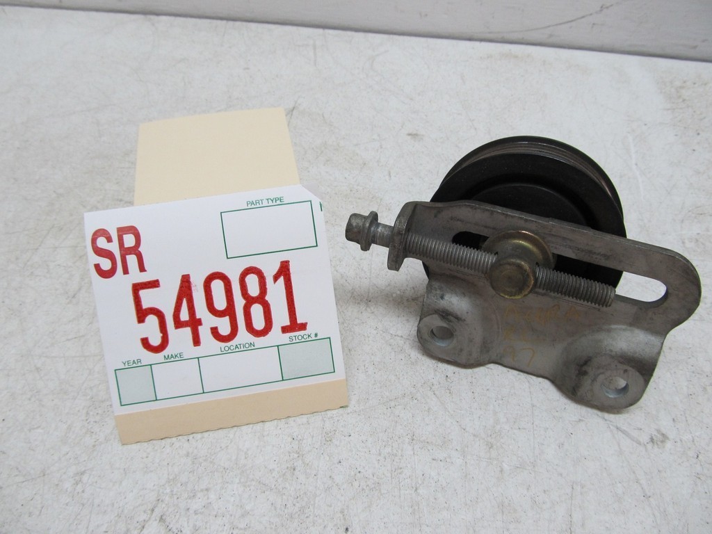

04-17-2012, 12:55 PM #65
(04-17-2012, 07:54 AM)Simpler=Better Cool. I'll yank a junkyard serpentine tensioner sometime, and beef up the bracket.
I think something like this would work well. This is from a Honda and then you can get a V-Belt style pulley in place of the ribbed pulley if you are going use a V-Belt.

04-17-2012, 01:59 PM #66
I was thinking of welding on a bracket for an auto tensioner from a serpentine system to press on the back of the vbelt pulley

04-17-2012, 02:08 PM #67
(04-17-2012, 01:59 PM)Simpler=Better I was thinking of welding on a bracket for an auto tensioner from a serpentine system to press on the back of the vbelt pulley
You may have to test that theory, but I think the loading is different on a V-Belt vs serpentine. So I think the spring tensioner will not be sufficient to holding the v-belt down. That's why I think a fixed slider bolt tensioner would be better equipped to handle the the load.
The other thing about using a serpentine spring tensioner is I don't think a V-Belt is made to also bend in the other direction. This will definitely shorten the life of a V-belt by allowing it to quickly crack on the underside "V" once it gets older. Keeping the V-belt the same orientation will allow a longer service life.

04-18-2012, 08:00 AM #69
Thanks for the advice guys, I'll go with the traditional belt tightening setup. As for the shutoff, I grew up driving diesel tractors with STOP knobs....so you can see where I'm coming from on the shutoff idea...

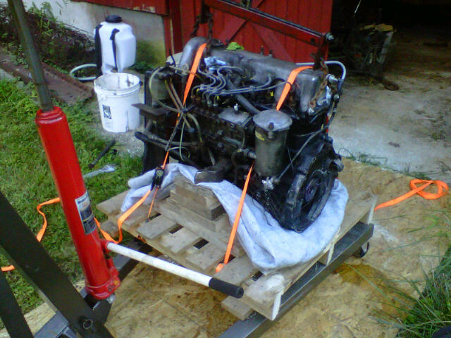

08-03-2012, 09:08 AM #74
She's drained, strapped to a pallet (by the motor mounts & block, not the pan) and all crated up. I'll be "pausing" my project for a little while, for $20/month it will be stored safe and sound in a secure / insured warehouse Smile
