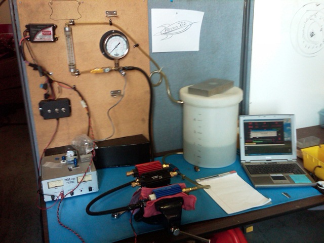

07-12-2010, 10:07 PM #69
While you can only do real world testing in the real world I have the next best thing. Tomorrow morning I will start testing with diesel fuel and one of our fuel pumps and Fuel On Demand. This should be a good compatibility test as I can adjust and monitor line pressure, flow, and current draw by the pump.
07-14-2010, 12:34 PM #70
Well day one of the pump testing went great! It seem the pumps love diesel... they operate quieter and when the fuel warms up and thins out they flow the same as gas (Heptane).
The lowest temp I could test at was 75 degrees this morning.
