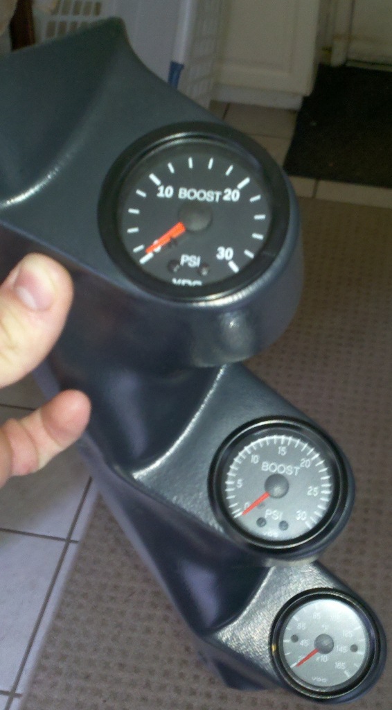

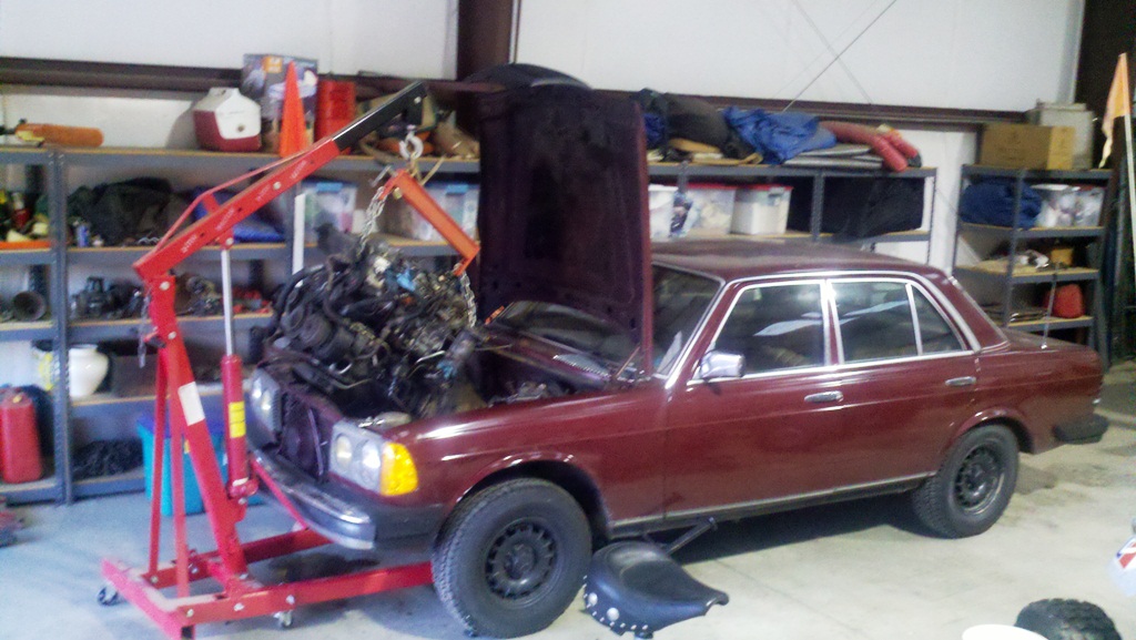

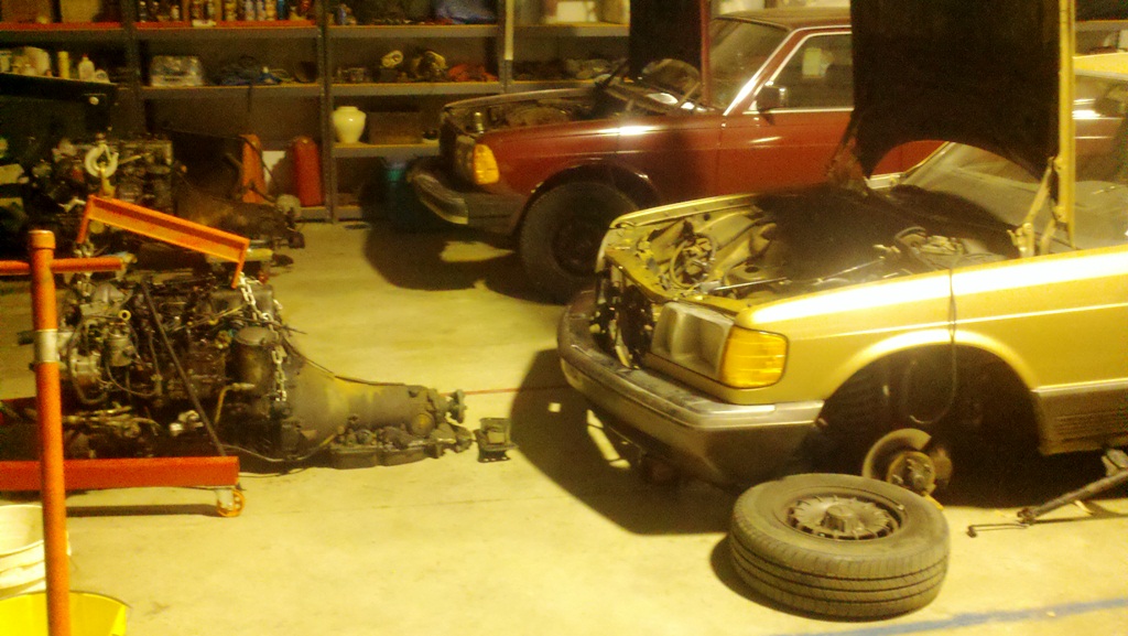

RE: Captain's '82 300D - Captain America - 04-23-2011 There's a lot of meat back there but she should be able to pull it off no problem. I bought Rudolf's gauges off him, waiting for those to show up. Boost, EGT, EMP RE: Captain's '82 300D - Captain America - 04-25-2011 Progress... RE: Captain's '82 300D - DeliveryValve - 04-26-2011 Let's see a detailed engine bay! . RE: Captain's '82 300D - Captain America - 04-26-2011 (04-26-2011, 03:09 AM)DeliveryValve Let's see a detailed engine bay! Its about as detailed as its gonna get. I'll lightly clean it, wash off the rust water and such but its just gonna get dirty again so there's really no use making it super clean. RE: Captain's '82 300D - Greazzer - 04-26-2011 how long did it take to pull the engine / trans ? Looking at the Harbor Freight Lift and stand, 2,000 lbs rated. I need to replace head, and my guess every gasket since they all seem to leak. Would this be do-able in a weekend? RE: Captain's '82 300D - yankneck696 - 04-26-2011 When I worked at the salvage yard, we'd have that combo out in 1 hour tops with 2 people. That would be no cutting, unbolting everything, unplugging everything, undoing all hoses & capturing as many fluids as we could. Also, that would be with air tools & a torch to "break anything loose". Here's my hints: spray everything down with PB Blaster for a week prior & have a friend or friends to help. Air helps greatly, heat stubborn bolts with torch (minimum MAP gas) & then douse with PB to crack loose. If you're removing fastners that are getting tighter as you go, tighten them up & respray with PB & wirebrush them & then PB again. As for a pull, regasket, then install in a weekend, unless you are adept at it, don't even bother trying. Make a plan as to what you want to get done on the engine & do it all as you have it out for a week. You WILL break, crossthread, strip, tear, rip or bend something if you set a weekend's time for it all. That way, you can cover all contingencies. Get a hold of a good torque wrench & just take your time to do it right while you have it out. Ed RE: Captain's '82 300D - Captain America - 04-26-2011 (04-26-2011, 03:08 PM)Greazzer how long did it take to pull the engine / trans ? Looking at the Harbor Freight Lift and stand, 2,000 lbs rated. I need to replace head, and my guess every gasket since they all seem to leak. Would this be do-able in a weekend? I had it ready to come out in an hour and a half. Pulled it myself, No help. No air tools or anything special. I don't like air tools. I didn't have any stubborn fasteners. I wouldn't rush what your trying to do in one weekend.. I would spend a week at it, maybe an hour a day just R&R'ing cleaning and all... Take your time. That's what I am doing, no reason to rush. RE: Captain's '82 300D - stan - 04-27-2011 agreed. i budgeted a month for my engine swap, so things could go at a relaxed pace. i could have had the old engine pulled and the new engine in in a weekend if i busted my ass and had a helper, but its so much nicer to be able to have time to twiddle with things, deal with unanticipated repairs, etc. one thing i would suggest considering if you're going to regasket is new hardware. lowes has a good selection of metric grade 8 bolts and nuts, and most of the stuff on our cars can be found there. next time im doing major work on an OM i would definitely get new nuts / bolts / washers wherever possible. i think its a nice touch and one less thing to be a pain in the ass when you work on the car later. RE: Captain's '82 300D - Captain America - 04-28-2011 So input needed. The SD motor and trans has the electric speedo and oil pressure. Is it hard to adapt that stuff into the 300D? RE: Captain's '82 300D - DeliveryValve - 04-28-2011 Adapt? Too hard. But swapping is easier. Best way is to take the oil filter housing from the 300D motor and swap it into the 300SD motor. You should replace the housing gasket anyways because they tend to leak with over 100,000 miles plus on them. For the trans, the best way is to also take the tail from the 300SD trans and swap it out with the 300D trans so you can have the mechanical input. . RE: Captain's '82 300D - Captain America - 04-28-2011 Thanks buddy, But crap! I was hoping I could have fancy electrical gauges! haha Might be time to purchase that oil filter housing plate! RE: Captain's '82 300D - Captain America - 05-02-2011 Started ripping apart the SD. Freakin tube nuts stripped both fittings on the oil cooler.... Good thing I have 3 extras haha RE: Captain's '82 300D - makin' smoke - 05-02-2011 I don't want to say "I told you so". About the extra oil coolers you have. Its pretty bad ass that you have a mini personal pick-a-part going on. RE: Captain's '82 300D - Captain America - 05-02-2011 It sure was reassuring to find only TWO bolts holding the drive shaft to the double rubber dumper attachment (harmonic damper / Flex joint) Its pretty interesting to find all the things Mercedes did to make the ride more comfortable in the SD's versus the D's.... RE: Captain's '82 300D - Captain America - 05-04-2011 Eh, Just pics ... 60 Trim baby Had to do this to get home, Then just kept on since it wasn't leaking. I give madd props to the hose for taking the abuse! Fancy Housing wrench mmmmm Pretty Yuck! That's on the SD haha Biggest Widow I've seen in a while RE: Captain's '82 300D - Captain America - 05-08-2011 Got some goodies from Rudolf Yesterday... Intake boost, Exhaust Manifold Pressure, Exhaust Temp He is also welding up the outlet of my compressor housing to accept a silicone elbow to go into the Intercooled Manifold RE: Captain's '82 300D - willbhere4u - 05-08-2011 nice! want RE: Captain's '82 300D - aaa - 05-08-2011 It's so... big. RE: Captain's '82 300D - JB3 - 05-08-2011 shame that paint didn't really hold up long term on it! you should strip it off and shine it up nice nice, awesome score. Rudolf is a magician with finish quality, everything is really well done, show off the welds! RE: Captain's '82 300D - Captain America - 05-08-2011 (05-08-2011, 09:03 PM)dropnosky shame that paint didn't really hold up long term on it! Exactly what I plan to do. Then might clear powder coat so it will easily clean with the wipe of a cloth RE: Captain's '82 300D - DeliveryValve - 05-09-2011 Nice grab of Rudolf's stuff! Can't wait until we see this thing rock! . RE: Captain's '82 300D - winmutt - 05-09-2011 Purty. RE: Captain's '82 300D - Captain America - 05-09-2011 (05-08-2011, 08:58 PM)aaa It's so... big. That's what she said ![]() RE: Captain's '82 300D - Captain America - 05-14-2011 Oh baby, Some of Rudolf's fab work RE: Captain's '82 300D - 85-300Dt - 05-14-2011 (05-02-2011, 03:31 AM)Captain America Started ripping apart the SD.there's a repair kit from the stealer RE: Captain's '82 300D - Captain America - 05-14-2011 (05-14-2011, 05:15 PM)85-300Dt(05-02-2011, 03:31 AM)Captain America Started ripping apart the SD.there's a repair kit from the stealer Repair kit? How would that work? Both engines on the floor.... As you can see the SD trans mount wasn't exactly mounting anything... I unbolted it and it fell off haha RE: Captain's '82 300D - 85-300Dt - 05-16-2011 http://www.peachparts.com/shopforum/album.php?albumid=76 RE: Captain's '82 300D - Captain America - 05-16-2011 (05-16-2011, 03:42 AM)85-300Dt http://www.peachparts.com/shopforum/album.php?albumid=76 Guess that works! RE: Captain's '82 300D - Captain America - 05-30-2011 Surprised how clean everything was under the valve cover of the SD engine Is this the stock timing chain??? RE: Captain's '82 300D - Captain America - 05-31-2011 Think the Cam Timing is el perfeto! RE: Captain's '82 300D - DeliveryValve - 05-31-2011 (05-30-2011, 05:21 PM)Captain America .. JWIS is the OE chain. But I never seen one with pins crimped liked that. . RE: Captain's '82 300D - dieselboy - 05-31-2011 this thing still isnt done? RE: Captain's '82 300D - mr_manny - 05-31-2011 lucky ![]() RE: Captain's '82 300D - Captain America - 05-31-2011 (05-31-2011, 10:41 PM)dieselboy this thing still isnt done? Settle down buddy. It started as a down n dirty swap and has progressed into much much more... ![]() (05-31-2011, 10:33 PM)DeliveryValve(05-30-2011, 05:21 PM)Captain America .. Hmmm? I have been amazed by Phosphoric Acid!!!! Mr. Dropnosky sent me a pile of rust that he called an exhaust manifold lol ( ![]() The first two pics are after I Brushed off the crusties ![]() ![]() Then the magic... ![]() ![]() ![]() ![]() The poor old engine is history for sure... Poor little guy, such a slow and painful death ![]() ![]() RE: Captain's '82 300D - Captain America - 06-04-2011 Is there major differences between MW Pumps? 1982 300D: ![]() ![]() ![]() ![]() 1981 300SD: ![]() ![]() ![]() What are those stamped numbers by No. 1 Injector line? Exhaust manifold is tits now! ![]() ![]() ![]() ![]() ![]() ![]() RE: Captain's '82 300D - tantank79 - 06-05-2011 I got phosphoric acid in my eye the other day. It sucked, to say the least. RE: Captain's '82 300D - Hercules - 06-05-2011 (05-30-2011, 05:21 PM)Captain America Surprised how clean everything was under the valve cover of the SD engineYes, stock,later versions ,link pins not spun,outer part crimped RE: Captain's '82 300D - DeliveryValve - 06-05-2011 (06-05-2011, 10:41 PM)Hercules Yes, stock,later versions ,link pins not spun,outer part crimped Are you saying that's an earlier chain? And your saying the later versions have the outer part crimped? . RE: Captain's '82 300D - mike-81-240d - 06-05-2011 (06-05-2011, 07:57 PM)tantank79 I got phosphoric acid in my eye the other day. It sucked, to say the least. ![]() ![]() ![]() ![]() RE: Captain's '82 300D - DeliveryValve - 06-05-2011 (06-04-2011, 08:28 PM)Captain America Is there major differences between MW Pumps? Those particular pumps should be the same. I see the same part numbers. Later there are some variations to the housing like sensors and a port a locking pin tool. Don't know what those stamped numbers mean. Maybe our resident IP expert in Sweden could tells. dieselmeken are you listening? . RE: Captain's '82 300D - Hercules - 06-08-2011 (06-05-2011, 11:37 PM)DeliveryValveYes,connecting pins no longer spun,May be new old stock,still good. Recommend replacement 130,000 mi. Hard to tell a customer,after engine swallowed a chain,Well mbz said it was ok!!! All knowledgeable shops replaced at this mi.(06-05-2011, 10:41 PM)Hercules Yes, stock,later versions ,link pins not spun,outer part crimped RE: Captain's '82 300D - JB3 - 06-09-2011 Wow, there was metal under there! ![]() RE: Captain's '82 300D - Captain America - 06-09-2011 (06-09-2011, 07:23 AM)dropnosky Wow, there was metal under there! You guys need a pool of phosphoric to drive your cars through! RE: Captain's '82 300D - led-panzer - 06-09-2011 Are you going to have it coated or paint it? RE: Captain's '82 300D - Captain America - 06-09-2011 Ceramic coated by the company that does the headers at my work... something like $30-40 RE: Captain's '82 300D - Captain America - 06-16-2011 WTF Mercedes... ![]() RE: Captain's '82 300D - aaa - 06-16-2011 I'm happy I've only encountered the 12-point nuts so far. RE: Captain's '82 300D - Captain America - 06-17-2011 It's BS! Both of my 722's have that thing RE: Captain's '82 300D - dieselboy - 06-17-2011 Mine had that too. I made a socket an ended up not needing it for the spare trans. I'll look to see if I still have it. RE: Captain's '82 300D - Captain America - 06-18-2011 I made a sweet tool out of pipe. I knew the metal was too soft but what the hell... ![]() ![]() Yeah, That didn't work lol. ![]() ![]() ![]() EVERYTHING had silicone all over it ![]() ![]() ![]() Now that I pissed off all the purists out there, heres the problem: The mechanical speedo gear has a oil squirter for the gear and the elec. one does not! What to do ![]() ![]() ![]() ![]() ![]() I think converting the mechanical gauges over to electric is looking better and better Wha chu think about that almighty DV? ![]() |
