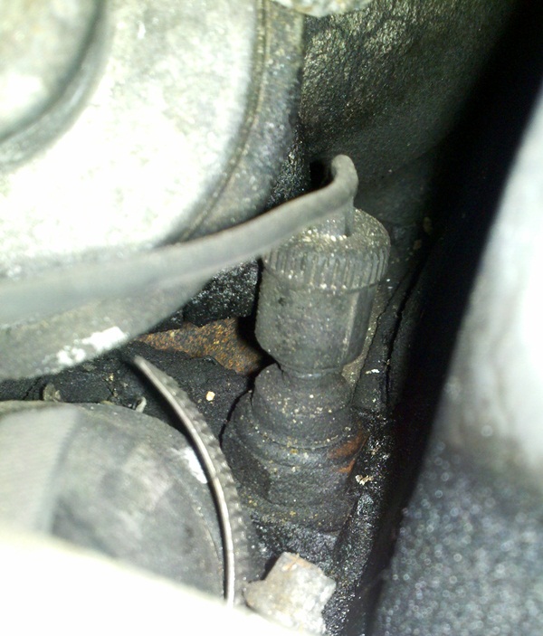

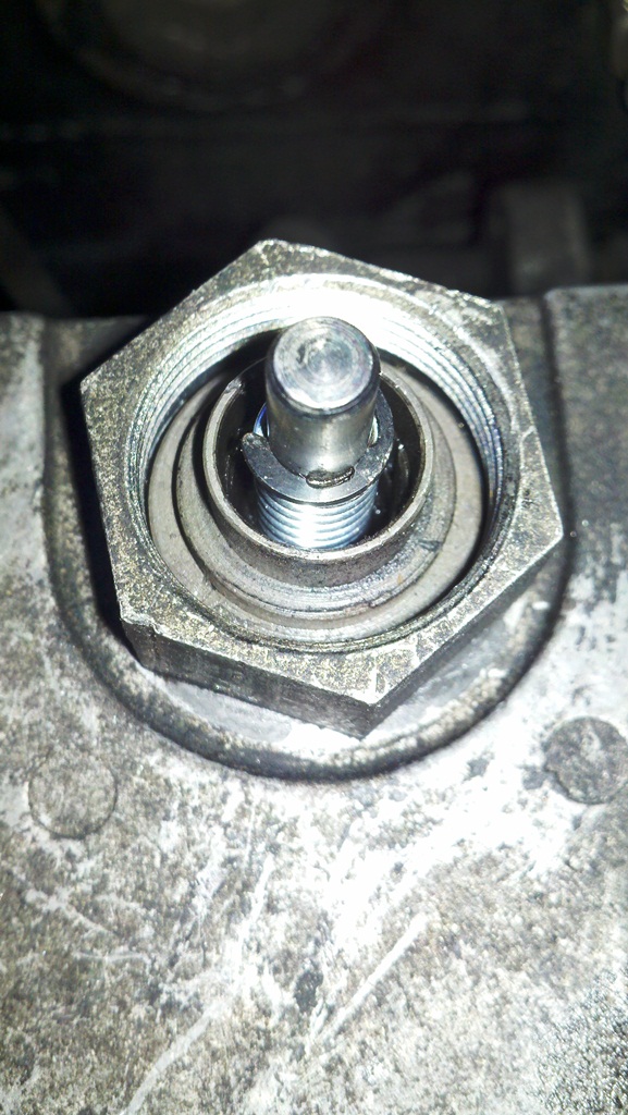

RE: Captain's '82 300D - Captain America - 02-28-2011 Well I backed out the ALDA screw as far as it would go. I only went 1 turn and then stopped. I didn't force it any further. Its pretty peppy now! Will it back out further? I don't wanna break anything... RE: Captain's '82 300D - winmutt - 03-01-2011 You will break things. Was the cap already off? RE: Captain's '82 300D - DeliveryValve - 03-01-2011 Speaking from my purest save all classic Mercedes side... Capt'n, you really going to tear the motor out on that SD and swap it in with your 300D? That's a nice looking, good running SD.... With original Cali Blue plates. I think it would be a shame to put her down. Unless something is seriously wrong with the the body. . RE: Captain's '82 300D - led-panzer - 03-01-2011 I would tell you to pull it right off and see how you like it but that seems to be an unpopular move with most people. You can always put it back on. RE: Captain's '82 300D - garage - 03-01-2011 Yeah capt i was just wondering the same things as winmutt and DV. Was the cap off the alda already? And what was your decision on keeping the SD vs. engine swap into the tank? RE: Captain's '82 300D - Captain America - 03-01-2011 The cap was on (siliconed). It was split, so I am unsure if someone had messed with it prior or not... It only puffs a very tiny amount of black when I go WOT from idle in park. This car does not smoke one bit. I mean NO smoke, EVER. In all reality My father is trying to keep me from tearing this car apart too. But I really don't like how big this thing is! + My D is so much more nimble + I like this color + Has better paint + Lowered already + Rebuilt suspension + Battery relocated + Electrical and vacuum mods done. - Rear smashed up a bit + perfect interior can be pulled from the NA car and swapped into the maroon... Nothing is seriously wrong with the SD, but it does have a couple issues: - The front brakes are fucked and the car shakes like crazy when applied - interior is kinda trashed - Paint is flaking from being sprayed without any sanding or prep work on original paint - Different front passenger fender I just think the D is a better car than the SD... I may pull the 617 out of the D and just rebuild instead of doing a swap... I don't Effffing know, I cant make up my mind RE: Captain's '82 300D - garage - 03-01-2011 I vote for the tank getting a new engine! RE: Captain's '82 300D - Captain America - 03-01-2011 That's definitely where im headed Garage! Will post nasty pics of the SD in a min ... All the seats are Effffffed Some Nice prep work huh? lol QUESTION: Will completely removing the ALDA deliver more no boost fuel than having the screw backed all the way out? RE: Captain's '82 300D - led-panzer - 03-02-2011 Yes. If you floor it from a stand still you will leave a decent black bomb. But you can control it with your foot, if you accelerate normally there's no smoke. You won't be rolling coal at every stop light. RE: Captain's '82 300D - garage - 03-02-2011 I vote for the tank just because the w126 isnt that grrreat of a performer offroad in comparison to the w123. The w123 is over all just a more fun car, its lighter and more nimble. You cant toss the w126 around corners like you can toss the w123.. RE: Captain's '82 300D - Captain America - 03-02-2011 (03-02-2011, 07:05 AM)led-panzer Yes. If you floor it from a stand still you will leave a decent black bomb. But you can control it with your foot, if you accelerate normally there's no smoke. You won't be rolling coal at every stop light. Black bombs are sweet! I will possibly remove it tonight. Or right now.... (03-02-2011, 10:39 AM)garage I vote for the tank just because the w126 isnt that grrreat of a performer offroad in comparison to the w123. Exactly RE: Captain's '82 300D - Captain America - 03-03-2011 Relocated the kick down switch... Don't mind the unfinished wiring. Once I decide I like it, I will solder everything up nice. Just realized that this switch doesn't provide as much control as I wanted.... Seems like it depends on bowden cable position too. RE: Captain's '82 300D - ForcedInduction - 03-03-2011 I don't bother with the floor switch. I use a DPDT on-off-momentary switch on the dash to control kickdown when I want it. RE: Captain's '82 300D - Captain America - 03-03-2011 Yeah I was going to do a momentary on the side of the shifter handle like I did in the tank, but thought that's this is much better since I didn't need to buy a switch and I just press it like the high beam switch in an old GM car. Plus the switch still gets used and doesn't get all lonley under the diesel peddle! ![]() RE: Captain's '82 300D - Captain America - 03-11-2011 So this car runs COLD unless I'm on the pipe or its warm out. Thermostat is new. Looks to have more anti freeze than water... Anyway, Attempting to put some electric fans on it that I had laying around... Bought a 185 degree on 175 degree off switch to put in the T-stat housing in place of the vacuum switch... Yeah well that 10mm x 1.0 thread is kicking my ass. Didn't really wanna buy a die for this but it seems to be rarely used thread. Starting to annoy me! RE: Captain's '82 300D - Captain America - 03-12-2011 Revvs a little nicer and warms up nice and quick without the mechanical fan Recent vids: RE: Captain's '82 300D - Captain America - 03-15-2011 There is just no easy way to put a temp switch in the thermostat housing. This almost worked... RE: Captain's '82 300D - ForcedInduction - 03-15-2011 Why not use the one that comes with the car....? RE: Captain's '82 300D - Captain America - 03-15-2011 The 40C switch? Or is it? RE: Captain's '82 300D - ForcedInduction - 03-15-2011 The EGR's vacuum thermovalve. If I can assume you're like 99.9% of the rest of the people here with a "non operational" EGR then that valve is only taking up space. The valve's port can be drilled and tapped (off the car) from 1/8NPT and up, including M10 used by Mercedes' temperature sensors/switches. The 78-79 W116 300SD used a 100*c switch to control the front A/C fan. A feature they removed from .95x engine starting in 1980. RE: Captain's '82 300D - Captain America - 03-15-2011 I was trying to avoid taking the housing off the car to tap it. I wanted to stick a temp switch in the 10 x 1.0 mm hole but there isn't a switch that size anywhere that I can find. Seems like the 10mm hole is a little big for 1/8" NPT but guess that depends on how deep you go with the tap. 1/4" would definitely work but 3/8" looks to big to me. The 100c switch would be perfect. what thread size is it? And do you have an idea of the 10mm x 1.0 size temp switches available? I'd rather not put a probe through the radiator... RE: Captain's '82 300D - Captain America - 03-17-2011 Can I get some help on what these switches are? They are off a '85 Is there a list of the temps switches with 10mm x 1.0 thread? RE: Captain's '82 300D - DeliveryValve - 03-17-2011 (03-17-2011, 09:32 PM)Captain America Can I get some help on what these switches are? They are off a '85That looks like the cold engine temperature shut off for the HVAC blower motor. (03-17-2011, 09:32 PM)Captain AmericaThat temperature sensor is for the 1985 only vacuum modulation system for the transmission. It's a 50ยบ C sensor. . RE: Captain's '82 300D - Captain America - 03-17-2011 Waaaaa FML RE: Captain's '82 300D - 300D50 - 03-18-2011 What sensor going where? I might be able to make an adapter for peanuts. RE: Captain's '82 300D - Captain America - 03-18-2011 All I want to do is put a temp switch where the EGR vacuum was to control my fan relay without drilling and tapping the thermostat housing. I cant find any switches that are 1/4" NPT either. RE: Captain's '82 300D - 300D50 - 03-18-2011 M10x1 on the outside, right? How long does the threaded section have to be, and what thread on the ID? I could make an adapter out of brass for the grand price of shipping and the warm fuzzy feeling of helping out. ![]() EDIT: Just read fully, I'm not sure of any temp SWITCH that will fit, but I have made an adapter for the Mitsubishi temp sensor in my truck that was 1/8 npt... Maybe throw together a quick comparator circuit with ratshack parts, and use a temp sensor? Would be a good beginners project in electronics. I forsee an LM393, an RS flip flop, and some random support components such as 2 variable resistors, a transistor to drive the relay, some protection diodes, and maybe some LED's to show state. Can also abuse a 555 timer to get the comparator and flip-flop, and reduce part count a bit. GAH, I'm rambling... RE: Captain's '82 300D - Captain America - 03-18-2011 (03-18-2011, 01:21 AM)300D50 M10x1 on the outside, right? Oh man! ![]() RE: Captain's '82 300D - 300D50 - 03-18-2011 Nope, it requires ~ 5 to 10 bucks in parts, a soldering iron, and patience. Nice beginners project in analog design if you were interested. Any temp switches smaller than 10mm that are in the right range? RE: Captain's '82 300D - Captain America - 03-18-2011 Nothing even close to 10mm. Everything is 3/8" and 1/2" NPT, 12mm, or 16mm. What I really need to do is drill and tap the EGT hole for the heater temp switch and drill the heater temp switch hole for 3/8" NPT RE: Captain's '82 300D - 300D50 - 03-18-2011 Uggh... Could one of the switches be shaved down and re-threaded? RE: Captain's '82 300D - Captain America - 03-18-2011 Theres a picture of that on the previous page haha RE: Captain's '82 300D - 300D50 - 03-18-2011 Woops... brainfart... Note to self, don't peruse forums while sick... RE: Captain's '82 300D - Captain America - 03-18-2011 Oh and congrats on the promotion! RE: Captain's '82 300D - Captain America - 03-21-2011 Removed the rack limiter out of the IP this weekend. No change in power... I need to make a socked to adjust the torque capsule Also ... I noticed the car started to get sluggish and lack power; boost was coming on a lot slower and was low. hmm... ![]() ![]() Went to the "gas" cap and slowly turned while listening and WHOOOOOOSH! The tank vent must be clogged or something... RE: Captain's '82 300D - Rudolf_Diesel - 03-21-2011 Want a pump 7.5 mm elements? ![]() RE: Captain's '82 300D - Captain America - 03-21-2011 Don't need to ask me twice! RE: Captain's '82 300D - garage - 03-21-2011 How long did it take you to remove the rack limiter capt? Did ya take the IP off the engine to do it this time? Who ever gets rudolfs pump is one lucky duck. lotsa fuel ![]() RE: Captain's '82 300D - Captain America - 03-21-2011 (03-21-2011, 02:49 PM)garage How long did it take you to remove the rack limiter capt? It didn't take as long as I thought. I didn't remove anything from the engine... I could probly do it in 1-2 hrs tops. I had it back together in like 30 min. RE: Captain's '82 300D - garage - 03-31-2011 Did you ever mess with the high idle screw on your IP? RE: Captain's '82 300D - Captain America - 03-31-2011 Not yet. I will when I make the socket to adjust the torque capsule RE: Captain's '82 300D - Captain America - 04-13-2011 These Speedo's are so annoying! I won a Sony Bloggie And was just playing with it... Takes some awesome 1080 Video, but I should have made it in landscape... Then some smart guy left the valve cover cap loose! ![]() Man what a mess... RE: Captain's '82 300D - dieselboy - 04-13-2011 Lol nice. My car will cruise at 85 and seems to run out of gear/ power at 117 RE: Captain's '82 300D - Captain America - 04-13-2011 Yeah I cruised from LA to riverside @ 80-85 no prob. She will keep going up to 4k at which I have no clue what speed that is... 70mph is right at 3k or so. RE: Captain's '82 300D - mike-81-240d - 04-13-2011 Video link failed hard core. ![]() Bloggies are really cool. RE: Captain's '82 300D - DeliveryValve - 04-13-2011 (04-13-2011, 03:05 PM)Captain America .. Time to get a GPS! At that RPM, I think your going about 95. . RE: Captain's '82 300D - Captain America - 04-13-2011 Better link! ![]() RE: Captain's '82 300D - Captain America - 04-15-2011 Since I like to shoot ALDA springs into outer space, I stopped by my local remodeled ACE Hardware today and found a whole drawer of em! Yay $.88! Maybe not the exact thing but its pretty damn good for walking into the store and having to guess what to get. No more nigger rig! (no offense intended ![]() RE: Captain's '82 300D - Captain America - 04-22-2011 Got her into the operating room for surgery ... Starting in the morning Going to put the turd SD in there next to the D and pull the engine too. Set both on the ground next to each other and Glow Plugs from bad motor to good (They are new) Turbo from bad motor to good (60 trim) Tune IP Torque control , High rpm, course idle (on the floor) Valve adjustment and check timing chain IP Timing, Marks are not lined up... Water pump from bad motor to good (new) RE: Captain's '82 300D - makin' smoke - 04-23-2011 I wanna see some smoky burnouts! "The tank" should be puttin down the power after the transplant. |
