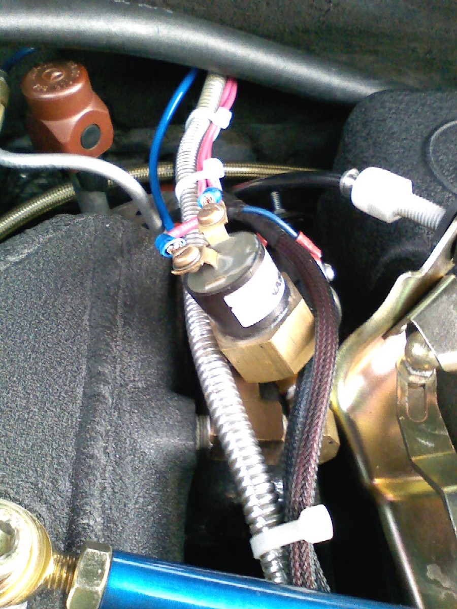

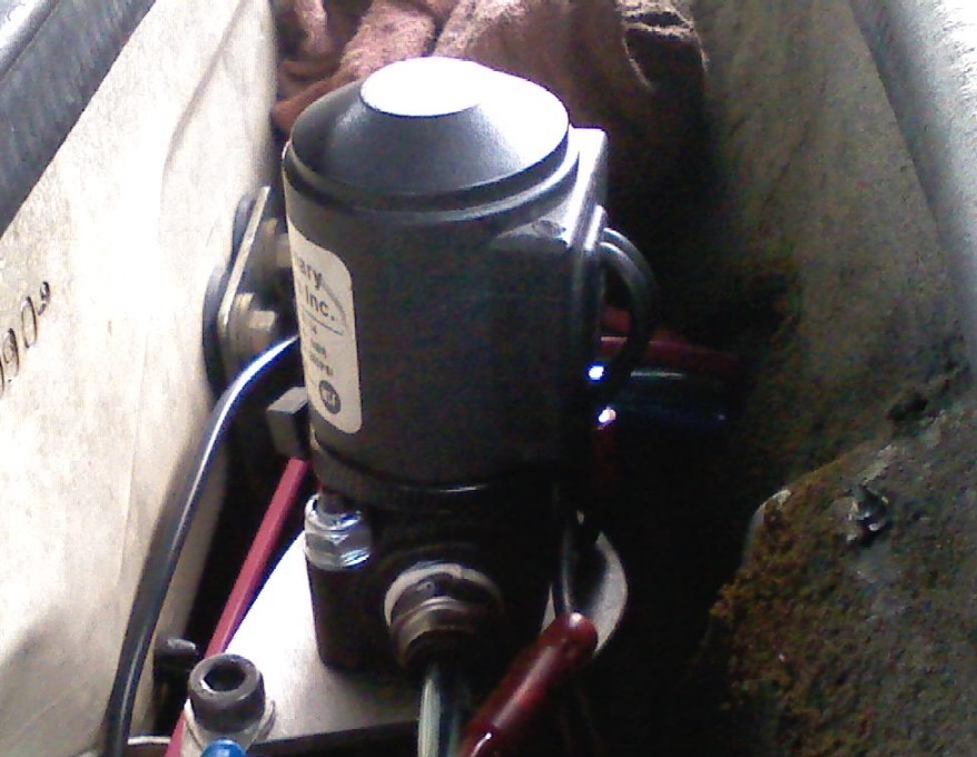

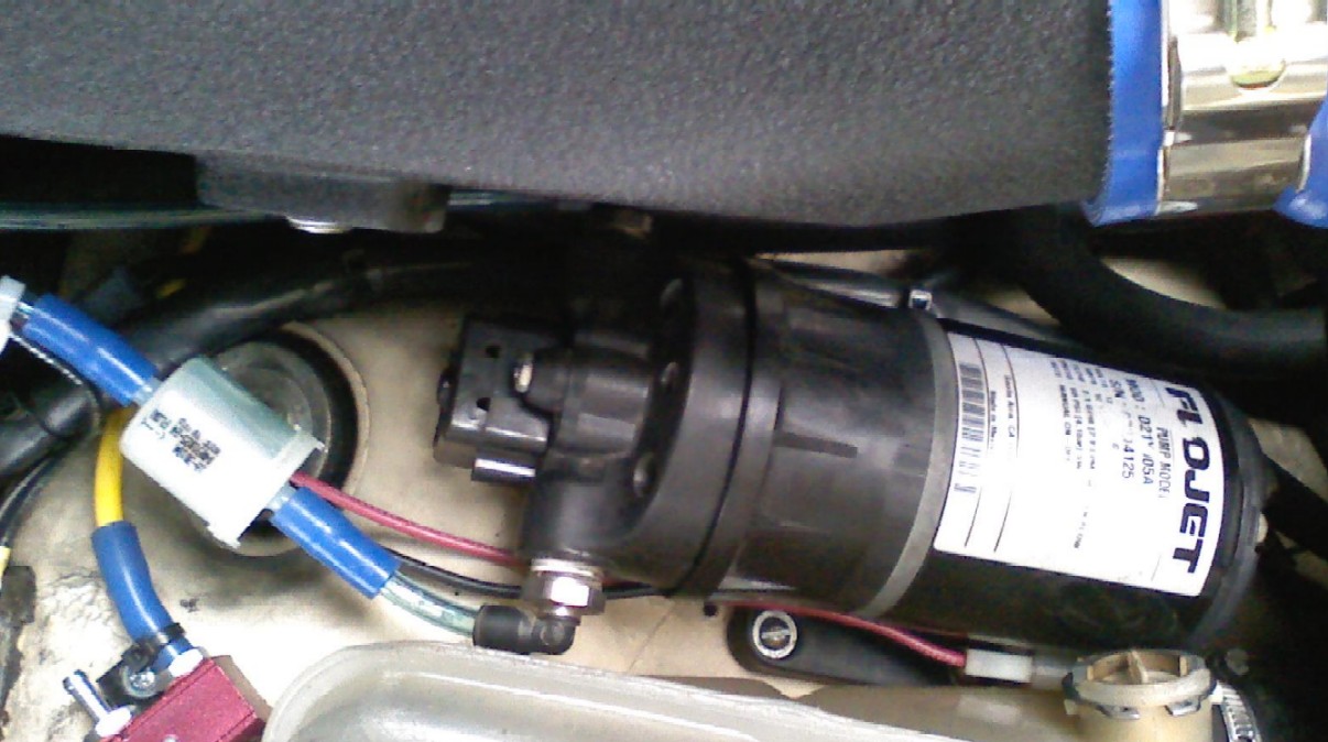

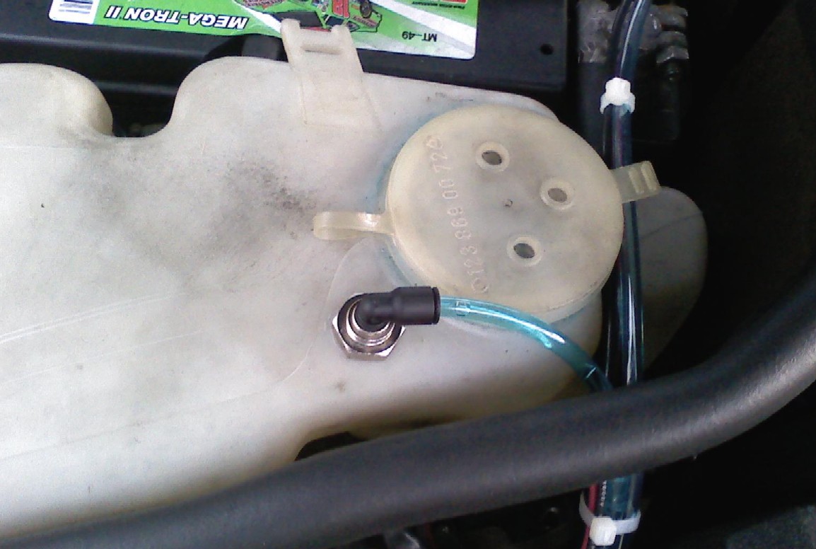

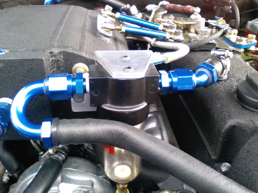

Finished the water injection today, going to test it tonight.
I also added a new breather/seperator inspired by FI.
Breather
Water tank pickup
Solenoid valve
Pump
Pressure switch

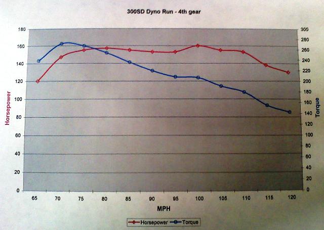

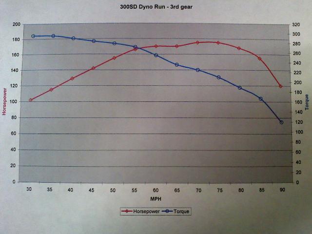

Quick update:
I went to the Dyno day yesterday, but with some mixed results.
I think I am having an issue with the head gasket, no oil contamination, but the coolant hoses are getting pressurized and it looks like I have some dark substance in the coolant tankSad It does not seem to have perceptable loss of power, seems the same as before. I also seem to be leaking from the heater core, I have a drip of coolant under the car near the transmission.
On the way to pick up my son the trans started to slip a bit in fourth gear...more on that later.
Got to the dyno shop and J-sauce was the first up. Dyno operator made acouple of pulls and he was only getting around 175 hp - runs were taken in 3rd gear. The operator made runs in 4th gear and his readings went up to 350+.
When it came time to my runs he could not figure out how to get an rpm output, I didn't know so I suggested to clamp on the tach cable, but that didn't work.Angry Where is the correct point to measure RPM output?
So he made a run in 3rd and was low on the output, so he said he needed to be in 4th. I told him put in D and go. He says is down shifted and wasn;t going to work. I told him to wait until 60-65 and floor it.
He made his run, it sounded mean and not much smoke. He said it got up to 120 MPH. My HP reading was only 171.xx - That does not seem right to me at all. It may have been the trans slipping or something else. It could be correct, but I have some doubts. I don't know if the operator completely pressed the accellerator or if some other factor played in the low reading.
I will post the printout tomorrow, the graph looks good though it climbs steady and plateaus and keeps straight until you let off the accellerator.
Disappointing day to say the leastSad

What where the TQ numbers?
RE: New Project - Skunkwerks EM9D - Rudolf_Diesel - 10-24-2010
(10-24-2010, 12:10 PM)willbhere4 What where the TQ numbers?
NO RPM = NO torque
RE: New Project - Skunkwerks EM9D - ForcedInduction - 10-24-2010
(10-23-2010, 12:07 AM)400Eric Credit payments will be subject to a 4% surcharge.
Thats illegal. California does not allow surcharges to be added to credit card transactions and Visa/mastercard does allow them in their business contract. Any of you that paid by credit card need to send them a written demand by certified mail to get your 4% returned!
http://fso.cpasitesolutions.com/premium/le/06_le_ic/fg/fg-merchants.html#MORE:B
http://law.onecle.com/california/civil/1748.1.html
Quote:Where is the correct point to measure RPM output?
They need to use an optical tachometer with reflective tape on the crankshaft (or on the P/S pully with a 1:0.9 underdrive ratio if they don't allow anything to be placed under/infront of the car).
Quote:I told him put in D and go. He says is down shifted and wasn;t going to work. I told him to wait until 60-65 and floor it.
You need to disconnect the bowden cable and kickdown switch. It will shift to 4th around 20mph and won't shift down unless speed drops.
171hp is still a lot better than anyone else. Smile
If you can post a hp:mph graph we can figure out RPM and torque. Either way, it sounds like you need to find a more experienced dyno shop.
I paid cash, but with the caveat that he told me if it didn't work then I would get a refund. Well, I guess he considered it a good pull, not my opinion. I think were also pissed off that my car puked coolant all over the floor, I forgot to tighten the radiator cap Blush
When I asked about the refund he handed me my run sheet...I didn't want to start some shit about the conversation prior to the dyno run so I said fuck it. Word of mouth spreads pretty fast.
The opitcal seems the way to go since I have done a little research...guess they don't do deisels and don't have the tooling.
The graph does show mph, but I don't think we will be able to do anything unless I knew at what position the throttle was at during the run - rpms would be different for me as my driving style would be different - just a thought, but I could be wrong.
Next time I will do the cable and the kick down switch. Is there an easy way to disconnect the switch? I haven't looked at it yet.

It's a shame you didn't have much success at the dyno... I can totally relate. My car is a real challenge because of the lack of space for the optical connector and a lack of a handy tach signal. It also downshifts like a big dog and is generally unruly.
In my mind, an unsatisfactory run that's lacking any of the standard parameters should be refunded but the operators don't think that way and will always fight to keep your money using any excuse they can. Not customer service related in the least...
After that bad dyno experience, I used my ocilloscope find a good tach signal for next time. Then, I ran a loop of wire outside the ECU box for easy access.

Here is the dyno sheet.
.pdf
Dyno Run 10-23-10.pdf

(10-25-2010, 09:24 PM)Rudolf_Diesel ...
(10-24-2010, 02:52 PM)ForcedInduction 171hp is still a lot better than anyone else. Smile
I am guessing that translates to about 200 horsepower at the flywheel. Agreed it is a lot better than everyone.
RE: New Project - Skunkwerks EM9D - JB3 - 10-26-2010
(10-26-2010, 02:38 PM)DeliveryValve I am guessing that translates to about 200 horsepower at the flywheel. Agreed it is a lot better than everyone.
I don't know what you guys are talking about, "im getting 45mpg at 80 mph in my stock 200 hp 81 mercedes diesel" Big Grin
If only performance was as easy as posting a craigslist add!
I agree, if thats 200hp at the flywheel with even a questionable dyno run, thats pretty damn good. Can't wait to hear the 2nd opinion run.
RE: New Project - Skunkwerks EM9D - Biohazard - 10-26-2010
Glad you got your money back from the dyno run! I still need to figure out an rpm source as well. I disconnect my kickdown switch and have the guy run it in 3rd. He goes up through the gears, then lets it back down to 1500ish rpm in 3rd and then goes for it. It took him a few tries to get it right, but it seems to work ok. He reads 3k on the tach in 3rd and holds it there to 'calibrate' it to the rpm vs wheel speed. The torque converter ratio throws it off, but it's better than nothing at this point.

RE: New Project - Skunkwerks EM9D - J-Sauce - 10-28-2010
Hey Rudolpho!
I took the liberty of rendering your dyno files for you. Feel free to edit my post if you dont want it up. Smile
[Image: RudolphDyno.png]
RE: New Project - Skunkwerks EM9D - Rudolf_Diesel - 10-28-2010
No problem...thank you.
The red graph is the first run in 3rd gear.
The blue graph is the second run in 4th gear when I told to wait until 60 mph to mash it and go. WOW! 118 mph at top speedBig Grin I wonder what rpms the motor was turning?
Even though the numbers are not what I expected and may not be accurate, the slope of the graph looks pretty good. Power goes up quickly and doesn't seem to drop dramatically until the accellerator is released.
RE: New Project - Skunkwerks EM9D - Biohazard - 10-28-2010
Oh man, I love that flat graph!! I wish mine looked like that! Haha! Going to have to look into rpm signals now for dyno runs...
If you really wanna get technical, you can figure out your RPMs using your gear ratios and tire size. It may not be completely 100% accurate because of the nature of rubber tires, but it will give you an idea!
RE: New Project - Skunkwerks EM9D - Rudolf_Diesel - 10-29-2010
(10-28-2010, 11:42 PM)J-Sauce If you really wanna get technical, you can figure out your RPMs using your gear ratios and tire size. It may not be completely 100% accurate because of the nature of rubber tires, but it will give you an idea!
If someone wants to do that kudos, my brain hurts right now and I don't relly feel up to itTongue If someone wants to figure it out , here is the data:
Tires: 205/70R14
R&P: 3.07
Trans: 722.315
I crunched a few numbers using some online calculators I found and came up with the following for torque curves:
RE: New Project - Skunkwerks EM9D - ConnClark - 10-29-2010
Why not just shoot a video of the instrument cluster driving in fourth at few different speeds. I'm sure the tach and the speedometer aren't 100% accurate but it will be close enough. The RPMs should scale linearly to the higher speeds.
