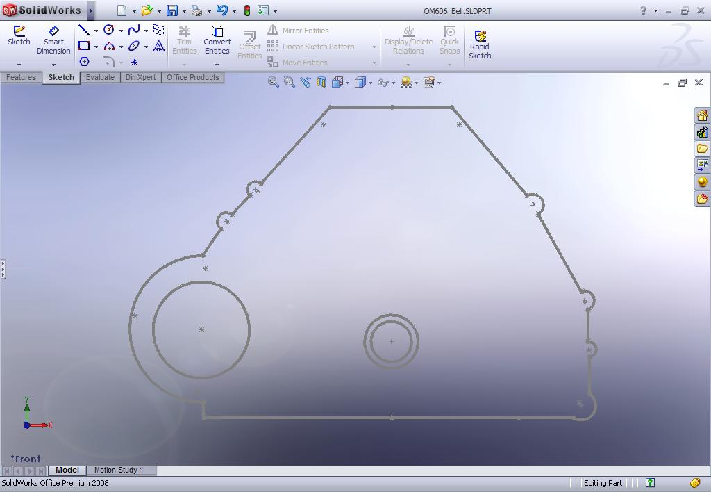

I have a rudimentary Solidworks sketch of the OM606 bellhousing pattern based on my junk "1.25L" OM606 block that I machined up - I only need help to finish the sketch and then find a machine shop to make and engineer the adapter plate. I *had* unrestricted access to a CNC bed mill (which I used as a makeshift CMM to get the point cloud data down to 0.0001" off the bellhousing...) - but not any longer.

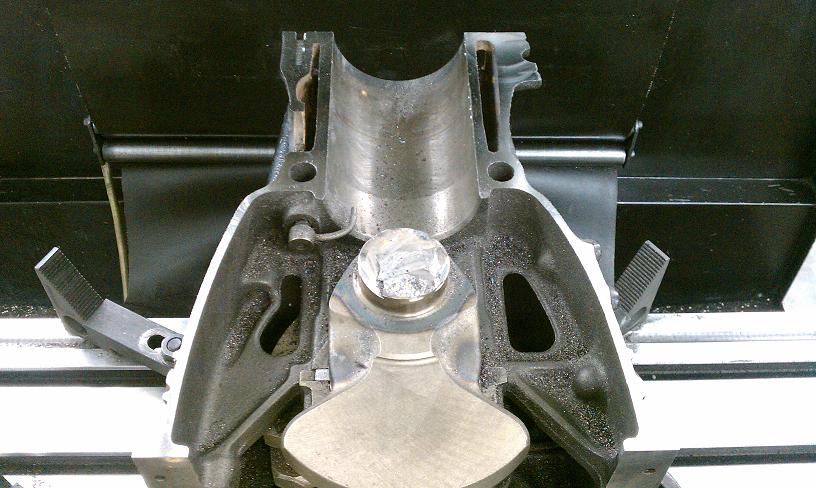

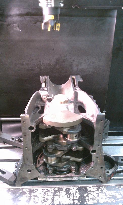

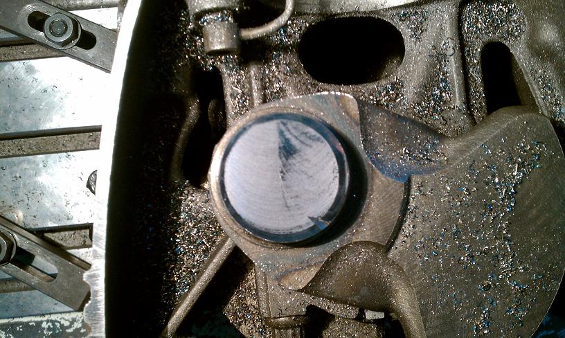

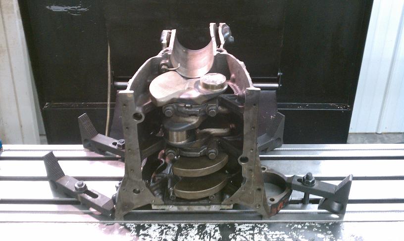

I will attach some pictures I took of the "1.25L" OM606 sitting on the mill. The guy I bought it from cut up the engine so I could save on shipping costs. After I milled this face flat and parallel to the bellhousing face, I affixed it to the mill's table on this milled face so that data points could be captured using the mill's control readout to within 0.0001".
Beers,
Matt
Here are some pictures...
This is how the block/crank arrived.
Machining in progress with Sandvik indexable shell mill.
Block machining completed, crankshaft machining not started yet.
Crankshaft machining completed - it was machined so that the journal's surface is below the machined surface on the block by 0.030" or so. You can see the depth of the rod journal heat treat...pretty neat stuff.

Attached is a screenshot of the OM606 bellhousing pattern I sketched in SolidWorks. I'm a complete newbie using this...so take it easy on me. Confused

(05-09-2011, 09:38 AM)HoleshotHolset I'm a complete newbie using this...so take it easy on me. Confused
In that case, always make sure that the sketch is fully defined.

(05-09-2011, 10:39 AM)Imaginos In that case, always make sure that the sketch is fully defined.
What do you mean by 'fully defined'?

(05-09-2011, 10:59 AM)HoleshotHolset What do you mean by 'fully defined'?
That all the lines of the sketch are black, not blue. That means all the lines are defined by dimension and location. For example, if you draw a rectangle, and define dimensions of a vertical and horizontal edges, you still have to define its location in relation to the centre of coordinate system. Hope that makes sense?
Fully defined sketch is important later on if you move to more advanced stuff in SW, not only will it work faster, but chances of getting weird errors when doing something are significantly decreased.

(05-09-2011, 01:42 PM)Imaginos For example, if you draw a rectangle, and define dimensions of a vertical and horizontal edges, you still have to define its location in relation to the centre of coordinate system.
OK - that does make sense.
All points were placed on the sketch with relation to the origin. In this case, the origin I used was the imaginary center of the crankshaft main journal...this seemed to be the most logical choice. The lines and arcs that I drew on the sketch were just made between the points. When I had the block on the CNC bed mill, by using a dial indicator or an edge finder, I read and stored the X, Y, Z location from the control to within 0.0001".
Thanks for your help!
Quote:I'm a complete newbie using this...so take it easy on me. Confused
NO!!! Trial by fire is always best!!!
I hate to break it to ya but you could have probably sketched that up without having to sweep anything in on the CNC. That's the beauty of sketching in Solidworks or any other parametric modeling software with strong sketching ability. You could have doweled or put a bolt in every threaded hole and taken multiple measurements across them from one to the other(s) with a caliper or depth mic off the flat surfaces (pan gasket surface). But, to make you feel better, doing what you did was more accurate and easier. All I'm saying is you could have done it with an engine in the car and not had to use the cut up engine. It's especially easier when you start sketching it up and can conclude many of the bolt holes are on a bolt pattern or a nominal distance from the crank centerline for example. In that case sweeping them all in isn't necessarily more accurate. I did a billet bellhousing for a 2-71 Detroit Diesel this way and also the head bolt pattern on a large 4 cylinder block that's too big for our CNC's.
I've got 20+ years experience with CAD/CAM/CNC in the mold building industry. Where are you located in WI? I'm in the Twin Cities suburbs. I might be able to help you if you're interested. I was gonna stay with an auto in my W123 617 but am leaning more towards a 5 speed now so it's something I'm going to tackle sooner or later.
Here's some pics of the Detroit Diesel bellhousing I made:
[Image: 3108848029_49cd065d66.jpg]
[Image: 2465833961_bedc40178b.jpg]
[Image: 3108840995_1915bfd1d4.jpg]
