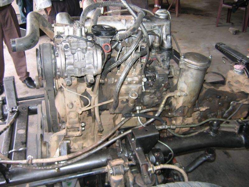

Thanks: Wondering how in India they are producing the OM616 in turbo. Low boost or did they do extensive mods?
01-31-2011 08:16 PM

(01-31-2011 08:16 PM)DieselSchlepper Wrote:  Thanks: Wondering how in India they are producing the OM616 in turbo. Low boost or did they do extensive mods?
Force Motors (Tempo) basically made a 617a - 1 cylinder after they licensed MB's design. Even the transmission is a licensed MB clone. 90hp was factory.

whats the air filter setup on that motor. i can't see it. Oil bath?

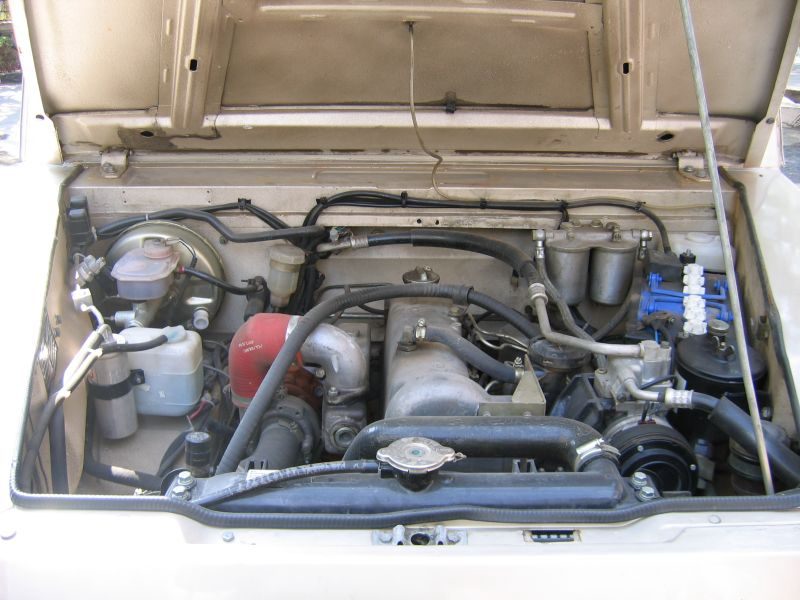

Man, those force motors vehicles seem really cool. They don't just copy the MB engines- but the chassis too.
Traveller aka sprinter:
[Image: traveller_3050.jpg]
Trax aka G-wagen:
[Image: gurkha4wd.jpg]
Supposedly they now have a direct injected engine based off the OM616. I wonder if the head and pistons could be used on a regular 616 to convert to direct injection?
