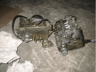

I want to find the Audi 5cyl rotary pump. Plenty of upgrades for that line. and from what I have seen it has the same driveinterface.

(07-01-2009, 09:28 PM)winmutt I want to find the Audi 5cyl rotary pump. Plenty of upgrades for that line. and from what I have seen it has the same driveinterface.
Is the Audi pump for a diesel or do the bosch mechanical F/I pumps work the same way as diesel I/P's do, who has the best pumps so far?

Diesel Audi 5 cylinder. Pretty rare here.

07-04-2009, 10:19 AM #5
Will it clear the block? What do the splines look like?

07-04-2009, 11:09 AM #6
It looks like it is cog belt driven, it would not be a bad install. What is the fuel volume potiential, last question how much?

07-04-2009, 02:02 PM #7
(07-04-2009, 11:09 AM)Motorhead It looks like it is cog belt driven, it would not be a bad install.
Ah, I see now. Runs right off the timing belt. Sure, won't be a bad install as long as it clears the damn block on the back side. Could make a spacer to ensure that it clears the lip on the bottom, as long as it doesn't interfere with the oil cooler lines.. I guess you could give it its own cog and belt and hang it out from the block if it doesn't fit. Simple 2-bearing block, ball bearings, and an oil seal, run the IP oil return straight to the oil pan. Things are pretty tight around the IP on the 617.

07-04-2009, 03:09 PM #8
All you have to do is put the spline snout on the shaft and bolt it up. I dislike rotary pumps though, I wouldn't do it.

07-05-2009, 08:59 AM #16
(07-05-2009, 08:49 AM)dalek I just thought someone would want to see the Audi pump; if that was seen as stepping on people's heads...
Not in the least. Please post more detailed pictures if you have them, I would like to see the idea progress rather than die in the middle of a thread. This place is all about learning from each other's adventures.

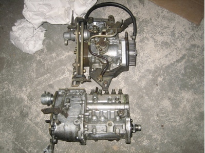

07-06-2009, 01:22 PM #19
The drive is a tapered 17mm OD shaft and a respective woodruff key with the drive pulley held in place with a nut. The flange is a similar 3 bolt style to the inline pump. A machine shop might be able to help spline the driveshaft provided there is material that could be removed.
Alternately, a Gilmer belt sprocket could be salvaged as a bushing with splines machined into it, so the 617 sprocket would fit. I am not sure of the ID of the 617 sprocket, however.
The audi based pump can be fitted with a 12mm diameter plunger/head from stock bosch parts, and there are custom 14mm diameter plungers available as well. With a suitable cam plate, the pump will yield about 75% more fuel compared to the stock plunger ( I last recall it is 10mm in diameter ) and well over 100%
with the 12mm and 14mm plungers respectively.
Many cam plates are available too, and the stock cam plate is very benign. A higher lift cam plate gives more fuel as well, so a combination of a larger diameter plunger and the cam plate is what you would want.
The 617's timing advance would need to be disabled, or retain it, and keep the inline pump's sprocket timing advance fixed. I would consider trying the latter, which allows you to tune the timing via the VE pump.
Stronger plunger springs can be fitted to keep cam plate float in check for over 6K rpm operation easily. Indeed, no oil feed is needed for the VE type pumps.

07-06-2009, 01:58 PM #20
Interesting the audi pump I saw had the same as the inline pumps.

07-06-2009, 06:03 PM #22
(07-06-2009, 05:53 PM)Motorhead So there is a timing advance in the 617 pumps, how much and at what rpm?
7.5* advance via the timing device (the sprocket the chain drives and the vacuum pump rides on). At what RPM and under what conditions it advances, I don't know.
