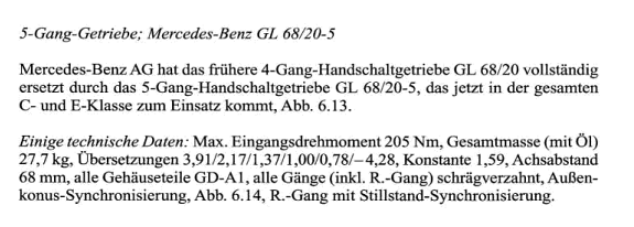

10-11-2012, 10:24 PM #67
According to this the 68/20-5 is only rated for 205NM
