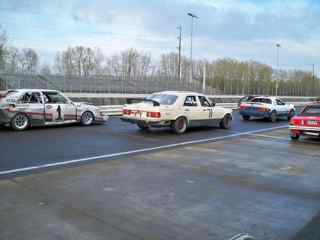

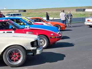

I still wonder where are the pictures of this racecar.

Here are a few pics from grid at our first race and pre-grid at our second (which we won class in). You can find LOTS of pictures on our facebook page: Dirty Little Freaks Racing
