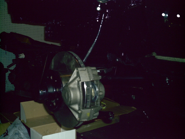

I posted these on benzworld awhile back, but I figured I'd post them here for anyone who didn't see them. The late w126 brakes are noticeably larger(I did a quick search for dimensions,but no luck and little time) and do bolt right on to the w123 spindles. There had been a lot of talk about the compatibility, but I couldn't find anybody who had actually done it.So I just bought all the stuff and bolted it on.You would need calipers, rotors and backing plates(and wheels to clear them of course. I ordered mine for 1991 560 sec.W123 brake hoses work fine.This baby is still under construction so I can't tell you how much better they are than stock.My only other recent concern is the ability for the w123 master cylinder to push the extra volume.The w126 has a different master cylinder,so that may be an option.I'll let you guys know what I end up doing.This is the never ending project and has to be put on hold for a few months,but here are the brake pics. OK, heres one, the rest are 150kb and my photo editor just froze up :evil: maybe tomorrow.

04-14-2008, 09:44 PM #6
I use the late W126 15" wheels so I know the brakes will fit.
No problems with tire wear or bearings so I bet the offset is not an issue.
winmutt You should spend the extra few bucks and put the r107 calipers on there.
Do those bolt on as well? 4 piston calipers would be very nice. Big Grin
[Image: N104026736ATE.JPG]

04-21-2009, 07:31 PM #23
I've got all the big parts from an 87 420SEL to do a GenII "Big Brake" upgrade. I only need to order wheel seals and brake hoses.
The GenII is 300mm outside diameter vs GenI's 278mm. The 22mm difference is mostly in pad surface area.
Will the entire hub bolt on or should I transfer the rotor to my existing hub?

06-14-2009, 06:12 PM #26
Today I got a set of nearly new rotors, hubs and calipers from a 1990 420SEL for $76.
I'm not sure if I want to keep the other set and put it on the 240 or sell the good calipers for funds towards the 300's toys. If anyone wants the calipers, make an offer.
06-15-2009, 04:54 AM #27
I just finished the install of mine today... 1989 420SEL spindles, powdercoated 'performance gold', good condition rotors, new calipers... I did run into a problem though: after taking out the grease seals and banging out the bearing races, I realized my new bearing/seal kits were for the wrong size...(smaller) maybe different because of the ABS? (the tone ring limiting the size of the bearing and seal set?)... only thing I can think of... luckily, my 123 hubs and seals/bearings were still in good shape so I swapped them over to the larger vented rotors...
heres what I noticed:
spindles are totally interchangeable between 123 and 126... with the late 126 spindles and hubs you have the option of upgrading to ABS (I have some old sensors installed to plug the holes on mine..will do a full upgrade at a later date)
the 123 solid rotors are ~11" diameter
the early 126 vented rotors are ~11" (I think)
the late 126 vented rotors are ~12"
apparently all of the differences are in the calipers (and hubs/spindles for ABS as mentioned above)
ill prolly think of more in the morning after I get a few hours of 'rest'
also installed my vogtlands, 16" rims (and 225/50 series tires) and full suspension rebuild this weekend... still havent gotten the rear subframe mounts to seat all the way...anyone know a trick?

03-04-2011, 12:57 AM #41
i'm going to be putting the gen 2 w126 fronts on my 240D. got the calipers from the junkyard for $17 each! going to rebuild them and use new rotors.
in case anyone is interested here is a photo. top caliper is gen 2 w126, bottom is w123 ('81 240D).
edit: i think i made a flub. 15" wheels required in order to clear the gen 2 fronts? PISS. i guess i'll just try bolting the caliper on to see what the deal is. Sad
[Image: IMG_20110303_173007.jpg]
This post was last modified: 03-04-2011, 01:06 AM by stan.

03-04-2011, 10:12 AM #42
Yes 15" wheels are required.
