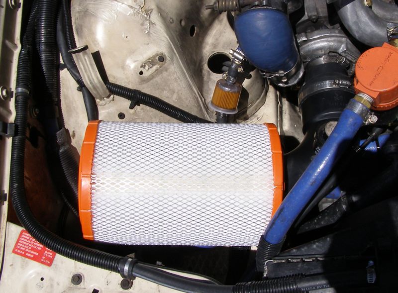

04-25-2010, 07:06 AM #2
Please don't post your phone number or e-mail on any forum (not just here). It makes easy farming for spammers and malicious individuals.
This is what I'm currently using.
http://www.framcatalog.com/PartDetailWin...&pn=CA8038
It has 4" ABS pipe with a 4-2.5" reducer for the turbo inlet for minimal air velocity. It lasts 1-2 years before reaching 15"H2O restriction and it will fit the stock engine with A/C.

04-29-2010, 05:55 AM #6
The 4-2.5 filter reducer is a home depot rubber plumbing reducer.
Basically this: http://www.homedepot.com/Building-Materi...ogId=10053
The 2-3 90* elbow from the turbo to intercooler is generic from ebay.
Here is a better picture from today.

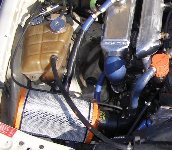

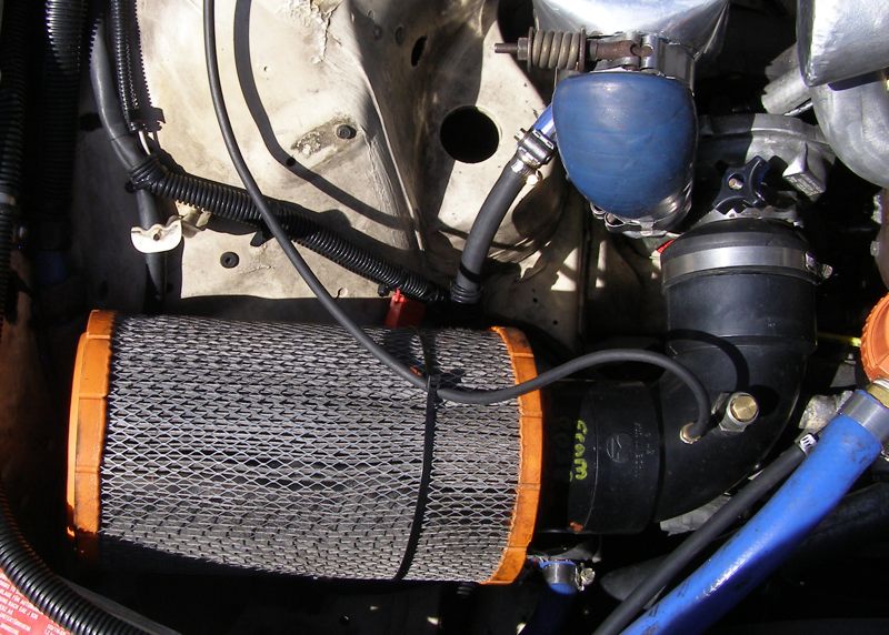

05-16-2010, 04:06 PM #10
I moved the old 8038 filter system to the 240 and built a new one for the 300. Its basically the same setup except I used an 8037 filter, a long radius tube, mounted the filter further from the fender to prevent it rubbing the IC hose and mounted the restriction gauge directly to the elbow. CCV is vented to the atmosphere, no oil to foul the turbo or intercooler!
The 37 has a 3.63" mouth instead of 3.59". Its not much difference, but its just barely enough for it to fit tightly over the 4" end of the ABS pipe without modification. Its the same length but 7.25" diameter instead of 6.5".
Cost
3" of straight ABS tube and ABS cement leftover from other filter system- about $9
ABS elbow- $4.91
Flex coupler- $6.52
Fram 8037- $19.99 (autozone)
Total: About $48 after tax.
I'm going to get a 2.5"-3.5" silicone reducer to replace the rubber sewer adapter. The rubber pipe works fine, but its a bit too flexible for my desire and too thick to mount flush on the 2256's mouth.

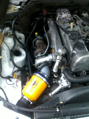

05-17-2010, 10:52 AM #12
Ooo what kind of air box is that? Stock GD? Looks like it takes it feed from the front?

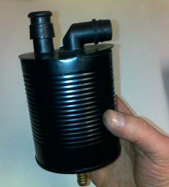

01-06-2012, 10:58 AM #17
Euroguys can go easily with setup of mine
in basics it is Italy based company that produces
those filters in metal housing so it is easy to avoid heat.
sprintfilter is the name. I have used 80/70mm.
with used tubing/seals from old filter housing.... it seats perfectly.
I made oil separator from original ... but in due bad weather
did not manage to plug it ...yet Big Grin
