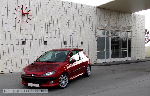

This is the car (never mind the photoshoppin'..)

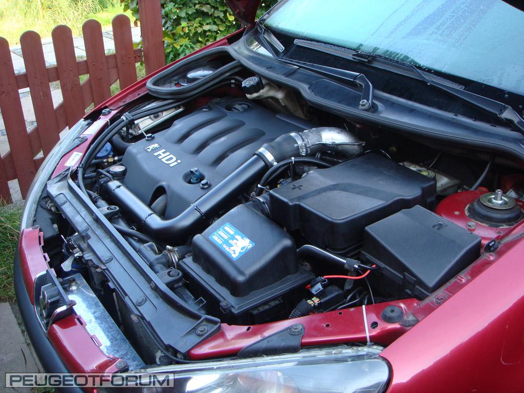

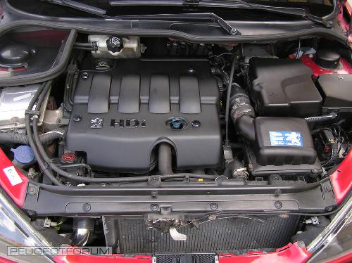

This is what the enginebay looks like std.

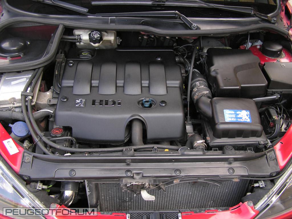

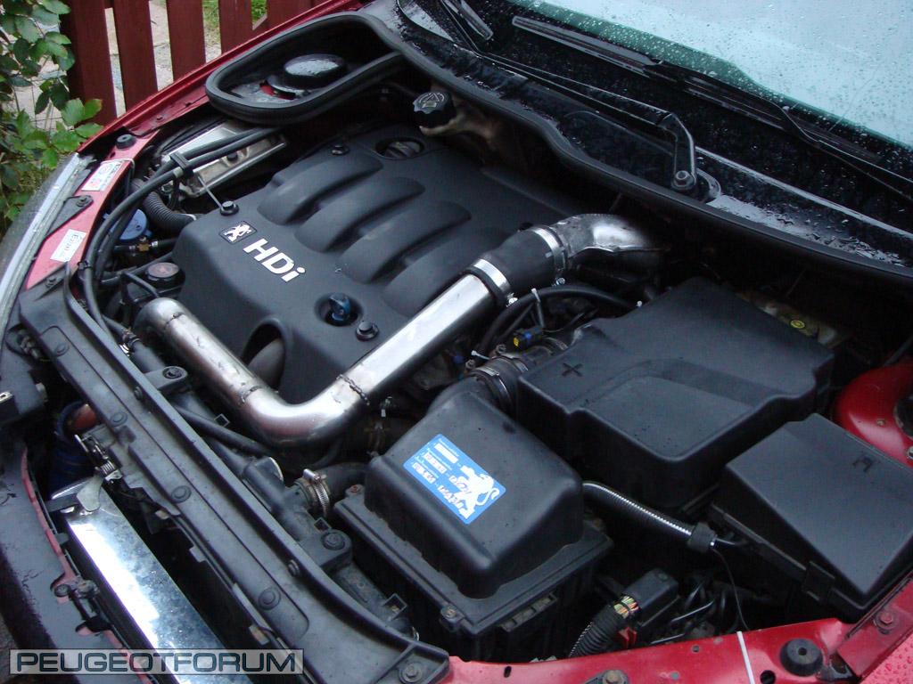

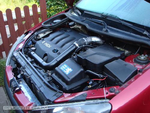

This is what it looks like one an intercooler has been fitted.
[Image: ?rsz=1&id=552&db=.jpg]
..but much better, almost factory looking once the boostpipes are painted black.
[Image: ?rsz=1&id=561&db=.jpg]

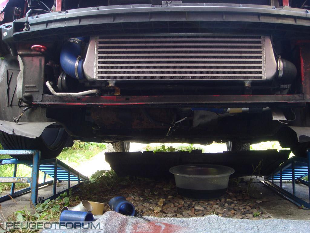

The intercooler sits behind the std. bumper and grille.

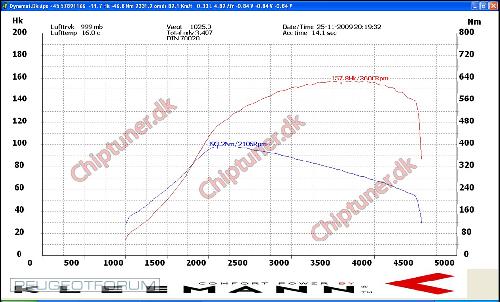

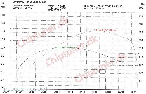

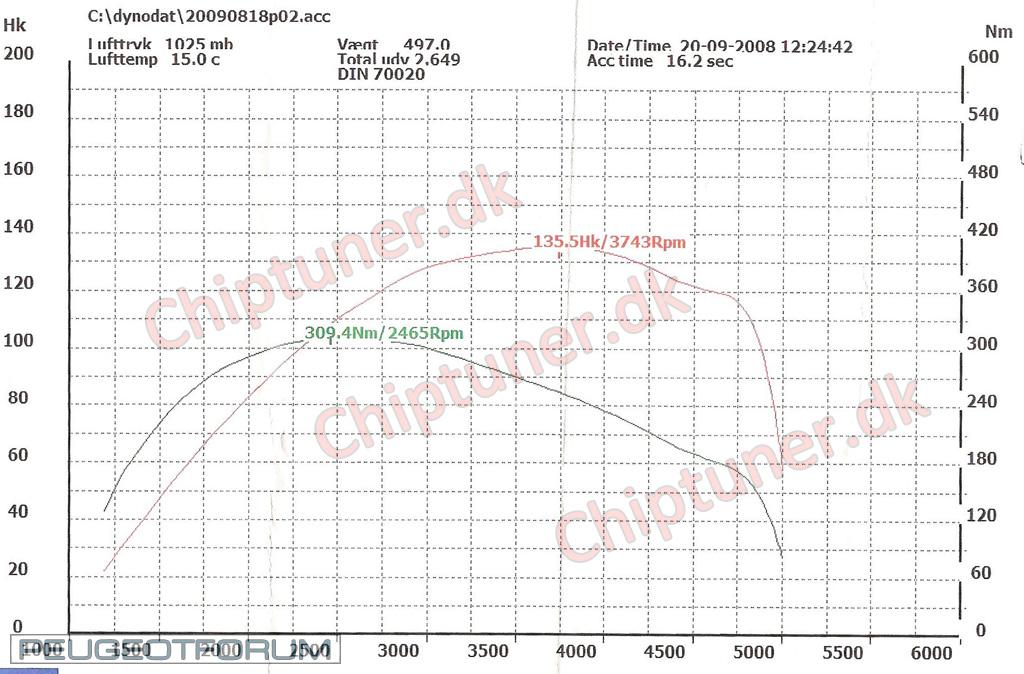

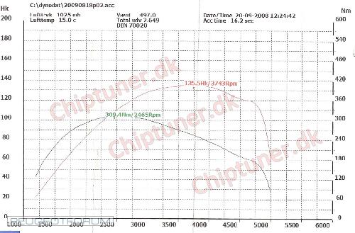

This is one of my very first files:
[Image: ?rsz=1&id=1907&db=.jpg]

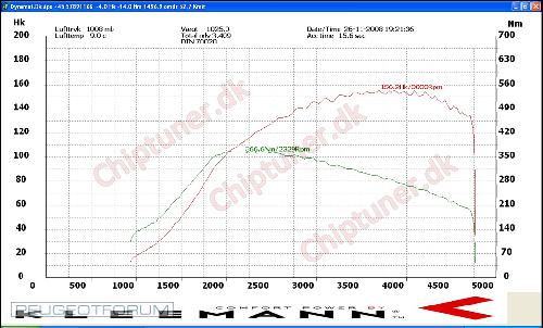

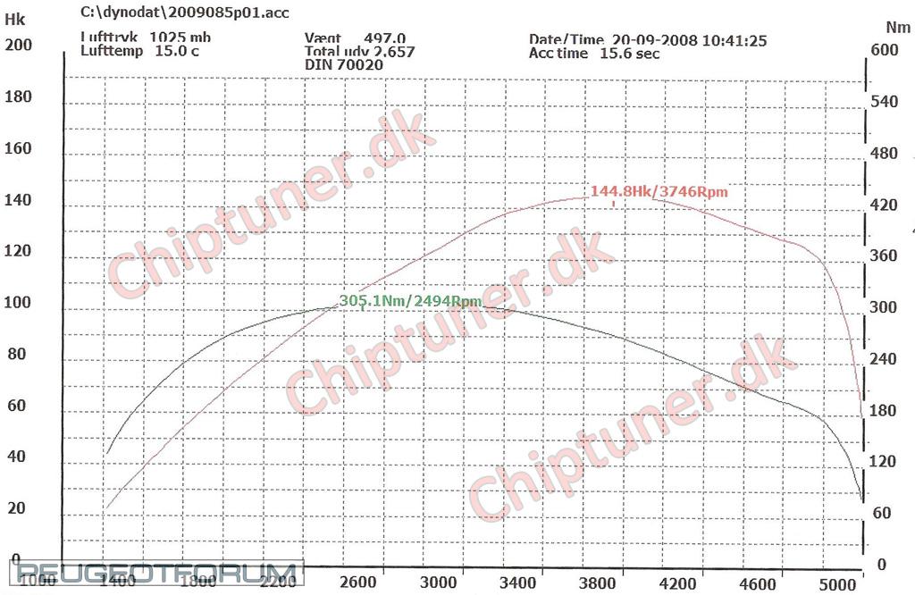

Then I adjusted it a bit:
[Image: ?rsz=1&id=1908&db=.jpg]

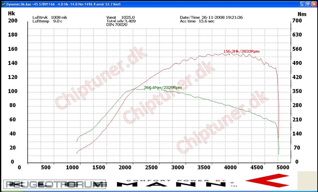

This file I drove with for quite a bit, but then it was time to experiemtn with some new files and I got this:
[Image: ?rsz=1&id=1909&db=.jpg]
It drove absolutely fantastic with this, but more wants more..

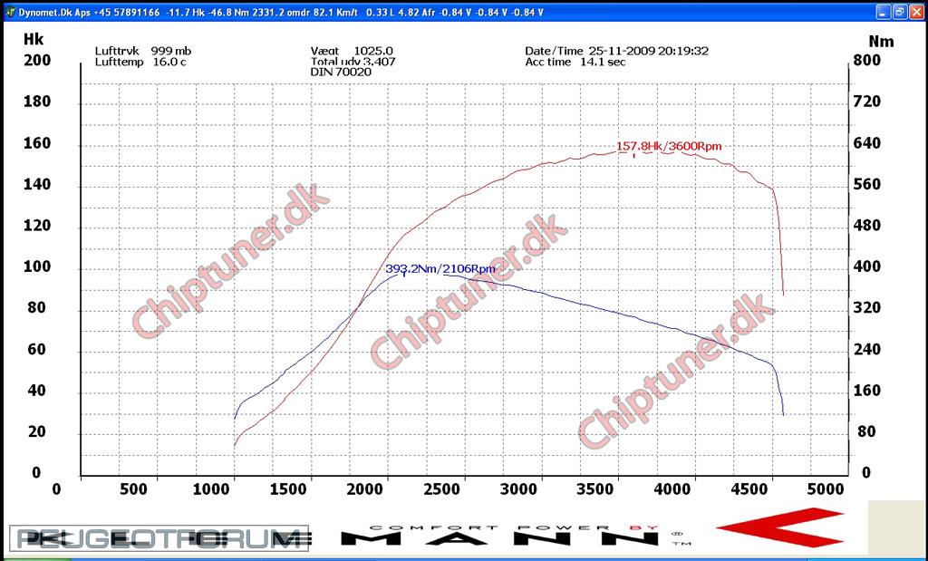

I uprated the fuelpressure sensor with a 1800bar sensor and made some new files for it. This is as much as it will give without smoking too badly, now the limiting factor is the turbo..
(this is on winter diesel, on summer diesel it produces 165BHp and 398M.)
