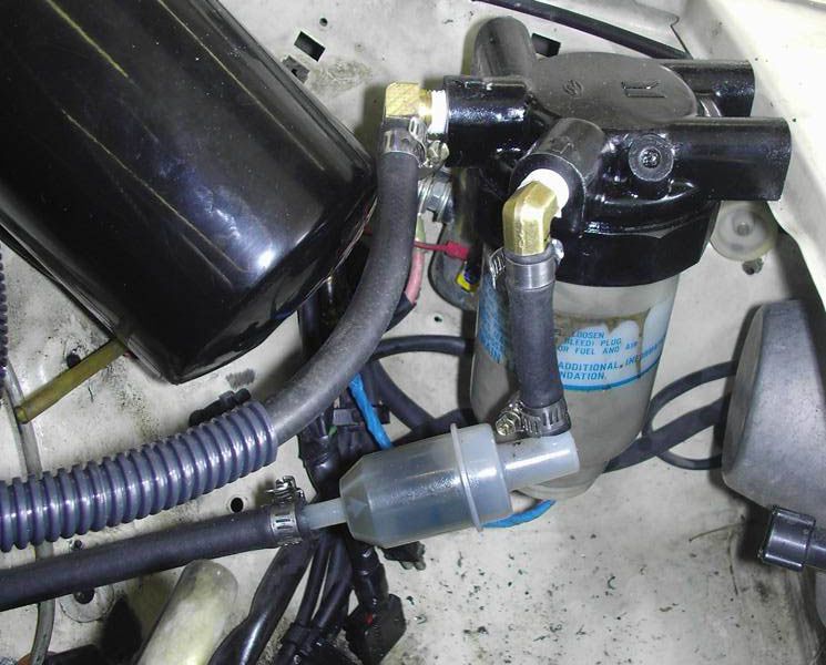

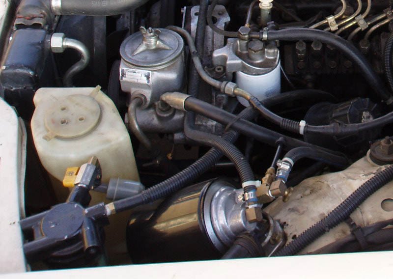

I got one from a 1999 Isuzu NPR that includes a level switch. Installation is simple.
*Find a place to install it where it will be vertical.
*Run a line from the tank suction tube to the separator.
*Install the primary filter on the inlet side of the separator.
*Run the outlet side to the inlet side of the primer/lift pump.
*Wire your level switch to a light or buzzer (I connected mine to brake pad wear light/harness).
Thats it! I have yet to get any significant water thanks to the reputable station I buy my Diesel from, but if I were to get some the pad wear light will come on to notify me. At that point all I have to do is drain the separator until the water is gone.

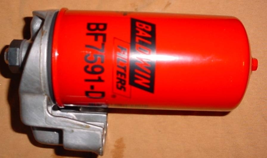

02-15-2009, 05:11 AM #10
It's a baldwin BF7591-D. To get it to fit the stock filter head you have to tap the filter head for a 16x1.5 thread and make your own 16x1.5 banjo bolt. I may start selling them If I can get some more filter heads.

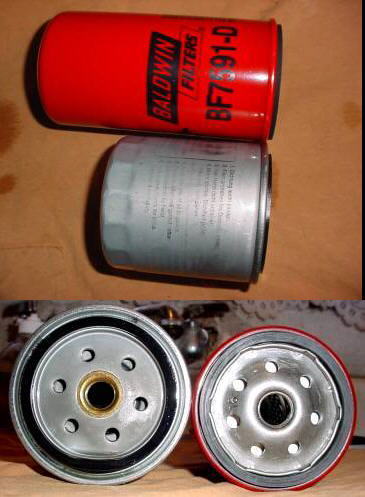

03-04-2009, 04:11 AM #13
Thats why some of us modified the filter base to use a Baldwin BF7591-D filter.

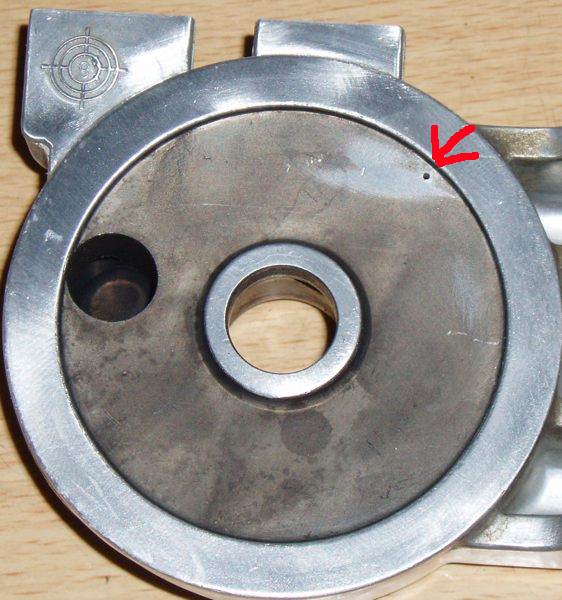

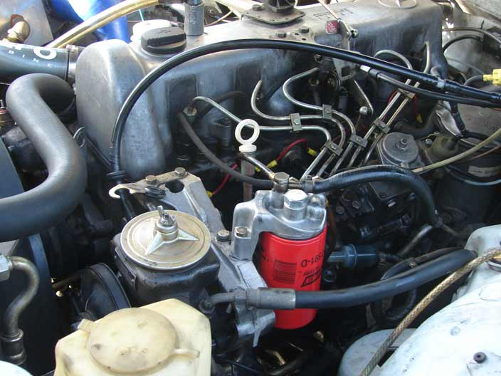

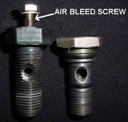

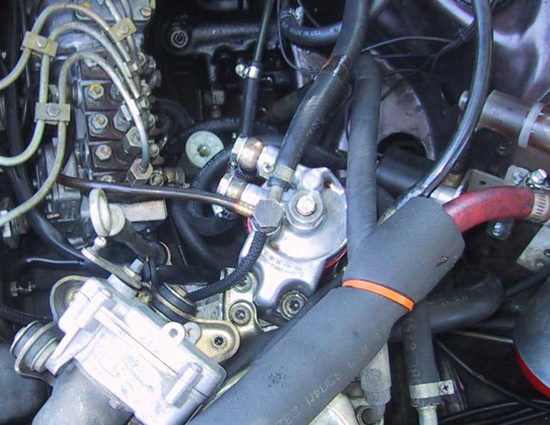

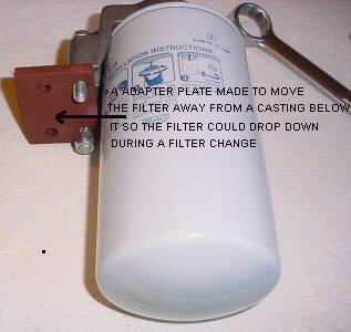

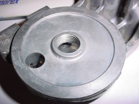

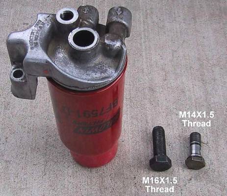

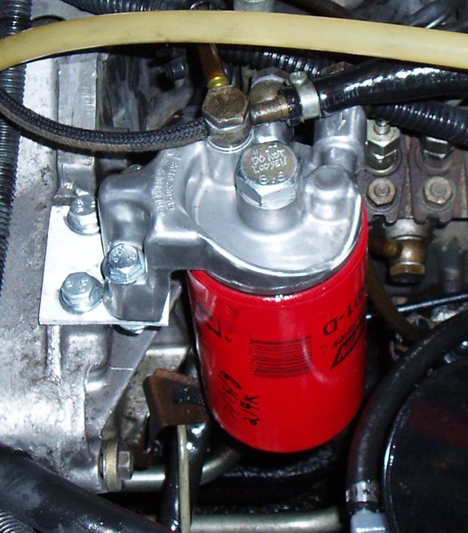

03-04-2009, 01:11 PM #15
The stock filter head uses a 14mm x1.5 treaded banjo bolt to attach to the filter head. The Baldwin BF7591-D needs a 16mm x1.5 treaded banjo bolt.
The attached pictures are from Myself and M-Shop member Diesel911 who gave me his blessing to post these pics on other forums when we first did this.
In order to use it you will have to modify the filter head to accept the larger diameter 16mm x1.5 banjo bolt. I had the filther head treaded to the 16mm x 1.5 thread. This in turn will effectively lock the bolt in place and the filter will now be spin on type. No need to loosen the bolt when changing out filters. Some use Locktite to seal the threads. I just used an O-Ring between the filter and head.
Unfortunately, there is no readily available 16mm x1.5 banjo bolt that is long enough to clear the filter head to read the filter. So you will have to create a banjo from a regular bolt. Diesel911 created this banjo for me. He added a bleed screw by mistake. But it actually is a good mistake to have.
As installed on the filter head.
The other thing you’ll neeed to do is the Baldwin filter is taller then the stock Mercedes filter. The web casting of the Powersteering mount gets in the way of a taller filter. You’ll need to devise an extension to move the filter head outward so the the taller fitler can clear the web casting.
In my set up, I clocked the filter head to a 1 o’Clock position to clear the web casting.
Like bgkast's as posted earlier.
[Image: attachment.php?aid=394]
Other's have made an adapter that moves it outward and keep the same orientation.
Like Force's as posted eariler.
[Image: attachment.php?aid=442]

03-05-2009, 05:12 AM #16
The bleed screw isn't really needed. There is already a hole in the base that bleeds air in the filter to the return line.

Any long term report on this Baldwin Mod? For my car, it's acting the same.. Normal..
06-28-2010, 11:52 PM #28
06-29-2010, 12:11 AM #29
No problems with mine. 7500 miles on the 240's when I changed it with the engine oil and 6500 miles currently on the 300's.
06-29-2010, 12:36 AM #30
Forced, In your second picture, post 1, what is the other (filter???) on the inner fender well?
06-29-2010, 12:50 AM #31
An Amsoil bypass oil filter.
06-29-2010, 12:52 AM #32
Ahhh cool. I also see the updated link at the top... Thanks!
